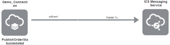

Create an Integration
Here's the integration you create:
integration that monitors business events.
Create an integration that monitors business events.

  5. On the page that displays, you will identify the source of the connection that provides the details. For this example, in the search window, enter Connection_for_Order_Status_Update, which is the integration that you created earlier, then click ENTER.
    The test you did earlier for the connection you created must finish successfully. If it doesn't, then the search won't return the connection.
  6. Drag and drop Connection_for_Order_Status_Update from the search results onto the Drag and Drop a Trigger area.
  7. In the Configure Oracle ERP Cloud Endpoint dialog, specify the events and scenarios for the ERP Cloud connection. Set the values, then click Next:
    Attribute
    Value
    What do you want to call your endpoint?
    Describe the endpoint. For example, enter PublishOrderStatusUpdated.
    What does this endpoint do?
    Describe the connection. For example, enter Publish the OrderStatusUpdated event.
  8. Select the With Business Events option.
    Integration Cloud Service uses the URLs you set up earlier to get the event catalog, and then display it in the Business Event for Subscription list. This list helps you select from the events that are available in Oracle ERP Cloud.
  9. In the Business Event for Subscription list, enter Order, then click Sales Order Notification > Next.
  10. On the Configure the Response to Send to the Oracle ERP Cloud Application page, note that Integration Cloud Service only listens for events in this integration, then sends them to subscribers without replying to Order Management. So, click None > Next.
  11. On the Summary page, click Done.

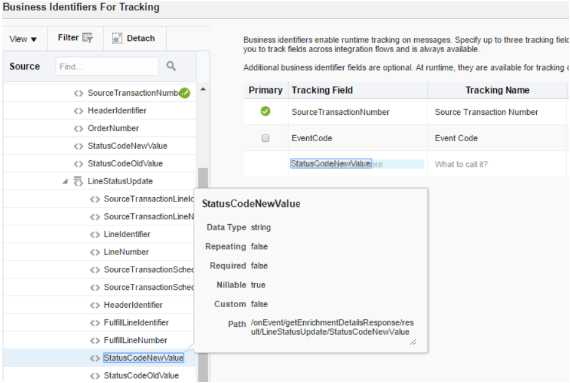

Track Business Events
Track business events so you can test and monitor your integration. Track at least one business event so you can monitor your deployment during normal operations.
  1. On the page that displays, click Tracking.
    Use Tracking to test your set up. You can view the business events that your integration uses in Integration Cloud Service's monitoring system.
  2. For this example, on the Business Identifiers for Tracking page, in the Source tree, under the result branch, click Load More.
    Here are the business identifiers you will track:
    business identifiers you select to track.
  3. Drag and drop SourceTransactionNumber from the hierarchy tree to the first row of the Tracking Field column.
  4. Drag and drop Event from the hierarchy tree to the second row of the Tracking Field column.
  5. In the result branch, expand LineStatusUpdate, then click Load More.
  6. Drag and drop StatusCodeNewValue from the hierarchy tree to the third row of the Tracking Field column.
  7. Click Done.
  8. On the page that displays, click Save > Exit Integration.

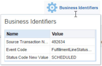

Test Your Set Up
  1. Sign into Order Management, create a sales order, add one order line, use the Shipment Details tab to set the Requested Date to a time that happens in the future, then click Submit.
  2. In the Confirmation dialog, make a note of the order number that displays, such as 492634, then click OK.
    The shipment step of the orchestration process runs, sets the Status to scheduled, then displays the status on the order line. This shipment step uses the business event that you specified earlier. You must have already set up this orchestration process and finished other setup in Order Management.
  3. Navigate back to Integration Cloud Service, then click Monitoring.
  4. On the Integrations Dashboard, click Tracking, then click anywhere in the Messages area.
  5. In the search window, enter the order number you noted earlier, such as 492634, then click ENTER.
  6. In the search results, notice that Order Management used more than one event for the sales order. Click the event at the top of the list, which is the most recent event.
  7. On the page that displays, click Business Identifiers, then verify that the tracking details you set up for tracking earlier displays.
    Here are the details you set up in this example:
    • SourceTransactionNumber. Identifies the order number.
    • Event. Identifies the business event that gets triggered, which is FulfillmentLineStatusUpdate.
    • StatusCodeNewValue. Identifies the new status value of the order line, which is Scheduled.
    For example:
    Identifies the new status value of .
