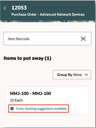

- In the Inventory Management mobile work area, click Put Away Goods task.
- Select the organization and click Continue.
- Select Put Away By as Receipt or Item.
- Enter or scan the receipt or item number, and then click Continue.

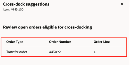

- Click the Cross-docking suggestions available link to
instantly view the cross-dock suggestions and do as necessary.
