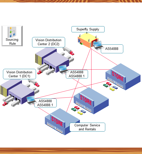

Assume you sell the AS54888 Computer. You're releasing a new version of it, AS54888.1 to all your customers, but you want to make sure your highest valued customer, Computer Service and Rentals, gets first dibs on it.
Here's your supply chain.
      Note
- You are in the Vision Operations organization.
- You fulfill all computers that you have in the Computers category from:
            - Vision Distribution Center 1 (DC1)
- Vision Distribution Center 2 (DC2)
- Superfly Supply (S1)
You will create one sourcing rule to meet this need:
- You fulfill the AS54888.1 only from Distribution Center 1 and Distribution Center 2.
You will create a second sourcing rule to meet this need:
- You fulfill sales orders from Computer Service and Rentals that have the AS54888.1 only from Distribution Center 1.
- You fulfill all items that are in the Computers category from Distribution Center 1, Distribution Center 2, or Superfly.
So you need to implement this set up.
| Sourcing Rule | Item Category | Item | Fulfillment Source |
| 1 | Computers | - | Vision Distribution Center 1 (DC1) Vision Distribution Center 2 (DC2) Superfly Supply (S1) |
| 2 | - | AS54888.1 | Vision Distribution Center 1 (DC1) Vision Distribution Center 2 (DC2) |
| 3 | - | AS54888.1 | Vision Distribution Center 1 (DC1) |

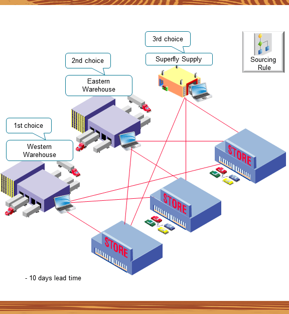

Another Example of Creating an Assignment Set
Create an assignment set that Promising can use when your first choice for supply can't fulfill the demand.
Consider this supply chain.
      Assume:
- You're in the Vision Operations organization.
- You sell the AS54888 Computer item, and its in the Vision Pro category of computers.
- The Western Warehouse and the Eastern Warehouse are each an organization in Vision Corporation.
- You want to ship from Western first.
- If Western can't fulfill demand in time to meet the requested delivery date, then ship from Eastern.
- If Eastern can't fulfill demand in time to meet the requested delivery date, then use Superfly Supply to fulfill demand. Superfly is your 3rd party supplier. You use the acronym SFS to identify the Superfly organization.
- You need 10 days lead time to fulfill the item.
