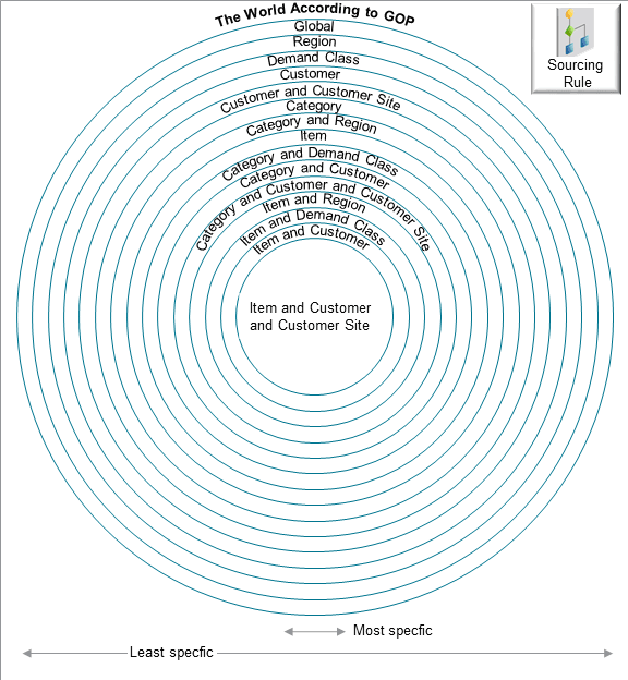

Here are the levels for your global sourcing rules, listed from the most specific in row 1, to the least specific in row 15.

Here's another way to visualize it.
