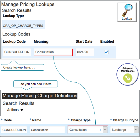

Assume you provide a site consultation for some customers. Your policy is to add a surcharge to the purchase price to cover the costs you incur to do the consultation. So you need to create a new charge definition for the consultation surcharge, a new charge type for the consultation, and a new charge subtype for the surcharge.
Create the charge type and charge subtype.
  1. Go to the Setup and Maintenance work area, then go to the Manage Pricing Lookups task.
  2. On the Manage Pricing Lookups page, search for the value:
    Attribute
    Value
    Lookup Type
    ORA_QP_CHARGE_TYPES
  3. In the Lookup Codes area, click Actions > New, then set the values:
    Attribute
    Value
    Lookup Code
    CONSULTATION
    Meaning
    Consultation
    Display Sequence
    1
    Enabled
    Contains a check mark
    Start Date
    Set to today or a date that happens before today.
  4. Click Save.
  5. In the Search area, search for the value:
    Attribute
    Value
    Lookup Type
    ORA_QP_CHARGE_SUBTYPES
  6. In the Lookup Codes area, click Actions > New, then set the values:
    Attribute
    Value
    Lookup Code
    SURCHARGE
    Meaning
    Surcharge
    Display Sequence
    1
    Enabled
    Start Date
  7. Click Save and Close.
Create your charge definition.
  1. On the setup page, go to the Manage Pricing Charge Definitions task.
  2. On the Manage Pricing Charge Definitions page, click Actions > Add Row, then set the values:
    Attribute
    Value
    Code
    CONSULTATION
    Name
    Consultation
    Applies To
    Price
    Price Type
    One Time
    Charge Type
    Consultation
    This is the charge that you created on the Manage Pricing Lookups page.
    Charge Subtype
    Surcharge
    This is the charge subtype that you created on the Manage Pricing Lookups page.
  3. Click Save and Close.
