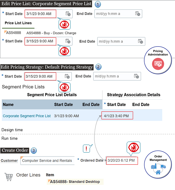

Example 1: Problem with the Price List's Dates
Assume you do this setup.
Assume you:
  1. Go to the Pricing Administration work area, then use the Price List page to:
    • Set the start date on the Corporate Segment Price List to March 1, and leave the end date for it empty.
    • In the Price List Lines tab, you add the AS54888 Desktop Computer to the Corporate Segment Price List, add a charge to the item, set the start date for the charge to March 15, and leave the charge's end date empty.
  2. Use the Edit pricing Strategy page to:
    • Set the start date on the Default Pricing Strategy to March 15, and leave the end date for it empty.
    • Add the Corporate Segment Price List to the Default Pricing Strategy, use the Strategy Association Details area to set the start date to April 1 when you add the price list to the strategy, and leave the list's end date empty.
      You use the Strategy Association Details area to specify the dates when you want to use this price list with the pricing strategy. The Segment Price List Details area displays the start and end date that you set for the price list. You can't edit these dates on the Edit Pricing Strategy page, but you can edit them on the Price List page.
  3. Go to the Order Management work area, create a sales order, set the Ordered Date attribute on the order header to March 20, add the AS54888 to the order, then click Actions > Reprice order.
    Pricing successfully determines the pricing strategy to use according to your pricing setup, but then Order Management displays an error message:
    A matching price list cannot be
              found for this transaction for the pricing strategy because the order date is outside the
              range of the start and end dates of the Strategy Detail for the price list in the
              strategy.
This happens because the Corporate Segment Price List doesn't start until April 1 on the Default Pricing Strategy, which is after the March 20 ordered date.
To fix this problem, set the start date for the Corporate Segment Price List on the Default Pricing Strategy to a date that happens before March 20, or wait until after the price list's April 1 start date, then reprice your order.
