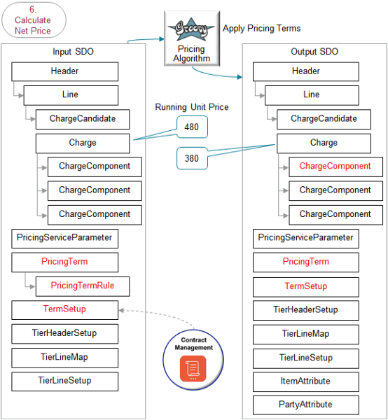

Here are the SDOs:
Apply Pricing Terms for Sales Agreement
Note
  • The output SDO from the Calculate Net Price step provides the input SDO.
  • The running unit price in the input SDO is 480.
  • Pricing applies adjustments from the sales agreement before it applies adjustments that the pricing strategy specifies. So, it runs this step immediately before it applies adjustments from the pricing strategy in the Calculate List Price step.
  • The TermSetup entity contains the rule that you specify on the sales agreement in Contract Management.
  • You use Order Management and Contract Management to set up the agreement, including terms that specify price, such as discounts. For details, see Overview of Setting Up Sales Agreements in Order Management.
  • The running unit price in the output SDO is 480 minus the 100 discount equals 380.

The Unit Price attribute contains the $100 discount that the sales agreement specifies.
