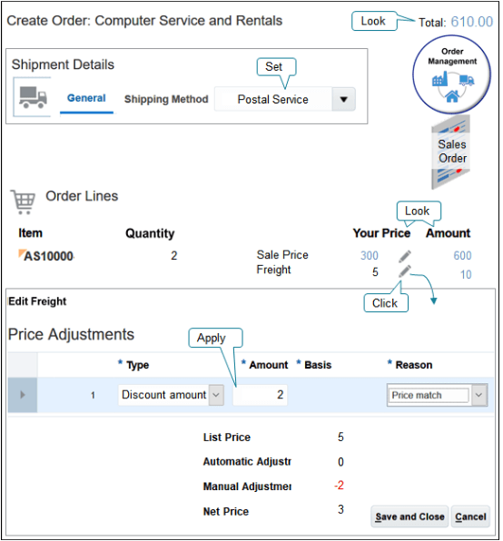

  1. Open your sales order in Order Management.
  2. Click Shipment Details, then set the Shipping method.
  3. Notice the order line.
  4. Notice that the order line contains a charge for Freight of $5 each, and an extended value in the Amount column of 10 because Quantity is 2.
  5. Notice the order total is $610.
  6. Click the pencil next to Freight in the Your Price column.
  7. In the Price Adjustments dialog, add an amount discount for $2, set Reason to Price Match, then click Save and Close:
    Note

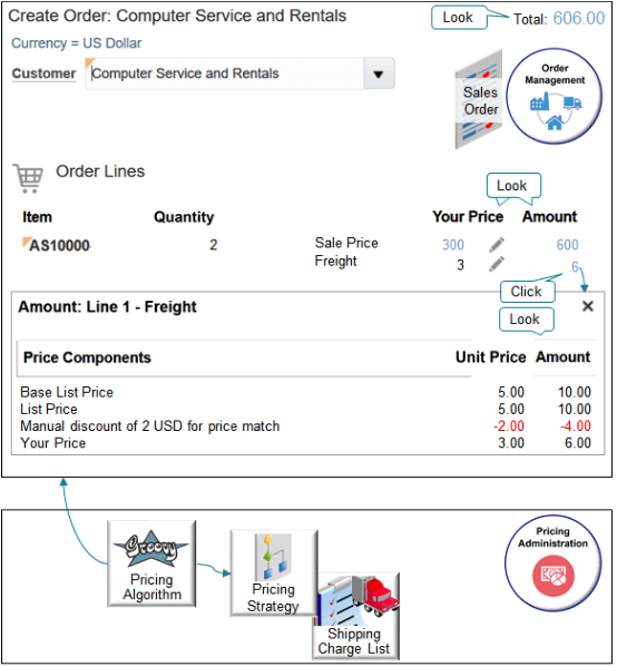

    • The value for Freight in the Your Price column is now 3.
    • The extended value in the Amount column is now 6.
    • The order total is $606.
Here are the SDOs:
the SDOs for this section
Note
  • The output SDO from the Calculate Cost and Margin step provides the input SDO.
