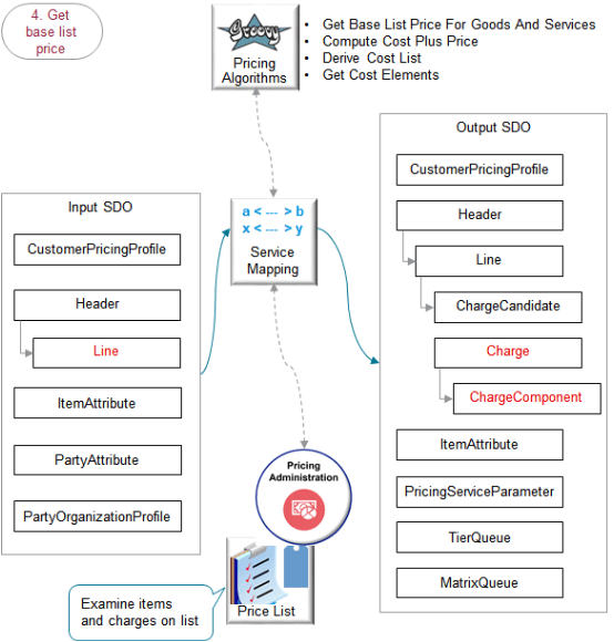

Example Pricing Algorithm, Part 4, Get Base List Price
Create a charge for the item on the price list, then use the charge as the base list price for the item.
The base list price is the price you charge for a quantity of 1 for the item before you apply any tiered pricing that you set up for the item:
The output SDO from the Get Pricing Strategy provides the input SDO.

Here's what the algorithms do:
What the Algorithms Do
How the Algorithms Do It
1. Find charge candidates for coverage items.
2. Find charge candidates for component items.
3. Find charge candidates for items and component items.
Use values in the input SDO to find charge candidates. For each item, match the item, unit of measure, business unit, and line type.

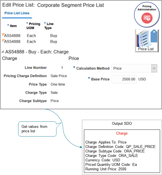

Assume the Corporate Pricing Strategy includes the Corporate Segment Price List. 300100071623855 identifies the list. This price list includes the AS54888 item with a Pricing UOM of Each and Line Type of Buy.
Create a charge candidate for each charge that it finds that matches the query.
On the Price List page in Pricing Administration, assume you search the Corporate Segment Price List for the AS54888 item. The search returns row 1 and row 2, and each row contains the AS54888 with a Pricing UOM of Each and Line Type of Buy. Each of these rows is a candidate to become the charge.
4. Filter duplicate charge candidates.
If the query finds more than one charge candidate for each line, then filter them according to the item's precedence.
An item that has a charge defined takes precedence over other items. For example, if row 1 from your search on the Price List page contains a charge in the Charge area but row 2 doesn't, then the filter will return only row 1.

For the 5. Create charges step, create a charge for each candidate that remains after filtering them. For example, if the AS54888 on row 1 and the AS54888 on row 2 each contain a charge, then create a charge for each of them. If no charge candidates match the query criteria, then the algorithm creates an error:
The algorithm uses your set ups in the Pricing Administration work area. If the charge includes:
  • Tiered adjustment, then the algorithm populates the TierQueue entity in the output SDO.
  • Price adjustment matrix, then the algorithm populates the MatrixQueue entity.

Charge
CanAdjustFlag: Y
ChargeAppliesTo: Price
ChargeDefinitionCode: QP_SALE_PRICE
ChargeDefinitionId: 3001000070841552
ChargeId: 1
ChargeSubtypeCode: ORA_PRICE
ChargeTypeCode: ORA_SALE
CompSeqCntr: 1001
CurrencyCode: USD
EstimatedPricedQuantityFlag: N
EstimatedUnitPriceFlag: N
LineId: 1
NeedsCostPlus: N
NeedsMargin: Y
ParentEntityCode: LINE
ParentEntityId: 1
PriceTypeCode: ONE_TIME
PricedQuantity: 2 Ea
PricedQuantityUOMCode: Ea
PrimaryFlag: N
RollupFlag: N
RunningUnitPrice: 2500
TaxIncludedFlag: N
ChargeComponent
ChargeComponentId: 1
ChargeId: 1
CurrencyCode: USD
ExtendedAmount: 5000 USD
PriceElementCode: QP_BASE_LIST_PRICE
PriceValidFrom: 2019-03-26 @ 08:32:53
SequenceNumber: 1000
SourceId: 3001000071623860
SourceTypeCode: PRICE_LIST_CHARGE
UnitPrice: 2500 USD
In this example, the base price is 2,500, the quantity is 2, so the algorithm calculates the extended amount as 5,000.
