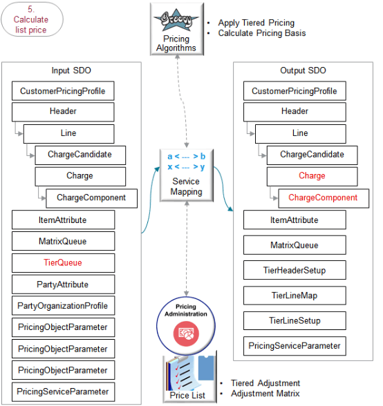

This step includes three parts:
  • Apply Tier Adjustment
  • Apply Matrix Adjustment
  • Finalize List Price

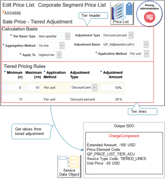

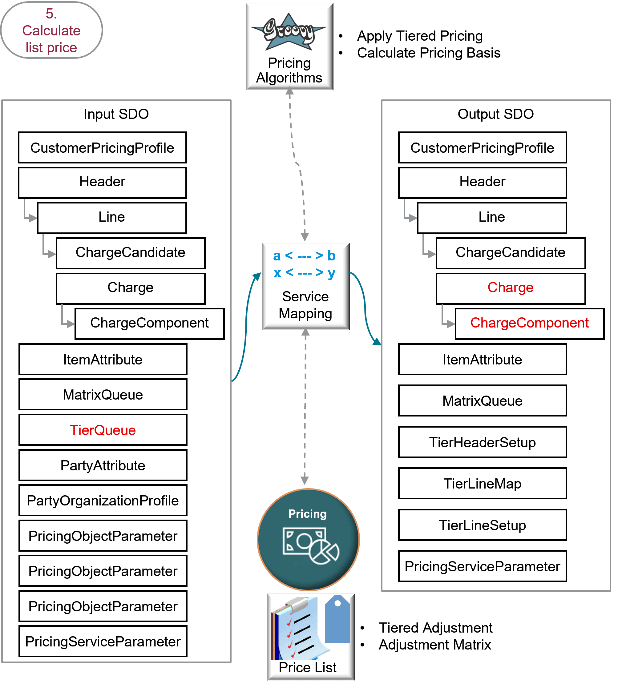

You apply a tier adjustment in our example. For example, prorate a tier adjustment according to the billing frequency of a recurring charge. Use a service mapping to send the billing frequency through an extensible attribute to the algorithm, then use the Apply Tiered Pricing algorithm to extend the duration of the recurring charge.

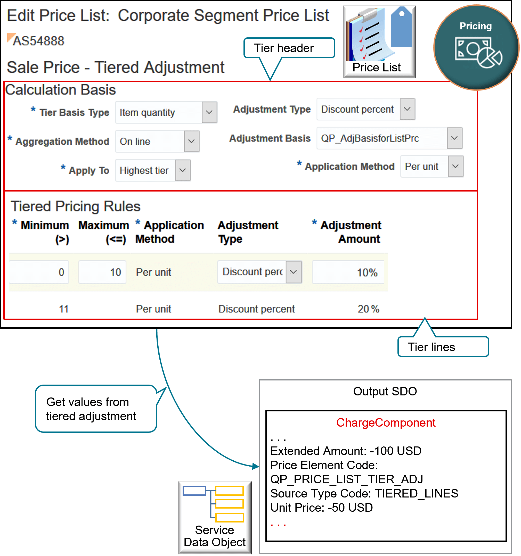

You apply a tier adjustment that you set up on the price list. Apply it to the base list price. You create tiers according to amount or quantity. For example, create tier 1 that gives a 10% discount off the base list price for quantities 1 through 10, and tier 2 that gives a 20% discount for quantities above 10.
Here are the SDOs:
Note
  • The output SDO from the Get Base List Price step provides the input SDO.
  • The TierQueue entity contains details about the tier adjustment.
The algorithms use your set ups in the Pricing Administration work area:
The algorithms use your set ups in the Pricing Administration work area.
Here's what the algorithms do:
What the Algorithms Do
How the Algorithms Do It
1. Get the tier header.
Get details from the tier header. For example, the type of tier basis, such as item quantity. The Calculation Basis area on the Price List page in Pricing Administration contains most of the tier header attributes.
2. Calculate the adjustment amount according to the tier basis.
Assume:
  • The tier basis is item quantity.
  • The quantity on the order line is 2.
  • The base list price is 2,500 for Each.
  • Tier 1 gives a 10% discount on quantities 1 through 10.
So, the adjustment amount is 500 (2 multiplied by 2,500 multiplied by 10%).

Here are details about the attributes in the SDOs:
Entity
Attributes in Input SDO
Attributes in Output SDO
Charge
RunningUnitPrice: 2450
ChargeComponent
ChargeComponentId: 2
ChargeId: 2
ExplanationMessageName: QP_PRICE_LIST_TIER_ADJ
ExtendedAmount: -100 USD
IsInternal: N
PriceElementCode: QP_PRICE_LIST_TIER_ADJ
PriceValidFrom: 2019-03-26 @ 08:32:53
SequenceNumber: 1001
SourceId: 300100177515265
SourceTypeCode: TIERED_LINES
UnitPrice: -50 USD
Note
  • UnitPrice contains the adjustment amount.
  • RunningUnitPrice is BaseListPrice of 2500 minus UnitPrice of 50 equals of 2450.
  • ExtendedAmount is UnitPrice of 50 multiplied by Quantity of 2 equals 100.
Here are some of the functions you can use with the Apply Tiered Pricing algorithm. This algorithm does most of the calculations. It calls the Calculate Pricing Basis algorithm. All functions are View Object Lookup except getMessage, which is a script:

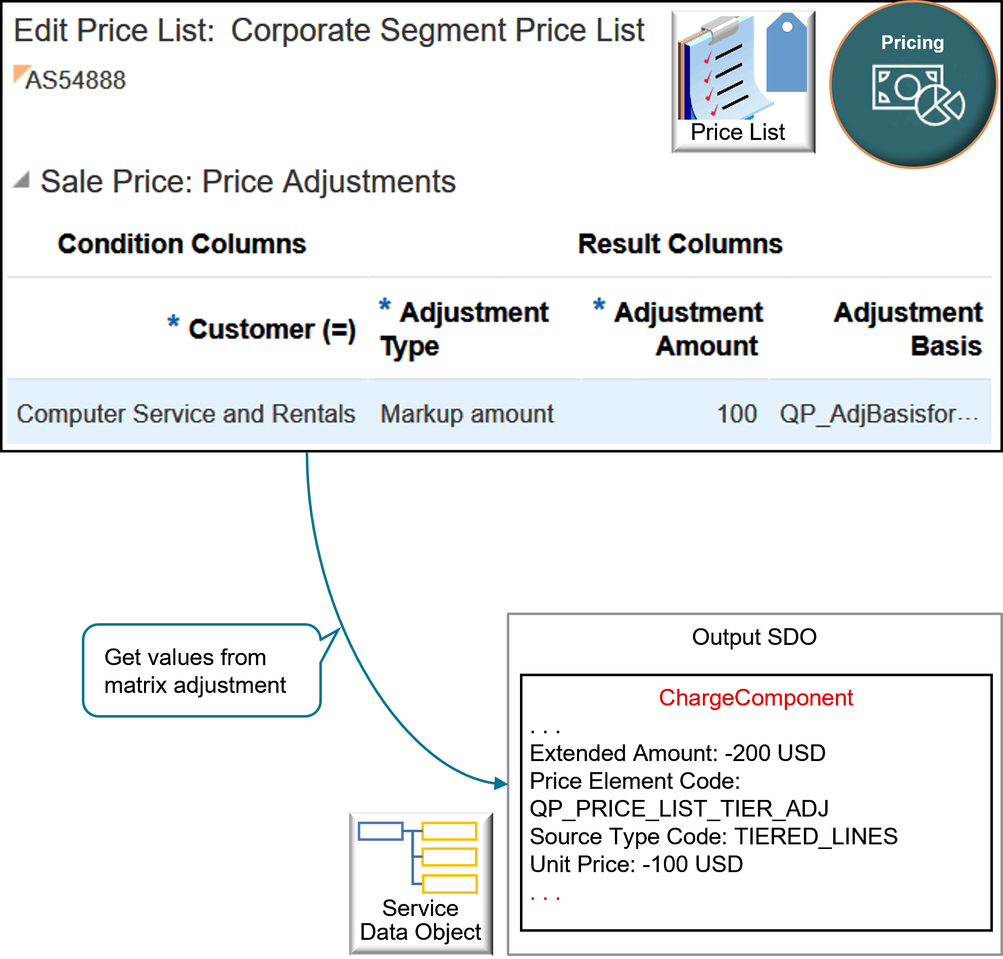

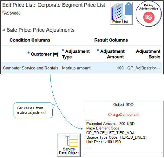

The matrix adjustment is similar to the tier adjustment:
  • Apply a matrix adjustment that you set up on the price list. Apply it on the base list price.
    Set up a matrix adjustment according to the value of an attribute. For example, if the Customer attribute contains Computer Service and Rentals, then give a $100 discount.
  • The output SDO from the Apply Tier Adjustment part of the Calculate List Price step is the input SDO in the Apply Matrix Adjustment part.
  • The MatrixQueue entity in the input SDO contains the matrix adjustment details.
The algorithm uses your set up in the Pricing Administration work area:
The algorithm uses your set up in the Pricing Administration work area.
Here's what the algorithm does:
What the Algorithm Does
How the Algorithm Does It
1. Get the attributes.
2. Evaluate the matrix rules.
If your add more than one rule in your matrix, then add a precedence condition so the algorithm knows which rule to apply if more than one rule matches the runtime condition.
3. Calculate the matrix adjustments.
4. Handle matrix errors. The most common error happens when the condition column isn't part of the algorithm data set.
Here are details about the attributes in the SDOs. Bold font indicates attributes that the algorithm added to the output SDO:
Entity
Charge
RunningUnitPrice: 2350
ChargeComponent
ChargeComponentId: 3
ChargeId: 1
ExplanationMessageName: QP_PRICE_LIST_ATTR_ADJ
ExtendedAmount: -200 USD
MatrixConditionString: Customer=Computer Service and Rentals
MatrixResultString: Adjustment Type=Discount Amount Adjustment Amount =100 Adjustment Basis=null
PriceElementCode: QP_PRICE_LIST_ATTR_ADJ
SequenceNumber: 1002
SourceId: 300100177515271
SourceTypeCode: MATRIX_RULE
UnitPrice: -100 USD
Note
  • Assume you create a tier adjustment and a matrix adjustment. The flow applies the tier adjustment first, then the matrix adjustment. The value of RunningUnitPrice after the tier adjustment is 2450. So, RunningUnitPrice now is 2450 minus UnitPrice of 100 equals 2350.
  • ExtendedAmount is UnitPrice of 100 multiplied by Quantity of 2 equals 200.

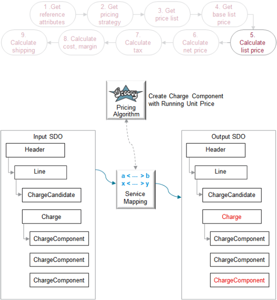

Finalize List Price
Finalize List Price
The output SDO from the Apply Matrix Adjustment part of the Calculate List Price step provides the input SDO.
1. Round the list price and the net price.
Examine, then round RunningUnitPrice for each charge:
  • Get the rounding rules for the currency that the charge uses.
    In this example, the charge currency is the same as the price list currency, which is USD.
  • Determine the delta. The delta is the difference between the value that isn't rounded and the value that's rounded.
  • Apply the delta on another charge component as a rounding adjustment. For example, if RunningUnitPrice is $101, and if the round rule specifies to round to the nearest hundred, then the delta is $1.
  • Set RunningUnitPrice to the rounded value.
  • Create a charge component then store the rounded value in it.
  • Calculate the extended amount according to the quantity.
2. Create the charge component for the net price.
Entity
Charge
ChargeComponent
ChargeComponentId: 4
ChargeId: 1
CurrencyCode: USD
ExtendedAmount: 4700 USD
PriceElementCode: QP_LIST_PRICE
PriceElementUsageCode: LIST_PRICE
SequenceNumber: 1003
SkipRunningPrice: Y
TaxIncludedFlag: N
UnitPrice: 2350 USD
Note
  • UnitPrice contains the rounded, final amount.
  • RunningUnitPrice is the rounded value.
  • RunningUnitPrice contains the same value that the charge component for the list price contains.
  • ExtendedAmount is RunningUnitPrice of 2350 multiplied by Quantity of 2 equals 4700.
  • PriceElementCode uses QP_LIST_PRICE to set the list price.

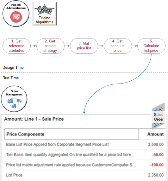

Where Do Pricing Details Display?
The Order Management work area displays each charge component on a separate line in the Amount dialog of the sales order:
The Order Management work area displays each charge component on a separate line in the Amount dialog of the sales order.
