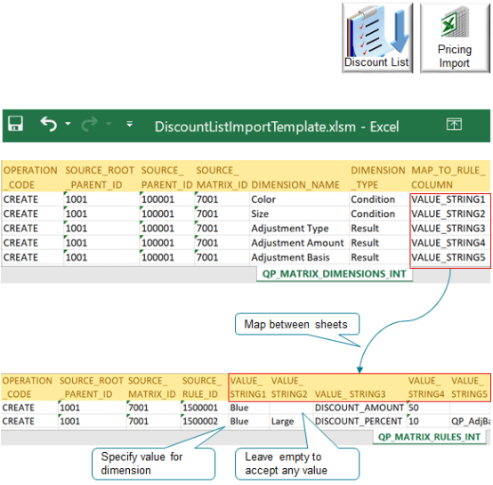

  7. Create new matrix dimensions:
    • Click the QP_MATRIX_DIMENSIONS_INT tab, then set the values:
      OPERATION_CODE
      SOURCE_ROOT_PARENT_ID
      SOURCE_PARENT_ID
      SOURCE_MATRIX_ID
      DIMENSION_NAME
      DIMENSION_TYPE
      MAP_TO_RULE_COLUMN
      CREATE
      1001
      100001
      7001
      Color
      Condition
      VALUE_STRING1
      CREATE
      1001
      100001
      7001
      Size
      Condition
      VALUE_STRING2
      CREATE
      1001
      100001
      7001
      Adjustment Type
      Result
      VALUE_STRING3
      CREATE
      1001
      100001
      7001
      Adjustment Amount
      Result
      VALUE_STRING4
      CREATE
      1001
      100001
      7001
      Adjustment Basis
      Result
      VALUE_STRING5
      Note
      • Use a separate row for each CREATE action.
      • SOURCE_ROOT_PARENT_ID maps to the SOURCE_DISCOUNT_LIST_ID column on the QP_DISCOUNT_LISTS_INT sheet. It identifies DISCOUNT_LIST_1 as the root parent of each matrix dimension.
      • SOURCE_PARENT_ID maps to the SOURCE_TERM_ID column on the QP_PRICING_TERMS_INT sheet. It identifies AS54888-AR1 as the parent pricing term of each matrix dimension.
      • SOURCE_MATRIX_ID is a unique value you add to identify the pricing matrix.
      • DIMENSION_NAME and DIMENSION_TYPE must equal the same value you set up in the matrix class. You will verify these later in this topic.
      • Use a different value for each row in MAP_TO_RULE_COLUMN. You must use the name of a VALUE_STRING column from sheet QP_MATRIX_RULES_INT. You will see why next.
  8. Create new matrix rules:
    • Click the QP_MATRIX_RULES_INT tab, then set the values:
      OPERATION_CODE
      SOURCE_MATRIX_ID
      SOURCE_RULE_ID
      CREATE
      1001
      7001
      1500001
      CREATE
      1001
      7001
      1500002
      Note
      • SOURCE_ROOT_PARENT_ID maps to the SOURCE_DISCOUNT_LIST_ID column on the QP_DISCOUNT_LISTS_INT sheet. It identifies DISCOUNT_LIST_1 as the root parent of each matrix rule.
      • SOURCE_MATRIX_ID maps to the SOURCE_ MATRIX_ID column on the QP_MATRIX_DIMENSIONS_INT sheet. It identifies 7001 as the parent dimension for the matrix rule.
      • SOURCE_RULE_ID is a unique value you add to identify the rule.
      Here's a continuation of the same rows. You add the value strings:
      VALUE_STRING1
      VALUE_STRING2
      VALUE_STRING3
      VALUE_STRING4
      VALUE_STRING5
      Blue
      Leave empty
      DISCOUNT_AMOUNT
      50
      Leave empty
      Blue
      Large
      DISCOUNT_PERCENT
      10
      QP_AdjBasisforBaseListPrc
      Use the value strings columns to create relationships between QP_MATRIX_DIMENSIONS_INT and QP_MATRIX_RULES_INT:
      Use the value strings columns to create relationships between QP_MATRIX_DIMENSIONS_INT and QP_MATRIX_RULES_INT.
      Note
      • You map value strings from the QP_MATRIX_DIMENSIONS_INT sheet to the QP_MATRIX_RULES_INT sheet.
      • The MAP_TO_RULE_COLUMN on sheet QP_MATRIX_DIMENSIONS_INT identifies the column on sheet QP_MATRIX_RULES_INT.
      • For example, VALUE_STRING1 in column MAP_TO_RULE_COLUMN maps to column VALUE_STRING1 on sheet QP_MATRIX_RULES_INT. The dimension on sheet QP_MATRIX_DIMENSIONS_INT is Color, and it maps to VALUE_STRING1 on QP_MATRIX_RULES_INT, which contain Blue.
      • The value string column on QP_MATRIX_RULES_INT identifies the value you will be able to select in Pricing Administration. If you leave the value empty in a value string column on QP_MATRIX_RULES_INT, then you can select any value Pricing Administration. If you leave it empty, make sure you enable Allow Null for the matrix class, which you will do later in this topic.
      • The value for VALUE_ STRING5 is QP_AdjBasisforBaseListPrc. Its chopped off in the screen print.

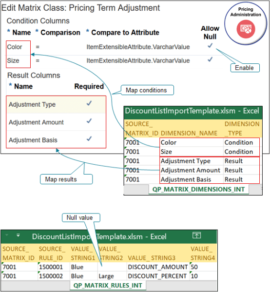

Set Up Matrix Class
You must set up the class so it supports the pricing matrix that you're adding to the discount list. You must set it up before you upload your data:
Note
  • Add condition columns in the matrix class that support the conditions you add on the QP_MATRIX_DIMENSIONS_INT sheet.
  • Add result columns in the matrix class that support the results you add on the QP_MATRIX_DIMENSIONS_INT sheet.
  • Enable the Allow Null attribute on the condition in the matrix class so you can use an empty value in the QP_MATRIX_RULES_INT sheet. Use null so you can enter any value when you set up the discount list in the Pricing Administration work area. If you don't use null, then you must select from the values that you specify on the sheet.
  • Do this set up only if your import includes conditions and results that are different from the matrix class in the Pricing Administration work area.
For this example, you add your own attributes to the predefined Pricing Term Adjustment matrix class.
Try it.
  1. Go to the Pricing Administration work area, then click Tasks > Manage Matrix Classes.
  2. On the Manage Matrix Classes page, in the Name column, click Pricing Term Adjustment.
  3. On the Edit Matrix Class page, in the Condition Columns area, add rows:
    Name
    Comparison
    Compare to Attribute
    Allow Null
    Size
    itemExtensibleAttribute.VarcharValue
    Contains a check mark
    Color
    Recall that you added these in the worksheet and specified them as Condition dimension types.
    Learn how to set the compare to attribute and domain in the condition and result. For details, see Add Your Own Attributes to Items in Pricing.
  4. Verify that the results support your new pricing matrix.
    In the Result Columns area, if these rows don't exist, add them. Recall that you added these in the worksheet and specified them as Result dimension types. Notice that they're all required:
    Name
    Required
    Allow Null
    Adjustment Type
    Empty
    Adjustment Amount
    Empty
    Adjustment Basis
  5. Click Save and Close.

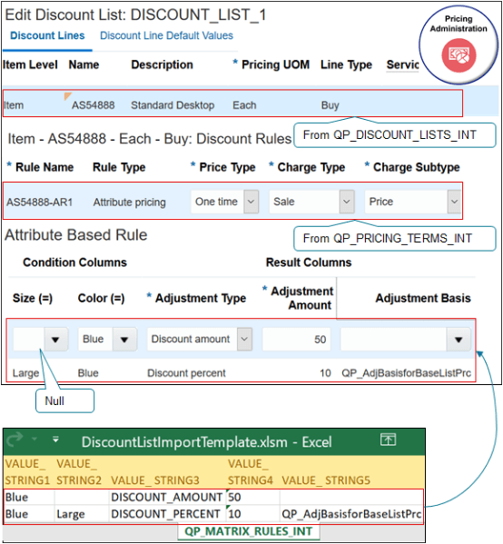

Upload and Verify Data
Do it.
  1. Create the zip file, upload your data, and run the scheduled processes. For details, see Import Batches of Discount Lists.
  2. In the Pricing Administration work area, click Tasks > Manage Discount Lists.
  3. Search for and DISCOUNT_LIST_1 and open it for editing.
  4. Verify that the header contains the values you specified on sheet QP_DISCOUNT_LISTS_INT:

  5. In the Discount Lines area, search for the item you added from sheet QP_DISCOUNT_LIST_ITEMS_INT:
    Attribute
    Value
    Name
    AS54888
  6. Verify that the search results contain the values you specified on sheet QP_DISCOUNT_LIST_ITEMS_INT:
    Attribute
    Value
    Pricing UOM
    Each
    Line Type
    Buy
    Note that Pricing gets other values for the item from Product Management, such as Standard Desktop in the Description.
  7. Expand section Item AS54888 Each Buy: Discount Rules, then verify that it contains the values you specified in sheet QP_PRICING_TERMS_INT:
    Attribute
    Value
    Rule Name
    AS54888-AR1
    Rule Type
    Attribute Pricing
    Price Type
    One Time
    Charge Type
    Sale
    Charge Subtype
    Price
  8. Expand section Attribute Based Rule, then verify that it contains the values you specified in sheet QP_MATRIX_RULES_INT:
    Size
    Color
    Adjustment Type
    Adjustment Amount
    Adjustment Basis
    Empty
    Blue
    Discount Amount
    50
    Empty
    Large
    Blue
    Discount Percent
    10
