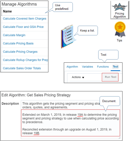

Minimize management, maintenance, and troubleshooting:
Use predefined algorithms instead of extending algorithms, when possible.
If the predefined algorithms don't meet your needs, then extend a predefined algorithm.
If extending a predefined algorithm doesn't meet your needs, then create a new one.
Keep a list of the algorithms that you extend. Use it to help identify your extended algorithms when you install the latest update to make sure you don't overlook one.
Use the Description in each extended algorithm to document your extension.
Test each extended algorithm after you install the latest update.

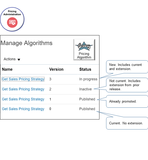

Go to the Manage Algorithms page and verify that it includes Version 2 of the Get Sales Pricing Strategy algorithm:
Note
Version Description 3
The version that you will create to bring your extended algorithm from the prior update into the latest update. 2 The version that you that extended in the prior update as part of this example. The update automatically brings your extended algorithms from the prior update into the latest update, but version 2 doesn't include the changes Oracle made as part of the update, so you will deactivate it. 1 The version that you already promoted. 0 The version that Oracle includes in the latest update. It includes changes that Oracle made as part of the update, but it doesn't include your extensions. You will create a new version 3 from version 0
Click the row that includes version 0, and then click Actions > Create Version.
Pricing creates version 3. It's identical to version 0.
Click the link in the row that includes version 3.
