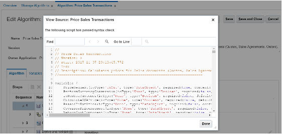

You can click View Source to verify the source code of a pricing algorithm.
            Go to the Pricing Administration work area, then click Tasks > Manage Algorithms under Pricing Configuration.
            On the Manage Algorithms page, locate the algorithm you must modify.
            Click Actions > Create Version.
            Modify the pricing algorithm so it meets your requirements.
            Along the top of the Edit Algorithm page, Click View Source, then make sure the dialog that displays includes this message. The following script has passed syntax checkFor example:
Note
            View Source examines and validates your syntax. It then displays the Groovy code that defines the algorithm in a dialog.
            Use it before you publish your pricing algorithm.
            You can also use it to get a complete picture of how you set up the algorithm, or to troubleshoot between versions of the algorithm.
            For example, copy the source code of the working version and of the nonworking version, paste it into a code comparison application, then examine the difference to help identify the code that might be causing the problem.
Here's some code that includes the kind of details that are available when you click View Source.
