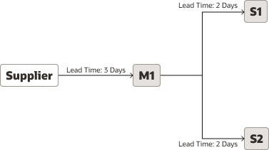

These are the details of the supply chain:
  • The source location is M1 and gets its supply from a supplier.
  • The lead time for M1 is 3 days. The lead time is considered as a constraint.
    However, the supplier capacity isn't considered as a constraint.
  • M1 has two destination locations named S1 and S2.
    The lead time for S1 and S2 is 2 days.
  • The applicable policy type is min-max planning.
The following figure depicts this supply chain:
Figure depicting example of supply chain
