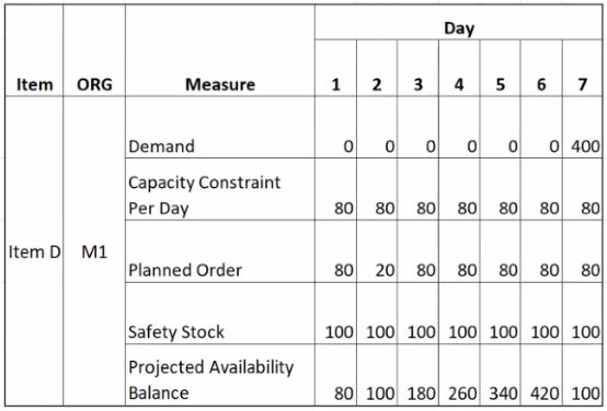

For this example, let's use these parameters:
               Item D has a demand on Day 7
               Resource capacity constraint is 80 units per day
               Item D has a safety stock amount of 100 units from Day 1 through Day 7
         In this scenario,
               The planning process created supply for 80 units only on Day 1.
               The safety stock quantity of 100 units on Day 1 can't be completely satisfied because the plan can't exceed the resource capacity constraint (80 units) to meet the safety stock quantity.
