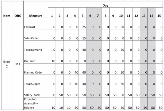

Safety Stock Planning with Lead Time Constraint
For this example, let's use these parameters:
               Nonworking days: Days 6, 7, 13, and 14
               Purchasing lead time: 3 days
               Enforce Purchasing Lead Time item attribute: Yes
         In this scenario,
               The constrained supply plan enforced the purchase lead time of Item C.
               The planning process created supply on Day 4, which is the plan start date plus the lead time.
               Safety stock from Day 1 to Day 3 wasn't met because the purchasing lead time was enforced by the plan for Item C.
