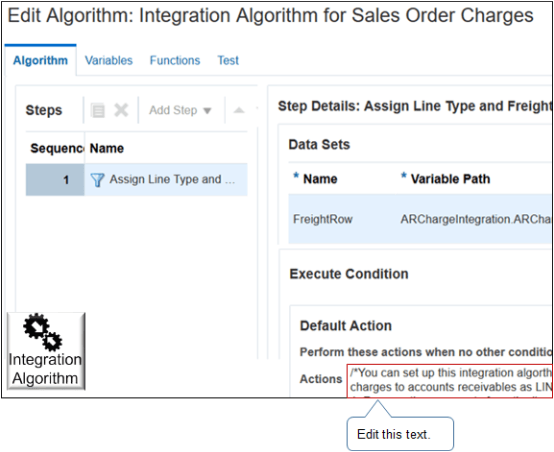

  5. On the Edit Algorithm page, in the Step Details area, in the Execute Condition area, in the Default Action area, locate the code in the Default Actions window:
    Editing the integration algorithm.
  6. Click Edit immediately to the right of the Actions window.
    Notice the text that Actions contains.

  7. Remove the commented instructional text, remove the two forward slashes (//) from this code, then add the line and Id details for your shipping line:
    //FreightRow.LineType = ChargeRow.ChargeApplyTo == "SHIPPING" ? "LINE" : FreightRow.LineType
    //FreightRow.InventoryItemId = ChargeRow.ChargeApplyTo == "SHIPPING" ? '<Replace with Freight Inventory Item Id>' : null
