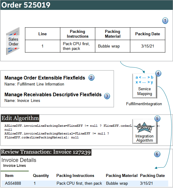

Note
  1. Assume you need to add your own shipping details when you create an order line for a new sales order in Order Management:
    • Packing instructions
    • Packing material
    • Packing date
  2. You will add these attributes to the Fulfillment Line Information extensible flexfield.
  3. You edit the Invoice Lines descriptive flexfield so you can display shipping details on the invoice line.
  4. You modify the FulfillmentIntegration service mapping to map the extensible flexfield between Order Management and the descriptive flexfield in Oracle Receivables.
  5. You create an integration algorithm that specifies the data to communicate.
  6. You use the Billing work area to examine the invoice that contains the shipping details.
Summary of the Setup
  1. Prepare your setup.
  2. Edit extensible flexfield.
  3. Edit service mapping for extensible flexfield.
  4. Edit descriptive flexfield.
  5. Edit service mapping for descriptive flexfield.
  6. Create integration algorithm.
  7. Test your set up.
