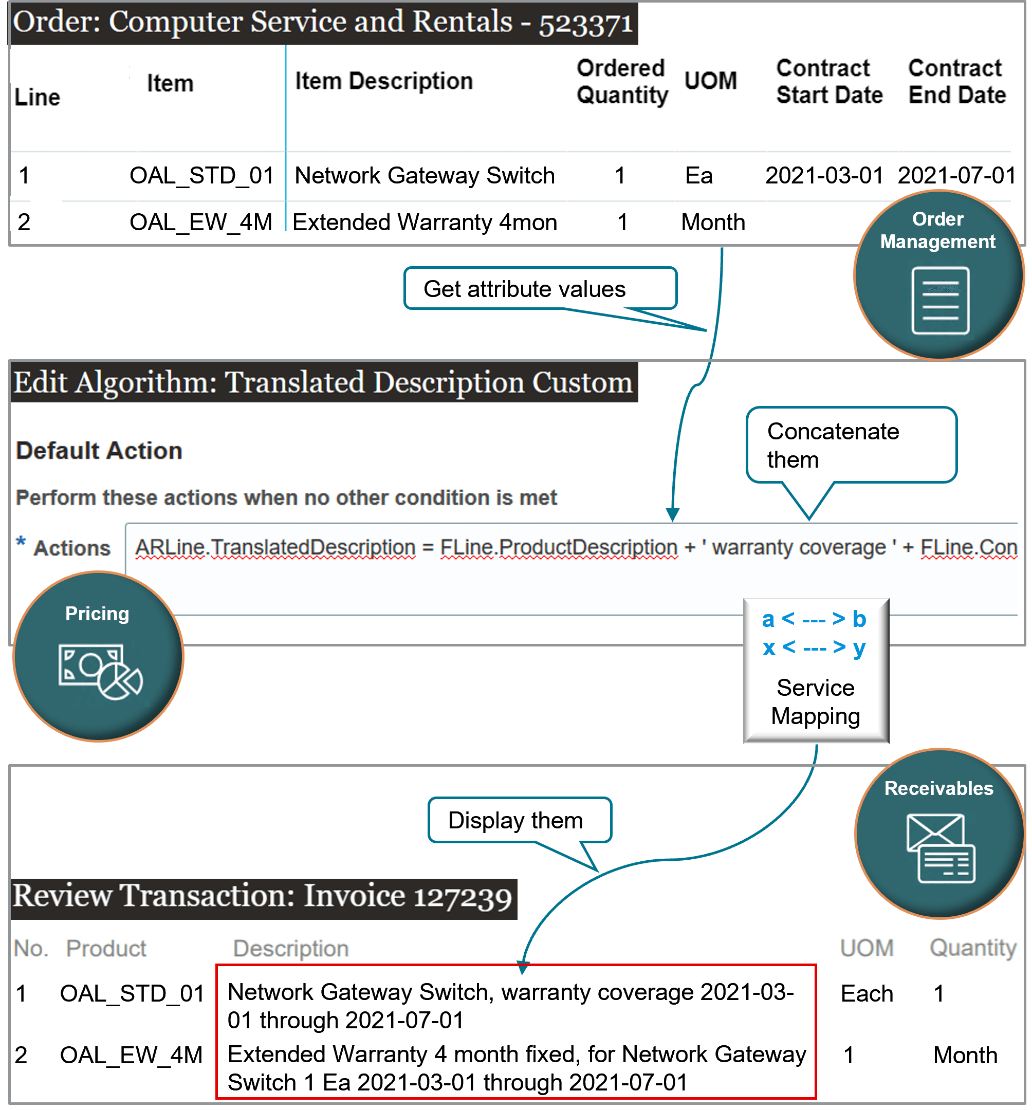

Here's an example:
You get attributes value on the order line from Order Management,
Note
  • You get attributes value on the order line from Order Management, including the Item Description, Quantity, Unit of Measure, Contract Start Date, and Contract End Date.
  • You use an integration algorithm in the Pricing Administration work area to concatenate the values for the attributes into a single string of text, and then use a service mapping to map it to Oracle Receivables.
  • The Description on the invoice in Oracle Receivables displays the string.
  • If the sales order contains a coverage item, such as a warranty, then you create another concatenated string for the description of the coverage item. This string includes the description of the coverage item plus the same attribute values that the string for the covered line has.

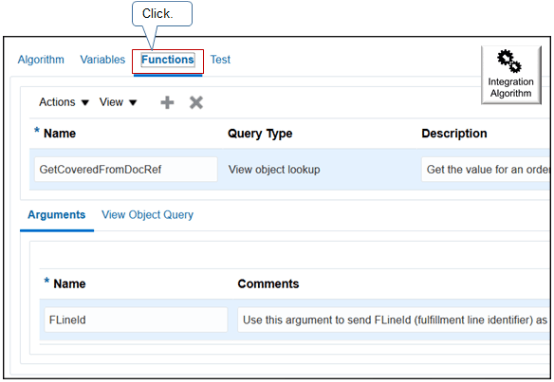

  1. Add a function:
    • Click Functions, click Actions > Add Row, then set the values:
      Attribute
      Value
      Name
      GetCoveredFromDocRef
      Query Type
      View Object Lookup
      Description
      Get the value that identifies the order line that has the covered item.
    • In the Arguments area, click Add Row, then add an argument:
      Attribute
      Value
      Name
      FLineId
      Comments
      Use this argument to send the FLineId (order line identifier) that identifies the order line that contains the coverage item, and then return a value that identifies the covered item.

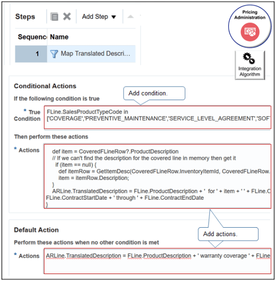

Add a Step to Your Integration Algorithm
Add a conditional step that runs differently depending on whether the order line that the algorithm is currently processing contains a covered item or a coverage item:
step that runs when data meets the condition.
Try it:
  1. Click the Algorithm tab, click Add Step > Conditional Action, then set the values:
    Attribute
    Value
    Name
    Map Translated Description
    Description
    Concatenate the descriptions for the covered item and the coverage item.

  4. In the Execute Condition area, click Add Condition > Default Action.
    You will add the code that creates the concatenated string for the covered item.
    In the Default Action area, add code in the Actions window.
    ARLine.TranslatedDescription = FLine.ProductDescription + ' warranty coverage ' + FLine.ContractStartDate + ' through ' + FLine.ContractEndDate
    where
    Code
    What it Does
    Create a variable named TranslatedDescription and add it to the ARLine data set.
    Store the value of the concatenated string in the TranslatedDescription variable.
    Get the value of the description for the order line that we're currently processing. This is the description for the covered item from the FLine data set.
    Get the value of the contract start date for the covered item from the FLine data set.
    If you add coverage to a covered item, then you use the Contract Start Date and Contract End Date on the covered item, not the coverage item. The coverage item provides coverage for a duration, such as 1 Year, but not for the specific start date and end date. Instead, you set the start date and end date on the covered item. This way, you can use the coverage item for a variety of covered items.
    Get the value of the contract end date for the covered item from the FLine data set.
    Concatenate the value of one string to another. Insert a space between these concatenated strings.
    + ' through ' +
    Concatenate the value of one string to another. Insert text between these concatenated strings. For example, insert the phrase warranty coverage between these concatenated strings.
    This action applies to order lines that contain a standard item or shippable item.
    This code specifies how to concatenate the attribute values. Here's an example of the run time value that this code renders.
    Network Gateway Switch, warranty coverage 2021-03-01 through 2021-07-01
  5. Add the code that creates the concatenated string for the coverage item.
    You will add a new conditional action that applies only if the item is a coverage item. The concatenation is slightly different for a coverage item than it is for a covered item. You also need to get some details from the line that has the covered item:
    • In the Execute Condition area, click Add Condition > True Condition.
    • In the Conditional Actions area, add code in the True Condition window.
      FLine.SalesProductTypeCode in ['COVERAGE','PREVENTIVE_MAINTENANCE','SERVICE_LEVEL_AGREEMENT','SOFTWARE_MAINTENANCE','INCLUDED_WARRANTY']
      The SalesProductTypeCode attribute on the order line specifies whether the line contains a coverage item, such as a maintenance agreement, warranty, and so on. So this code specifies to do this conditional action only if the line contains a coverage item.
    • Add code in the Actions window.
      CoveredFlineDocRefRow = GetCoveredFromDocRef(FLine.FulfillLineId)
      if (CoveredFlineDocRefRow?.DocSublineId != null) {
        // Locate the covered line according to DocSublineId
        CoveredFLineRow = AllFLines.locate([FulfillLineId: Long.parseLong(CoveredFlineDocRefRow?.DocSublineId)])
        // If we can't find the covered line in memory then get it
        if (CoveredFLineRow == null)
          CoveredFLineRow = GetCoveredFLine(CoveredFlineDocRefRow?.DocSublineId)
        def item = CoveredFLineRow?.ProductDescription
        // If we can't find the description for the covered line in memory then get it
        if (item == null) {
          def itemRow = GetItemDesc(CoveredFLineRow.InventoryItemId, CoveredFLineRow.InventoryOrganizationId)
          item = itemRow.Description;
        ARLine.TranslatedDescription = FLine.ProductDescription + '  for ' + item + ' ' + FLine.OrderedQty.toString() + ' ' + FLine.OrderedUom + ' ' + FLine.ContractStartDate + ' through ' + FLine.ContractEndDate

      Create a variable named TranslatedDescription and add it to the ARLine data set. Store the value of the concatenated string in TranslatedDescription.
      FLine contains attribute values for the line that we're currently processing, which is the coverage item:
      • FLine.ProductDescription is the description of the coverage item.
      • item is a variable that contains the description of the covered item, such as Desktop Computer.
      • FLine.OrderedQty.toString() is the quantity of the coverage item, converted to a string.
      • FLine.ContractStartDate is the start date of the coverage item.
      • FLine.ContractEndDate is the end date of the coverage item.
      This description is going on the invoice line that has the coverage item, so its useful to identify the item that the coverage covers.
      Extended Warranty 4 month fixed, for Network Gateway Switch 1 Ea 2021-03-01 through 2021-07-01
    • Click Save and Close, then close the Manage Algorithms tab.

    • On the printed invoice that displays, verify the description for the invoice line that has the network switch:
      Attribute
      Value
      Description
      Notice that this value is a concatenation of the description of the covered item, and then the start date and end date of the coverage. It is the result of the Default action that you created in the algorithm.
    • Verify the description for the invoice line that has the extended warranty:
      Attribute
      Value
      Description
      Notice that this value is a concatenation of the description of the coverage item, and then the description of the covered item, and then the quantity, unit of measure, start date, and end date of the coverage item.
      This line contains a coverage item, so it meets the condition from the algorithm. It is the result of the Conditional action that you created in the algorithm.
