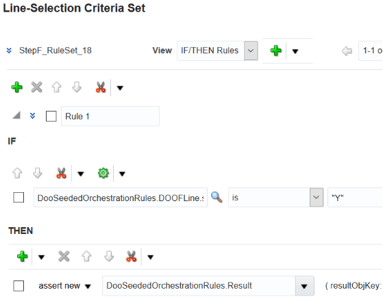

Create the If Statement
  1. Go to the Setup and Maintenance work area, then go to the Manage Orchestration Process Definitions task.
  2. On the Manage Orchestration Process Definitions page, locate the CallCustomerWhenLargeInvoice orchestration process, then click Actions > Edit.
    Learn how to create CallCustomerWhenLargeInvoice. For details, see Add Branches to Orchestration Processes.
  3. On the Edit Orchestration Process Definitions page, in the Process Details area, in the Step Definition list, locate the Ship Item row.
  4. In the Ship Item row, in the Line Selection Criteria column, click Click for Rule.
  5. In the Line Selection Criteria dialog, click Add Rule > Expand.
  6. In the If area, click Left Value, expand DOOSeededOrchestrationRules > DOOFline, click ShippableFlag, then click OK.
  7. In the Right Value attribute, enter "Y". You must include the double quotation marks.

Create the Then statement:
  1. In the Then area, click Add Action > Assert New.
  2. Click Select a Target > DooSeededOrchestrationRules.Result.
  3. Click Edit Properties.
  4. In the Properties dialog, in the ResultObjKey row, click Value.
  5. In the Condition Browser, enter DOOFLine, wait a moment, expand DooSeededOrchestrationRules.DOOFLine, click FulfillLineId, then click OK > OK.
  6. In the Line Selection Criteria dialog, click Validate, make sure the Validation Log that displays doesn't contain errors, then click Save.
  7. On the Edit Orchestration Process Definition page, click Save.
