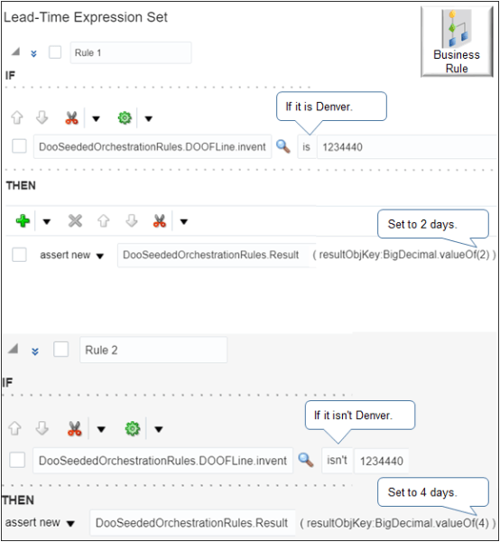

Assume your lead time to ship the item varies depending on where the inventory organization is located, so you implement these business rules:
  • If the inventory organization is in Denver, then use a two day lead time
  • If the inventory organization isn't in Denver, then use a four day lead time
Here are the rules you will create:
the rules you will create.
Summary of the Steps
  1. Create the If statement for the first rule.
  2. Create the Then statement for the first rule.
  3. Create the If statement for the second rule.
  4. Create the Then statement for the second rule.

  5. In the Lead-Time Expression column, click Click for Rule.
  6. In the Lead-Time Expression dialog, click Add Rule > Expand.
    If you write a rule for an orchestration process that orchestrates more than one order line, then use Advanced Mode. However, this example treats all order lines in the same way, so Advanced Mode isn't required. To use Advanced Mode, you would click Properties, add a check mark to Advanced Mode, then edit the rule.
  7. In the If area, click Left Value.
  8. In the Condition Browser, expand DOOSeededOrchestrationRules > DOOFline, click InventoryOrganizationId, then click OK.
    DOOFline is an abbreviation for Distributed Order Orchestration Fulfillment line. Oracle replaced the name Distributed Order Orchestration with the name Order Management in an earlier update. Some rules still use the old name.
  9. In the Right Value attribute, enter 1234440.
    Assume 1234440 is the inventory organization ID for Denver.

  1. In the Then area, click Add Action > Assert New.
  2. Click Select a Target > DooSeededOrchestrationRules.Result.
  3. Click Edit Properties.
  4. In the Edit Properties dialog, in the ResultObjKey row, enter the value, then click OK:
    Attribute
    Value
    Value
    BigDecimal.valueOf(2)

  1. In the Lead-Time Expression dialog, in the Lead-Time Expression Set area, click Add Rule.
  2. In the lower part of the dialog, in the Rule 2 area, click Expand.
  3. In the If area of Rule 2, click Left Value, expand DOOSeededOrchestrationRules > DOOFline, select InventoryOrganizationId, then click OK.
    Tip:
    In some attributes, you can copy the value from one attribute to another instead of using the drop-down list. For example, you can copy DooSeededOrchestrationRules.DOOFLine.inventoryOrganizationId from Left Value of the first rule, then paste it into Left Value of the second rule.
  4. Click the down arrow for the operator, then click isn't.
  5. In the Right Value attribute, enter 1234440.

  1. In the Then area for Rule 2, click Add Action > Assert New.
  4. In the Edit Properties dialog, in the ResultObjKey row, enter the value:
    Attribute
    Value
    Value
    BigDecimal.valueOf(4)
  5. Click OK > Save.
