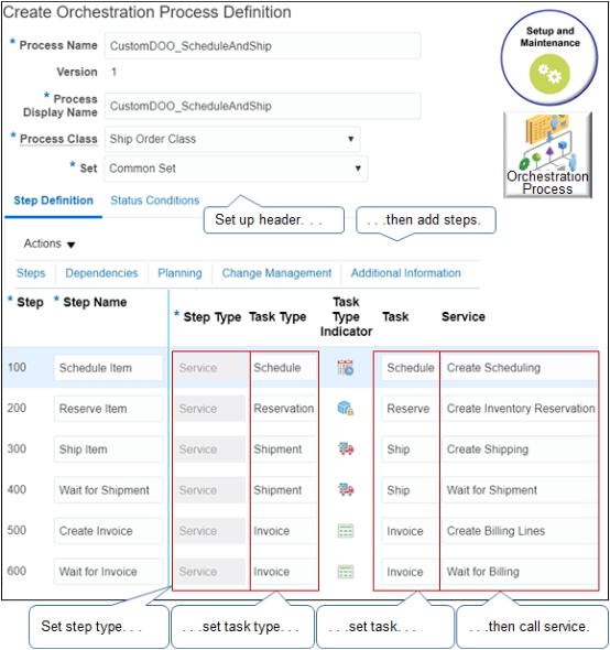

Create the Orchestration Process
  1. Go to the Setup and Maintenance work area, then go to the Manage Orchestration Process Definitions task.
  2. On the Manage Orchestration Process Definitions page, click Actions > Create.
  3. On the Create Orchestration Process Definition page, set the values, then click Save:
    Attribute
    Value
    Process Name
    CustomDOO_ScheduleAndShip
    The set up page automatically adds the CustomDOO_ prefix. You must use this prefix for any orchestration process you create.
    The name must not exceed 80 characters, including the prefix.
    Process Display Name
    Enter any value. Don't include spaces. The value you that enter will display throughout the Setup and Maintenance work area and the Order Management work area.
    Process Class
    Ship Order Class
    An orchestration process class contains a set of statuses that you can assign to the orchestration process.
    Select a class that includes the statuses you need for the orchestration process.
    Set
    Common Set
    Note
    • A set is a collection of business units. Use it to organize business units and control the business units that can access an orchestration process.
    • Select the set that allows the business unit to access the orchestration process.
    • Use the predefined Common Set to provide access to many business units.
    • You must add your business unit to the set you specify.
Add the Orchestration Process Steps
  1. On the Step Definition tab, click Actions > Add Row.
  2. Set the values, then click Save:
    Attribute
    Description
    Step Name
    Enter text that describes the purpose of the step. For this example, enter Schedule Product.
    Step Type
    Select a value that indicates the type of processing that this step does.
    For example, if this step must do conditional branching, then select Conditional. This example calls a service, so select Service.
    Task Type
    Select the group of services that Order Management uses to do a fulfillment task. For this example, select Schedule.
    Task
    Select the task that this step must perform. For this example, select Schedule.
    Service
    Identify the service that this step must call. For this example, select Create Scheduling.
  3. Repeat steps 1 and 2. Use these values:
    Attribute
    Value
    Step Name
    Reserve Product
    Step Type
    Service
    Task Type
    Reservation
    Task
    Reserve
    Service
    Create Inventory Reservation
    Tip:
    To maintain the correct sequence when you add each step, click the step that you most recently added, then click Add Row. To make sure you don't lose any work, click Save after you add each step.
  4. Repeat steps 1 and 2. Use these values:
    Attribute
    Value
    Step Name
    Ship Product
    Step Type
    Service
    Task Type
    Shipment
    Task
    Ship
    Service
    Create Shipping
  5. Repeat steps 1 and 2. Use these values:
    Attribute
    Value
    Step Name
    Wait for Product Shipment
    Step Type
    Service
    Task Type
    Shipment
    Task
    Ship
    Service
    Wait for Shipment
    Exit Criteria
    Shipped
    Note that you also specify the exit criteria in this step.
  6. Repeat steps 1 and 2. Use these values:
    Attribute
    Value
    Step Name
    Create Invoice
    Step Type
    Service
    Task Type
    Invoice
    Task
    Invoice
    Service
    Create Billing Lines
  7. Repeat steps 1 and 2. Use these values:
    Attribute
    Value
    Step Name
    Wait for Invoice
    Step Type
    Service
    Task Type
    Invoice
    Task
    Invoice
    Service
