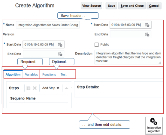

Create Algorithm
screen print of integration algorithm.
Note
  • When you create the algorithm, save the header before you work on details.
  • You must set up the algorithm and variables.
  • Functions are optional.
  • Test is a design time test. It isn't a run time test. It's optional, but we recommend it.

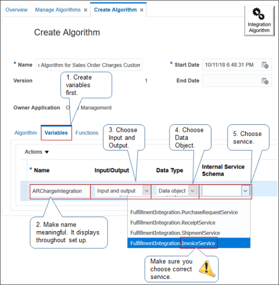

Use Variables
define variable for integration algorithm.
Note
  • Create and save the header first, and then set up the variables. Don't set up the algorithm yet because you use variables in the algorithm. You must set up the variables first.
  • Click Variables.
  • Set attributes:
    Attribute
    Value
    Name
    Enter a meaningful name because the value you enter will display throughout the set up.
    Input/Output
    Select Input and Output.
    Data Type
    Select Data Object.
    Internal Service Schema
    Use FulfillmentIntegration.YourService
    where
    • YourService specifies the service that your integration requires.
    This example uses FulfillmentIntegration.InvoiceService
    Caution:
    Its important to select the correct service. If you select the wrong service, the integration will fail.

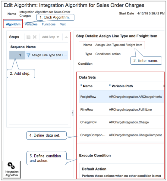

Add Step
add step to integration algorithm.
Note
  1. Click Algorithm.
  2. Add steps. At run time, the algorithm runs the steps sequentially.
  3. Enter a name.
  4. Set up the data set that determines which records to process in this step.
  5. Set up the condition and action that determines how to process records.

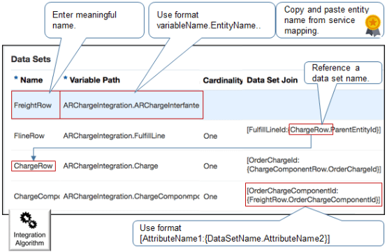

Create Data Set
Create your Data Set.
Specify the attributes:
Attribute
Description
Name
Enter a meaningful name. Algorithm logic will reference it.
Variable Path
Use the VariableName.entity format.
where
  • VariableName. Name of the variable you defined on the Variables tab, such as ARChargeIntegration.
  • Entity. Copy and paste the entity name from your service mapping.
Cardinality
For descriptive flexfield, you typically select Zero or One.
If you join many order lines to one order header, then select Many.
Data Set Join
Use format [AttributeName1:{DataSetName.AttributeName2}]
where
  • AttributeName1. Name of an attribute in the data set you're joining to.
  • DataSetName. Name of a data set you have defined.
  • AttributeName2. Name of an attribute in DataSetName.

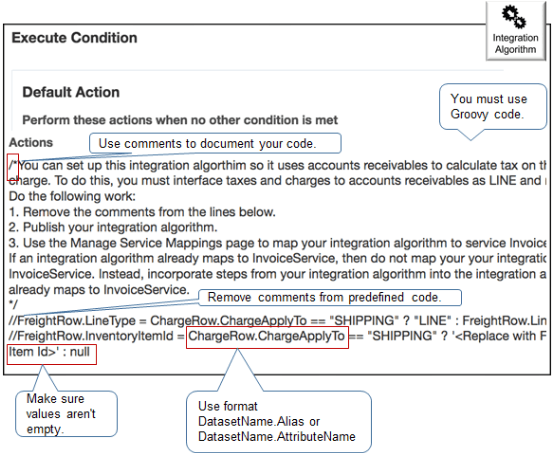

Specify Condition and Action
Define Condition and Action.
Note
  • The algorithm runs the default action when algorithm logic doesn't meet any other conditions.
  • This predefined action interfaces freight charges as a separate line item on the invoice.
  • Predefined code is commented. Remove comments to enable the action.
  • Write your code in Groovy script.
  • Use comments to document your code.
  • Make sure the variable isn't empty before you use it as the source for a value. In particular, make sure your extensible flexfield contains a value. If it doesn't contain a value, then you can't get a value from it, and your algorithm might fail.
  • Use format DatasetName.Alias.
    where
    • DatasetName. Name of the data set that you defined in the integration algorithm.
    • Alias. Alias or attribute name that you defined in your service mapping.
      For example, ChargeRow.ChargeApplyTo.
For details, including the exact content of the Actions that this example uses, see Overview of Integrating Order Management with Oracle Receivables.

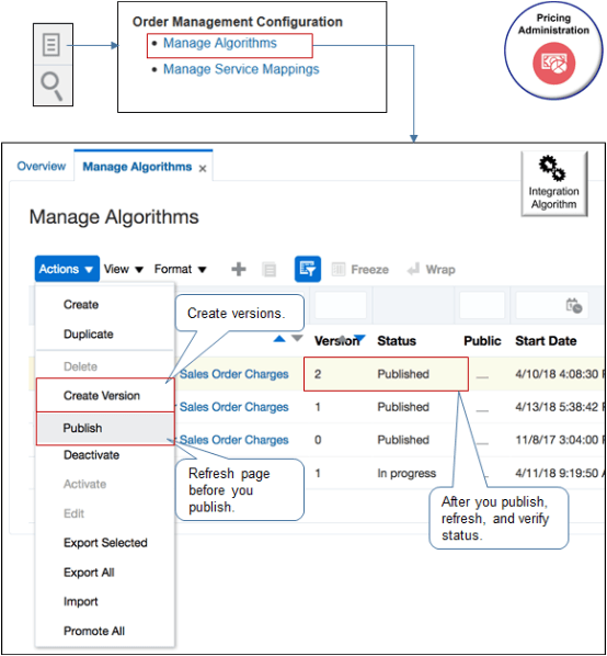

Publish and Test
Publish your algorithm:
Note
  • . Go to the Pricing Administration work area.
  • Click Tasks, then under Order Management Configuration, click Manage Algorithms.
  • Create different versions so you can test different set ups while maintaining a working copy.
  • You must publish your algorithm.
  • Before you publish, refresh the page: save, close the page, open the page, and requery algorithms.
  • After you publish, refresh, and verify that the status is Published.
  • You can't edit a published algorithm. You must create a new version instead, or deactivate, and then activate.

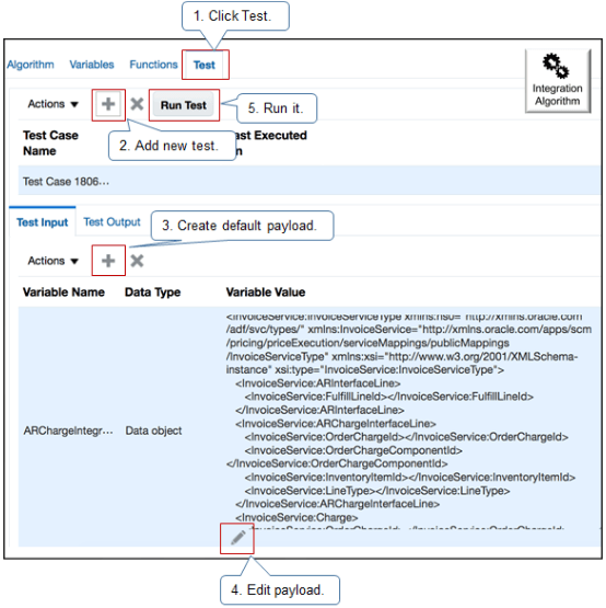

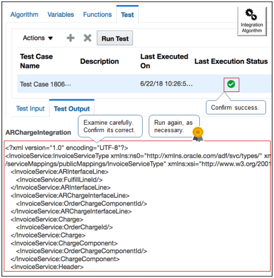

Test your algorithm:
Test Your Algorithm.
Note
  1. Click Test to run a design time test.
  2. Add a new test.
  3. Create a default payload. The test creates a default payload according to the structure you set up in the integration algorithm.
  4. Edit the payload so it meets your requirements. For example, add values for important attributes that you know your fulfillment system expects.
  5. Click Run Test.
  6. Examine the results:
    Examine your test Results.
    Note
    • Notice value of Last Execution Status. Green check mark means success.
    • Examine test output carefully. Make sure output not only exists, but that it contains values you expect from your integration. For example, if you logic concatenates an item description, then make sure the test displays concatenated values that you expect.
    • If you modify logic or a data set, then delete your test data, recreate test data, and run test again.
    • You must submit your test sales orders from the same sandbox that you use for your service mapping. An integration algorithm doesn't require a sandbox but a service mapping does.
    • Test the business unit that you use to submit the sales order.
    • Verify attribute values throughout the sales order lifecycle, including before you submit it up through the point where the sales order is closed.
