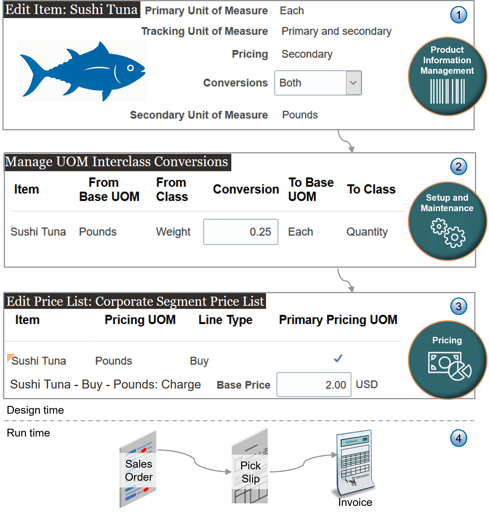

Create the item.
Manage the conversion.
Set up pricing.
Test your work.

Create the Item
Go to Home > Product Management > Product Management > Tasks > Create Item.
You must create a new item. You can't add dual measures to an item that already exists.
In the Create Item dialog, set the values:
Attribute
Value
Organization
Fresh Fish 4 U
Create New
Enabled
Number of Items
1
Item Class
Root Item Class
Make sure the Selected List window contains only Finished Goods, then click OK.
On the Create Item page, set the values:
Attribute
Value
Item
Sushi Tuna
Description
The world's tastiest tuna. Remember, you can tune a piano, but you can't tune a fish.
Primary Unit of Measure
Each
Specify the unit of measure that you use to stock and sell and the item.
Tracking Unit of Measure
Primary and Secondary
Specify how to track your on-hand balance.
If you set it to Primary and Secondary, then you're telling Order Management that this item is a dual measure item.
Pricing
For this example, choose Secondary.
See Price Dual Measures.
Conversions
Both
Secondary Unit of Measure
Pounds
Specifies the measure that you use to price the item.
Defaulting Control
Choose a value:
Default. Use when your item's secondary measure might change at run time.
Fixed. Use when your item's secondary measure won't change at run time.
You can't change some of the values that you set in the Unit of Measure area after you save, so make sure you set them correctly.
Click Specifications > Manufacturing, then set the value:
Attribute
Value
Structure Item Type
Standard
You must use Standard.
Click Sales and Order Management, then set the values:
Attribute
Value
Sales Product Type
Goods
You must use Goods or leave it empty.
Shippable
Yes
Can be Yes or No.
Invoiced
Yes
Invoice Enabled
Yes
Click Save > Save and Close.

Manage the Conversion
You must set up a conversion between the item's primary measure and its secondary measure. You can use the standard conversion for many items or you can set up a conversion only for the item. In this example you set up a conversion for the item:
1 Pound equals 0.25 Each. If you order 1 Each of Sushi Tuna, then the value in the secondary Pounds measure is 4.
Try it:
Go to Home > My Enterprise > Setup and Maintenance > Tasks > Search > Manage Units of Measure for Interclass Conversion.
In this example you convert between a measure that's in the Weight class and another that's in the Quantity class, so you create an interclass conversion. If your measures are in the same class, then use the Manage Units of Measure for Intraclass Conversion task.
On the Manage UOM Interclass Conversions page, click Change Organization, set the value, then click OK:
Attribute
Value
Organization
Fresh Fish 4 U
Click Actions > Add, set the values, then click Save and Close:
Attribute
Value
Item
Sushi Tuna
From Base UOM
Pounds
From Class
Weight
Conversion
0.25
You sell the Bullet Tuna species. Assume each of these tuna averages about 4 pounds each.
To Base UOM
Each
To Class
Quantity
Set up a standard conversion.
Assume you package fish in a case, one case contains 3 tuna, so you also need to set up a rule that converts case to each:
Go to Tasks > Search > Manage Units of Measure.
On the Manage Units of Measure page, click Actions > Add, set the values, then click Save:
Attribute
Value
UOM Code
CS3
UOM Name
Case of 3
Description
Case of 3
Class Name
Quantity
Base UOM Name
Each
Click Manage UOM Standard Conversions.
On the Manage UOM Standard Conversions page, click Actions > Add, set the values, then click Save and Close:
Attribute
Value
UOM Name
Case of 3
Conversion
3
Base UOM Name
Each
Class Name
Quantity
Set Up Pricing
Assume you use the Corporate Segment Price List, and the sale price for tuna on the commercial market is about $2 a pound
You specify the Pounds measure as the primary. This way, pricing will price it by the pound, not by each. You specify 2.00 USD as the base price, so you charge $2 for each pound of tuna:
Go to Home > Order Management > Pricing Administration > Price Lists.
Search for and open the Corporate Segment Price List.
Click Actions > Add Row, set the values, then click Save:
Attribute
Value
Item
Sushi Tuna
Pricing UOM
Pounds
Line Type
Buy
Primary Pricing UOM
Selected.
Enabling this option tells Pricing to use the value that you set in the Pricing UOM attribute to price the item.
Don't confuse the Primary Pricing UOM attribute with the Primary Unit of Measure attribute that you set for the item in Product Management. The Primary Pricing UOM attribute is specifically for pricing, not for the item.
Click Create Charge, set the values, then click Save and Close:
Attribute
Value
Pricing Charge Definition
Sale Price
Calculation Method
Price
Base Price
2
Allow Manual Adjustment
Selected.
Market conditions probably vary every day, so let your users adjust the price manually.
See Manage Price Lists.

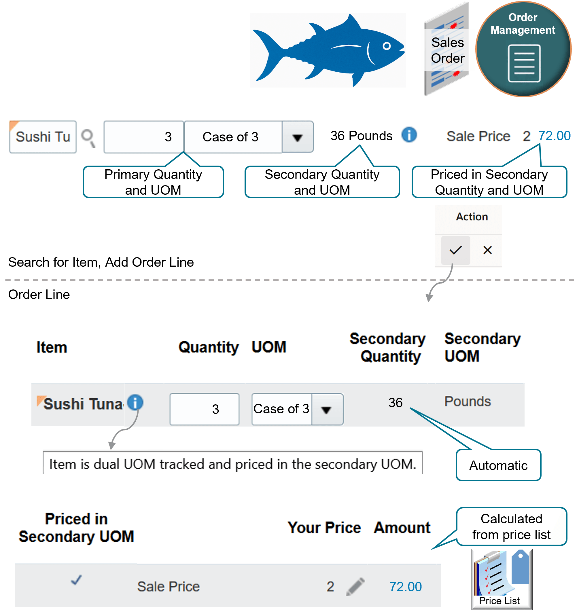

Test Your Work
Go to the Order Management work area and create a sales order:
Attribute
Value
Customer
Fancy Fish
Business Unit
Fresh Fish 4 U
Search for and add the Sushi Tuna item on the order line:
Note
You use the order line to search for the item. It displays the quantity and price for the primary measure and the secondary measure.
You can't change the secondary quantity or secondary measure on the order line, but you can change the primary quantity and Order Management will automatically calculate the secondary quantity and the amount.
The order line sets the unit of measure to the primary, by default. It also displays primary and secondary attributes which makes it easy to see the conversion.
Assume you change the Quantity to 3 and the UOM attribute to Case of 3:
Attribute
Value
Quantity
3
This is the primary quantity.
UOM
Case of 3
The primary measure of the item is Each. You can change it to any measure that's in the primary measure's class, such as Case of 3.
Secondary Quantity
36
The order line uses your conversion rules to automatically calculate the secondary quantity:
1 case contains 3 tuna.
1 tuna equals 4 pounds.
3 tuna multiplied by 4 pounds means each case weighs 12 pounds.
12 pounds for each case multiplied by the primary quantity of 3 equals a secondary quantity of 36.
Secondary UOM
Pounds
Sale Price
2
Line Price
72.00
Its the secondary quantity of 36 pounds multiplied by the unit price of 2 equals 72.00.
Information Icon
Let's you know that you're using dual measures for this item.
Click Add, then notice that the sales order adds the values that you set on the order line. Here are a few more details you should take note of:
Attribute
Value
Item
Contains your dual measure item.
Priced in Secondary UOM
Contains a value:
Selected. Pricing priced the order line according to the value in the Secondary UOM attribute on the order line. In this example, that would be Pounds.
Not Selected. Pricing priced the order line according to the value in the UOM attribute on the order line. In this example, that would be Each.
Order Management gets this value from the Pricing attribute that you set in Product Management.
Submit:
The orchestration process schedules and reserves the item just like it does any other sales order. It schedules the order according to the order line's Quantity attribute and UOM attribute.
The secondary measure and the secondary quantity doesn't affect scheduling.
