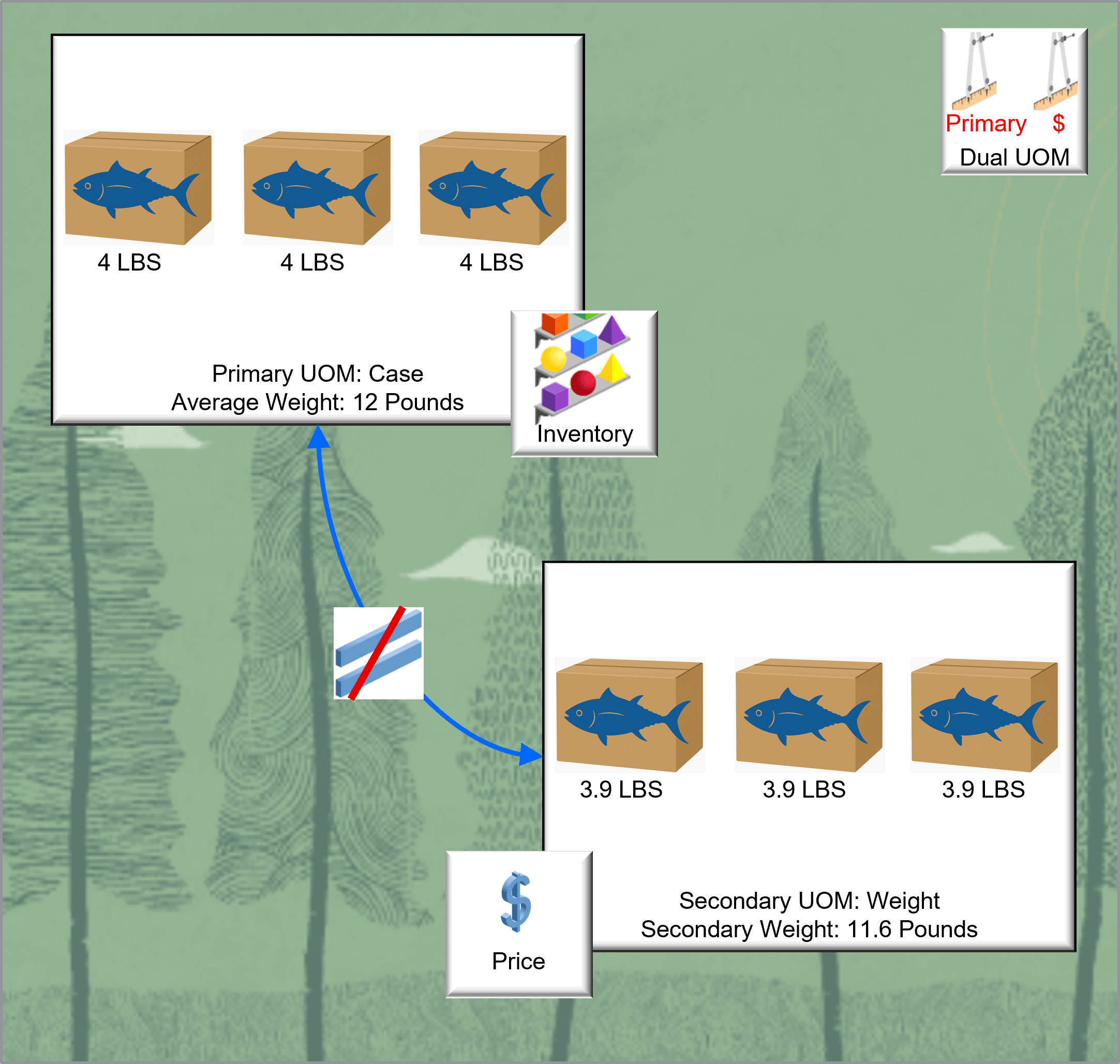

Example
xxxxxxxxxxxxxxxxxxxxxxxxxxxxxxxxxxx
Note
  • Weight for each fish is approximate because it naturally varies in size. 10 different fish will each sell for a different amount because each one has a unique weight. You might need to use the primary Case measure to stock your fish in inventory, but use the secondary Pounds measure to price it.
  • A case of fish weighs an average of 12 pounds, and that's how you stock it.
  • The actual weight just before you ship is 11.6 pounds, and that's the price you charge your customer.
