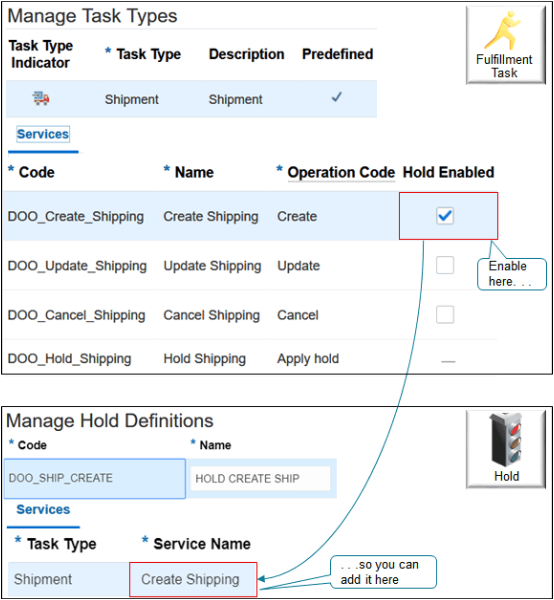

If you create your own task type that references the service, then you must set up the task type so it supports the hold:
If you create your own task type that references the service, then you must set up the task type so it supports the hold.
Assume you create your own task type and name it My Shipment. You want to allow the Order Entry Specialist to place the sales order on hold when the order reaches the orchestration process step that references the My Shipment task type:

  3. Click the row that contains My Shipment in the Task Type column.
  4. Click Services.
    Notice that the Manage Task Types page automatically adds a create service and enables it for holds:

  5. Add a service that applies the hold and another one that releases the hold.
