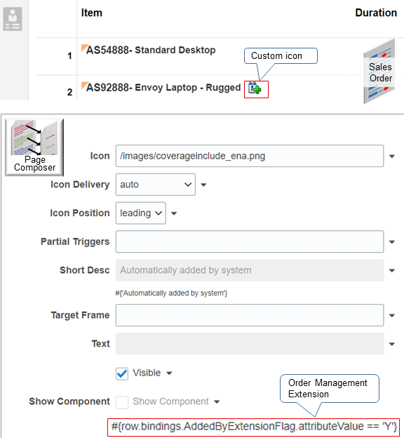

Display an Icon
Assume you have an icon name coverageinclude_ena.png, and you want to display it as part of the item. You can use an order management extension in Page Composer to add it:
