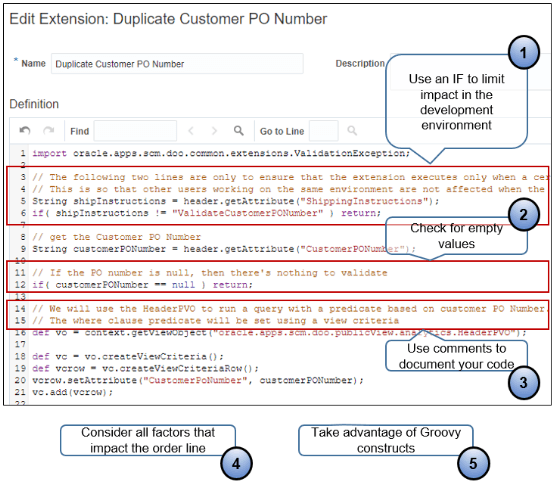

  1. Use an IF. Avoid writing code that runs in every condition in your development environment. Instead, use an IF statement so your code runs only in your specific use case.
    Assume you write a statement that runs every time the extension point happens, without conditional logic, but the extension contains an error. The extension might cause every sales order in your development environment to fail in every situation, regardless of the condition you must test. This situation might negatively affect other developers, and also make it more difficult for you to manage each of your own extensions.
    For example, assume you write an extension that manipulates the shipInstructions attribute. You can add this statement as the first statement in your extension so your code runs only for your use case.
    if (shipInstructions != "ValidateCustomerPONumber" ) return;
    If the statement evaluates to true, then no more logic in your extension runs. Instead, the flow exits your extension.
    Remove the IF after you test your extension and are ready to deploy into production.
  2. Check for empty values. Avoid a null pointer exception. Use an IF statement that makes sure each attribute you reference contains a value. If it doesn't, then return flow out of the extension.
  3. Add comments. Add detailed comments that document each part of your code so you know exactly the logic that each statement implements. Comments help others to understand the intent of your code, and also help you to troubleshoot large complex code, or code that you haven't examined for a long period of time.

  • If your extension does an action only on a new sales order or only on a revision, then add a condition that determines whether the sales order you're modifying is new or is a revision right at the beginning of your extension. This way, if the condition evaluates to false, you can exit the extension immediately without having to evaluate the rest of the extension code.
    Consider all factors that impact the order line, such as configured items, kits, or ship sets.
  • Take advantage of Groovy constructs, such as simplified array usage and initializing maps.

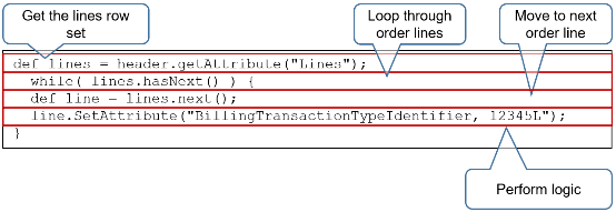

Navigate Row Sets
Order Management returns each child entity as a set of rows. For example, an order line is a child of a sales order. This example illustrates how you can use while next to loop through each row, an order line, from the set, which is the sales order:
code that loops through each row
Here's the same code with descriptions:
Code
Description
def lines = header.getAttribute("Lines");
Call the getAttribute method on the order header to access the row set iterator for the order lines.
while( lines.hasNext() ) {
Determine whether the lines row set includes a next row, and loop until the row set doesn't contain any more rows.
def line = lines.next();
Get the next order line row:
  • On the first loop through the while, move from line 1 to line 2.
  • On the second loop through the while, move from line 2 to line 3.
  • And so on.
line.SetAttribute("BillingTransactionTypeIdentifier, 12345L");
Set the value of the billing transaction type on the order line to 12345L.
For brevity, this example hard codes the value 12345L. In most situations, its more likely you would specify a variable or some other logic rather than hard code the value.

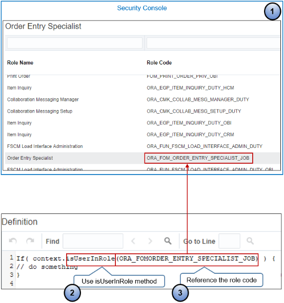

Secure Your Extension
Write logic according to the job role. For example, write an extension that prevents an action or that sets default values on the sales order according to the job role that the Order Entry Specialist uses when signing into Order Management. This example references ORA_FOM_ORDER_ENTRY_SPECIALIST_JOB, which is the code for the Order Entry Specialist job role.
This topic uses predefined job roles. You must create your own job roles, depending on your security requirements.
For details about how to set up privileges, see Security Reference for Order Management:
how to job role ORA_FOM_ORDER_ENTRY_SPECIALIST_JOB
Note
  1. Use the Security Console to get details about the job roles and role code that your extension must reference. For details, see Overview of Security Console in Oracle ERP Cloud, Securing ERP.
  2. Use the isUserInRole method.
  3. In the first parameter for isUserInRole, reference the role code that the security console defines.
