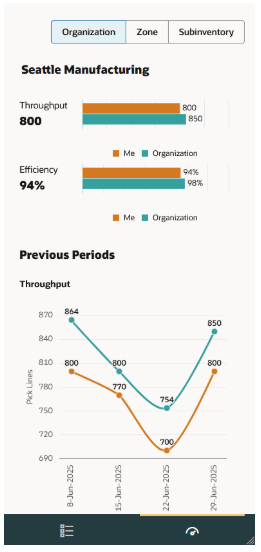

    My Performance page
    From here, you can:
    • View your throughput and efficiency, and compare them to organizational averages.
    • Track your performance trends for the last 4 periods.

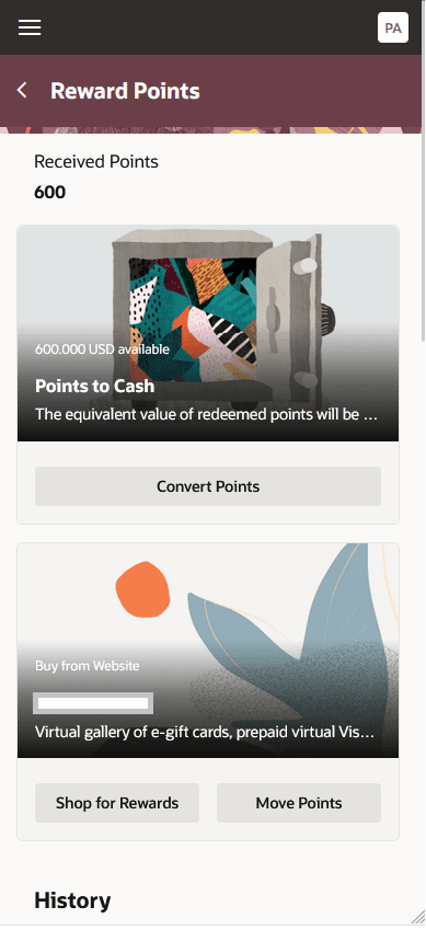

    • Navigate to the Oracle Celebrate page to view and redeem your rewards.
    Oracle Celebrate Rewards
