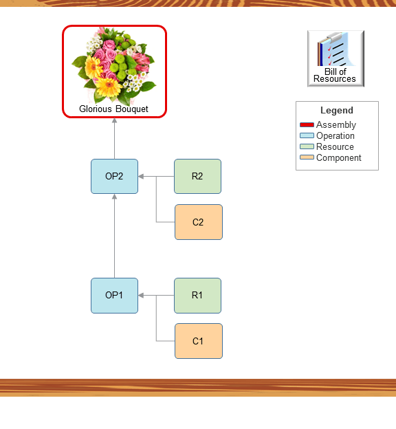

Assume your bill of resources has this hierarchy:
Assume:
  • The Create Bills of Resources scheduled process uses this hierarchy. Promising considers only the resources and components. It doesn't consider the operations.

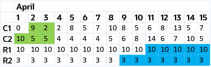

Consider this availability:
consider this availability
where
  • Green is component consumption.
  • Blue is resource consumption.
  • Available quantities are cumulative, counting in reverse. For example, a quantity of 20 is available on April 3 for C2 (5 on April 3, plus 5 on April 2, plus 10 on April 1).
Promising determines those consumption dates:
  1. Sets the requested date to April 15.
  2. Sets manufacturing's end date to April 15, which is the due date minus the bouquet's postprocessing lead time.
  3. Determines manufacturing's start date. Promising starts at April 15 and works backward to find the earliest manufacturing start date that it can use and still meet the lead time requirements for the components and resources:
    • Identifies the component or resource that has the largest lead time. C2 has the largest lead time, which is 12 days.
    • Sets manufacturing's start date to April 3 (April 15 minus C2's 12 day lead time).
    • Makes sure components are available on April 3. Manufacturing needs a quantity of 10 for C1 and a quantity of 20 for C2. In this example, a cumulative quantity of 11 is available for C1 on April 3, and a quantity of 20 is available for C2, so we're good to go.
    • Makes sure resources are available from April 3 through April 15. Manufacturing needs 50 hours of R1, and 20 hours of R2. Resource lead times are zero, and the end date to consume resources is April 15. R1 has 130 hours available on April 15, and R2 has 39 hours available, so there's enough cumulative resource hours available on April 15 to meet demand.
    • If Promising found that manufacturing didn't have the quantity it needed for each component and resource, then it would use the next day as manufacturing's end date, and try again.
  4. Finalizes the result:
    Attribute Day
    Manufacturing Start Date April 3
    Manufacturing End Date April 15
    C1 and C2 Start Date April 3
    R1 Start Date April 11
    R2 Start Date April 9
    R1 End Date and R2 End Date April 15
    Scheduled Ship Date April 15 (on time)

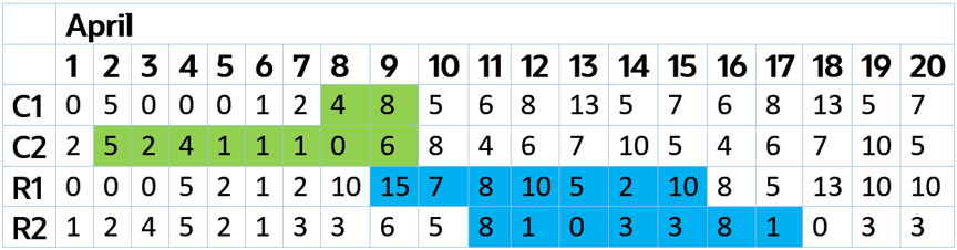

  3. Determines manufacturing's start date. Promising starts at April 15 and works backward to find the earliest manufacturing start date that it can use to meet the lead time requirements for the components and resources:
    • Identifies the component or resource that has the largest lead time. R1 has the largest lead time, which is 13 days.
    • Sets manufacturing's start date to April 2 (April 15 minus R1's 13 day lead time).
    • Makes sure components and resources are available on April 2. Manufacturing needs a quantity of 10 for C1. However, C1 only has a cumulative quantity of 9 on April 2, so Promising moves on to the next day and tries again.
    • In the next iteration, Promising sets manufacturing's end date to April 18 and R1's end date to April 5 (April 18 minus R1's 13 day lead time). R1 has enough capacity to meet the required 50 hours of demand, and Promising calculates R1's start date as April 1. However, C1 has 0 quantity and C2 only has a quantity of 10 on April 1, so Promising discards the results and moves on to the next day.
    • Promising iterates through this process until it finds a date that meets manufacturing's demand for components and resources. For each iteration, it applies the lead times and checks availability for each component and resource to see whether it can meet demand for manufacturing's end date and start date.
  4. After a few more iterations, Promising:
    • Sets manufacturing's end date to April 20.
    • Sets R1's end date to April 7 (April 20 minus R1's 13 day lead time), and R1's start date to April 3.
    • Sets R2's end date to April 11 (April 20 minus R2's 9 day lead time).
    • Confirms that C1 and C2 both have enough quantity on April 3 to start production, so it finalizes the result:
      Attribute Day
      Manufacturing End Date April 20
      C1 Start Date and C2 Start Date April 3
      R1 Start Date April 3
      R1 End Date April 7
      R2 Start Date April 5
      R2 End Date April 11
      Scheduled Ship Date April 20 (5 day delay)

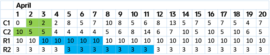

  1. Sets the requested date to April 10.
  2. Sets manufacturing's end date to April 10, which is the due date minus the bouquet's postprocessing lead time.
  3. Determines manufacturing's start date. Promising starts at April 10 and works backward to find the earliest manufacturing start date that it can use to meet the lead time requirements for the components and resources:
    • Identifies the component or resource that has the largest lead time. R1 has the largest lead time, which is 5 days.
    • Sets manufacturing's start date to April 5 (April 10 minus R1's 5 day lead time).
    • Makes sure components and resources are available on April 5. Manufacturing needs 50 hours of R1, and 20 hours of R2. However, R1 only has a cumulative quantity of 7 hours on April 5, and R2 only has a cumulative quantity of 14 hours on April 5, so Promising moves on to the next day and tries again.
    • Iterates through this process. Eventually, Promising sets manufacturing's end date to April 16, which results in manufacturing's start date of April 11, and an R1 start date of April 4. Resources are available on April 4 but components aren't. Manufacturing needs a quantity of 10 for C1 and 20 for C2. However, C1 only has a cumulative quantity of 5 on April 4, and C2 only has a quantity of 12, so Promising continues to iterate the process.
    • After a few more iterations, Promising sets manufacturing's end date to April 20, which results in manufacturing's start date of April 15, and an R1 start date of April 9. C2's start date on April 9 has enough quantity to meet demand. All the components and resources that manufacturing needs are available, this iteration meets the lead time requirements, so Promising finalizes the result:
      Attribute Day
      Manufacturing Start Date April 9
      C1 and C2 Start Date April 9
      R1 Start Date April 9
      R1 End Date April 15
      R2 Start Date April 11
      R2 End Date April 17
      Scheduled Ship Date April 20 (10 day delay)
