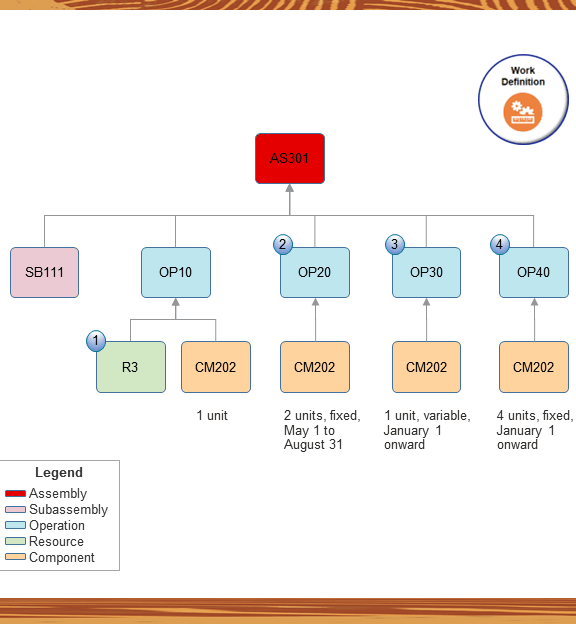

This example will you give you a work definition with this hierarchy after you finish collecting data:
Note
- The R3 resource will do the OP10 operation to build a quantity of 1 SB111 subassembly, and a quantity of 1 CM202 component.
- If demand happens from May 1 to August 31, then the OP20 operation will add a quantity of 2 CM202 components to the AS301 assembly.
- If demand happens on or after January 1, then the OP30 operation will add a quantity of 1 CM202 component to the AS301 assembly.
- If demand happens on or after January 1, then the OP40 operation will add a quantity of 4 CM202 components to the AS301 assembly.
This sequence builds the AS301 assembly. Promising will use a similar sequence to specify promising for the SB111.

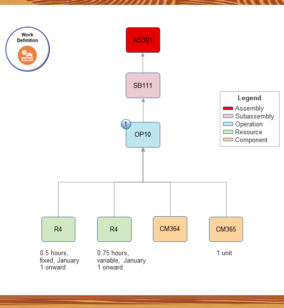

Same Resource, Different Quantity or Basis
Assume you create this work definition:
| Row | Assembly | Component or Resource | Operation Sequence | Quantity | Basis | Effective Dates |
| 1 | AS301 | SB111 | 10 | 1 | Variable | January 1 |
| 2 | - | CM201 | 10 | 1 | Variable | January 1 |
| 3 | - | CM202 | 30 | 1 | Variable | January 1 |
| 4 | - | R3 | 10 | 0.5 | Variable | January 1 |
| 5 | SB111 | CM364 | 10 | 1 | Variable | January 1 |
| 6 | - | CM365 | 10 | 1 | Variable | January 1 |
| 7 | - | R4 | 10 | 0.5 | Fixed | January 1 |
| 8 | - | R4 | 10 | .75 | Variable | January 1 |
The work definition has more than one instance of the R4 resource. Each instance has the same operation but different quantities and bases.
Assume you run the Create Bills of Resources scheduled process on January 1. It will create this bill of resources:
| Row | Assembly | Component or Resource | Quantity | Basis | Effective Dates |
| 1 | AS301 | SB111 | 1 | Variable | January 1 |
| 2 | - | CM201 | 1 | Variable | January 1 |
| 3 | - | CM202 | 1 | Variable | January 1 |
| 4 | - | R3 | 0.5 | Variable | January 1 |
| 5 | SB111 | CM364 | 1 | Variable | January 1 |
| 6 | - | CM365 | 1 | Variable | January 1 |
| 7 | - | R4 | 0.5 | Fixed | January 1 |
| 8 | - | R4 | 0.75 | Variable | January 1 |
For brevity, let's focus on how Promising promises the R4. Both instances of the R4 go into effect on January 1 with no end date, so Promising will always consume a total quantity of 1.25:
- Quantity of 0.5 from row 7, plus
- Quantity of 0.75 from row 8
Note
- R4 will take 0.5 hours to complete the OP10 operation.
- R4 will take 0.75 hours to complete the OP10 operation.

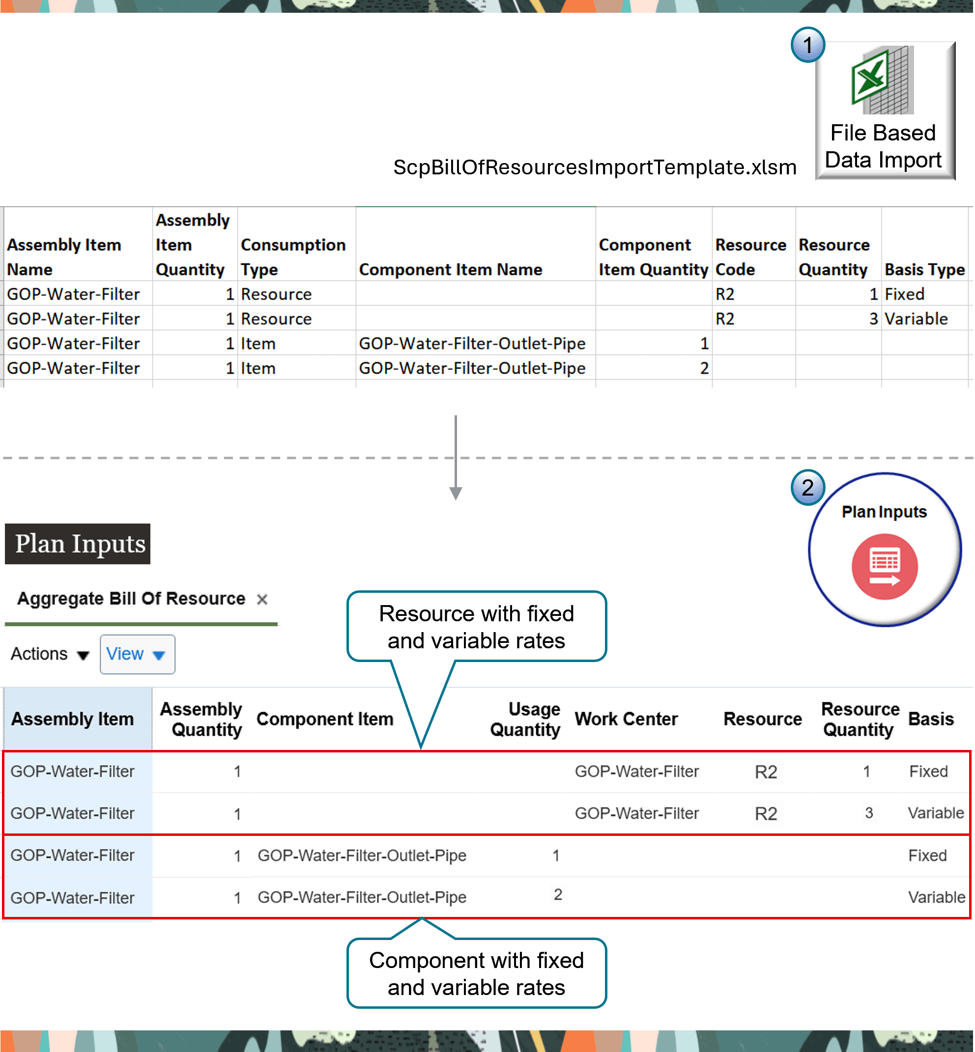

Import Your Data
You can collect values from a work definition in Oracle Manufacturing and use them to specify the types and rates of consumption for each manufacturing operation. You can also import them through file-based data import (FBDI) instead.
Note
- Use the Supply Chain Planning Bill of Resources FBDI
(ScpBillOfResourcesImportTemplate.xlsm) template to import your bill of
resources:
- Use the Basis Type column to indicate whether the resource's quantity or the component's quantity is fixed or variable. You can include more than one row that has the same component or resource, and you can set the basis differently on each row.
- You can use FBDI to import your data regardless of whether or not you use Oracle Manufacturing.
- Use the Plan Inputs work area to view your uploaded data.
Try It
Assume you need to import the GOP-Water-Filter assembly item:
- Use FBDI to upload your data.
- Go to the Plan Inputs work area.
- Click Open, select Aggregate Bill of Resources, then click OK.
- Search for the value:
Attribute Value Assembly Item GOP-Water-Filter - Verify that the search results includes your imported data.
