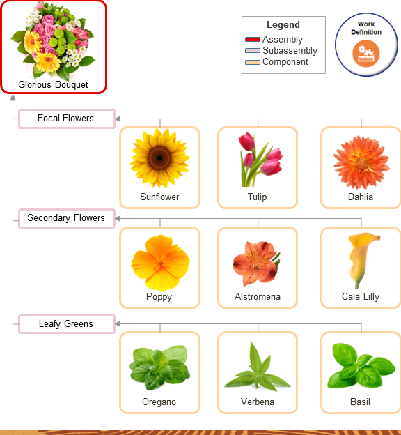

Assume you sell an item named Glorious Bouquet, which is a bouquet of flowers. Your customers have very discerning tastes about what flowers they want to see in various parts of the bouquet, at different times of the year. Some types of flowers are always available and your customers always want them, regardless of season, so you consider them to be fixed. However, other flowers come and go with the season, so you view them as variable.
Assume your work definition has this hierarchy:
where
- Glorious Bouquet is your top level assembly.
- Focal Flowers, Secondary Flowers, and Leafy Greens are subassemblies.
- Sunflower, Tulip, Dahlia, California Poppy, Alstroemeria, Cala Lilly, Oregano, Verbena, and Basil are components.

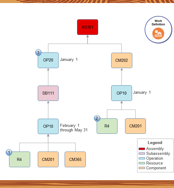

Now let's assume your work definition has a slightly different hierarchy:
M1
AS301
CM201
CM202
R3
R4
SB111
CM201
CM365
R4
Assume you have these values:
| Assembly | Component or Resource | Operation Sequence | Quantity | Basis | Effective Date |
| AS301 | CM202 | 10 | 1 | Variable | January 1 |
| - | CM201 | 10 | 1 | Variable | January 1 |
| - | R4 | 10 | 0.5 | Variable | January 1 |
| - | SB111 | 20 | 1 | Variable | January 1 |
| - | R3 | 20 | 0.5 | Variable | January 1 |
| SB111 | CM201 | 10 | 1 | Variable | February 1 through May 31 |
| - | CM365 | 10 | 1 | Variable | February 1 through May 31 |
| - | R4 | 10 | 0.5 | Variable | February 1 through May 31 |
Assume:
- All components and resources are critical except for SB111 and R3.
- The AS301 and SB111 both use the same CM201 component and the same R4 resource.
- The CM201 goes into effect on January 1 with no end date, and the R4's date range is February 1 through May 31, so the dates for CM201 and R4 overlap each other.
Assume you run the Create Bills of Resources scheduled process on January 1, and it creates this bill of resources:
| Assembly | Component or Resource | Quantity | Effective Date |
| AS301 | CM202 | 1 | January 1 |
| - | CM201 | 1 | January 1 |
| - | CM201 | 1 | February 1 through May 31 |
| - | R4 | 0.5 | January 1 |
| - | CM365 | 1 | February 1 through May 31 |
| - | R4 | 0.5 | February 1 through May 31 |
The scheduled process will roll up child SB111's components, resources, and dates to the parent AS301 in the bill of resources.
If demand for the CM202 component happens:
- February 1 through May 31, Promising will consume a quantity of 2
- January 1 through January 31, or on or after June 1, Promising will consume a quantity of 1
If demand for the R4 resource happens:
- February 1 through May 31, Promising will consume a quantity of 1 hour
- January 1 through January 31, or on or after June 1, Promising will consume a quantity of 0.5 hours
Note that you set the item's basis to Fixed or Variable.
This example will you give you a work definition with this hierarchy after you finish collecting data:
Note
- The R4 resource will do the OP10 operation to build the SB111 subassembly. It will use the CM201 and CM365 components. This OP10 can start as early as February 1 but must end no later than May 31.
- The R4 resource will do the OP10 operation and will use the CM201 component to assemble the CM202 component. This OP10 can start anytime on or after January 1.
- The R4 resource will do the OP20 operation to build the final AS301 assembly. It will use the SB111 subassembly and the CM202 component. This OP20 can start anytime on or after January 1.
