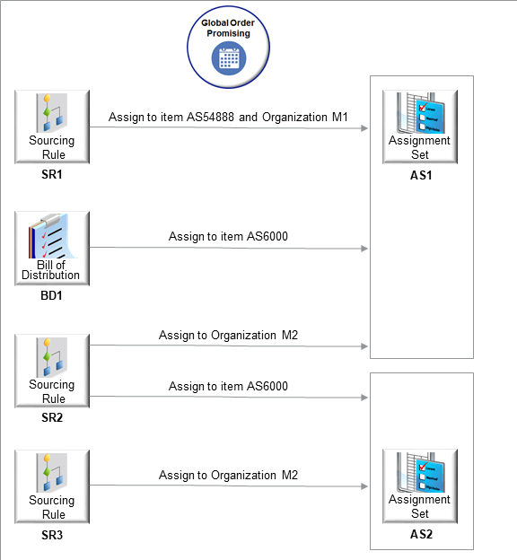

Consider an example that has three sourcing rules and one bill of distribution.
This example assigns the sourcing rules and bill of distribution to two assignment sets:
  • Assigns sourcing rule SR1 to assignment set AS1 at the item level and at the organization level for the AS54888 item in organization M1.
  • Assigns the BD1 bill of distribution to assignment set AS1 at the item level for the AS6000 item.
  • Assigns sourcing rule SR2 to assignment set AS1 at the organization level in the M2 organization.
  • Assigns sourcing rule SR2 to assignment set AS2 at the item level for the AS6000 item.
  • Assigns sourcing rule SR3 to assignment set AS2 at the organization level in the M2 organization.
If Promising uses assignment set:
  • AS1, then it sources the AS6000 item according to the sourcing that you specify in the BD1 bill of distribution.
  • AS2, then it sources the AS6000 item according to the sourcing that you specify in the SR2 sourcing rule.
