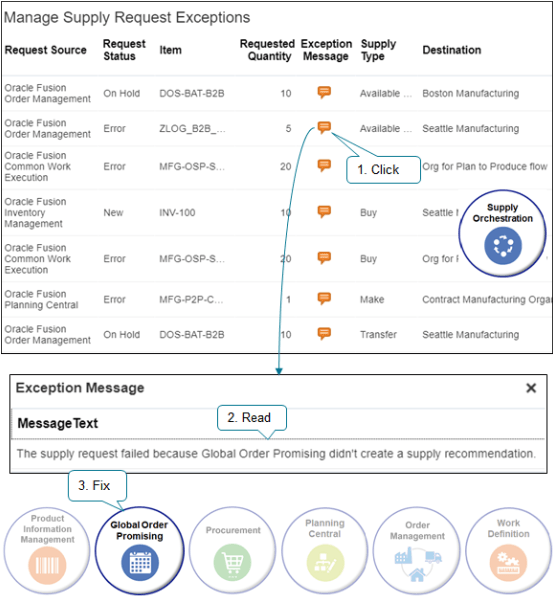

Try it:
  1. Go to the Supply Orchestration work area.
  2. Click the icon in the Exception Message column to get details about what happened.
  3. Read the message text to get clues about where you need to fix your set up.
  4. If the problem that causes the exception happens because:
    • Your set up in orchestration isn't correct. Fix the set up, then resubmit the request.
    • Data in the request is missing or isn't correct. Cancel the request, fix the data in the application that sends the request, then resend the request.
  5. Refresh the Manage Supply Exceptions page and select the updated record.
  6. Click Resubmit
    Orchestration removes exception messages and attempts to orchestrate supply for each row you select. However, Orchestration doesn't process lines it can't recover. If an exception persists on the Manage Supply Request Exceptions page even after you resubmit it, then its not recoverable, and the exception will persist. You must correct the underlying problem, then resubmit.
