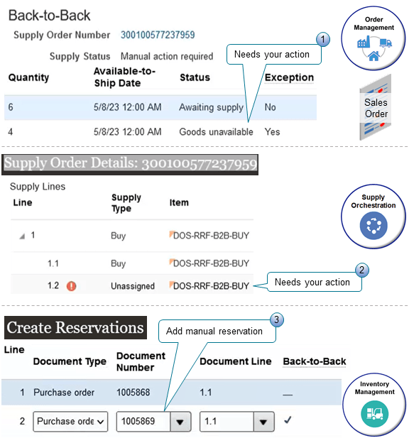

  1. Examine the order line in the Order Management work area and notice that there isn't enough quantity to fulfill demand.
  2. Click the supply order number, then examine the supply order details in Supply Chain Orchestration to see what supply needs your action.
  3. Use the Inventory Management work area to manually create a reservation. You can then use the Supply Orchestration work area to view that manual reservation.

  5. In the Fulfillment Line section, click Supply Details, then examine values in the Back-to-Back section:
    Attribute Value
    Supply Order Number 300100577237959
    Supply Status
    Manual Action Required
    This means there isn't enough supply to fulfill the order line's demand, so you need to take a manual action.
  6. Notice the values in the Supply Line Information section. A quantity of 6 is available and awaiting supply but a quantity of 4 isn't available:
    Quantity Available to Ship Date Status Exception
    6 5/8/23 12:00 AM Awaiting Supply No
    4 5/8/23 12:00 AM Goods Unavailable Yes
  7. Click the link in the Supply Order Number attribute, then notice that you are now on the Supply Order Details page in the Supply Orchestration work area.
  8. Notice the values in the Supply Lines area:
    Line Supply Type Item Requested Quantity Fulfilled Quantity Status
    1 Buy AS54888 Desktop Computer 10 - In Process
    1.1 Buy AS54888 Desktop Computer 6 - Awaiting Receipt
    1.2 Unassigned AS54888 Desktop Computer 4 0 Not Started
    Note
    • Line 1.1 tracks supply that's awaiting receipt.
    • Line 1.2 isn't assigned yet. This is the line that requires your manual action, such as creating a manual reservation to another source of supply that resides outside of Supply Chain Orchestration. Supply Chain Orchestration won't track this supply, but you can use the Supply Chain Orchestration work area to monitor the manual reservation.

  7. Go back to the Manage Reservations and Picks page. In the Details section, on the Reservations tab, notice that your sales order now has two reservations, one that Supply Chain Orchestration automatically created, and one that you manually created.
    Line Document Type Document Number Back to Back Reserved Quantity
    1 Purchase Order 1005868 Doesn't contain a check mark. 4
    2 Purchase Order 1005869 Contains a check mark. 6
    Also, notice that the Back to Back attribute for your manual reservation on line 1 doesn't contain a check mark.
