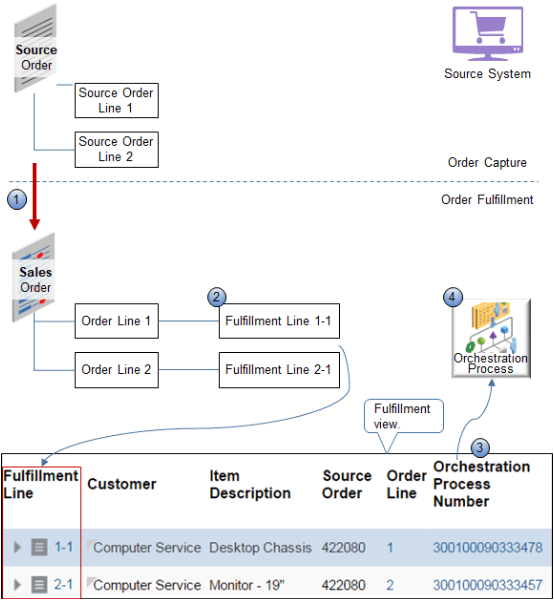

Here's how Order Management converts a source order:
Receives a source order that you submit in Order Management or that it gets from a source system. The source order in this example includes three order lines.
Separates the source order into order lines.
Assigns each order line to a new orchestration process that it creates to orchestrate fulfillment for the order line.
For example, it might assign order line 1-1 to orchestration process 300100090333478, and order line 1-2 to orchestration process 300100090333457.
The diagram includes part of the view that you use to monitor fulfillment. For details, see Monitor Order Fulfillment.
Starts the orchestration process that fulfills the order line. You can use a fulfillment view on the order page of the Order Management work area to monitor the orchestration process.
Order Management typically finishes transformation within a few seconds after you submit.
Order Management sets the completion date of the final step in the orchestration process to the requested date of the source order. The Last Fulfillment Completion Step sets the final step of the orchestration process.
