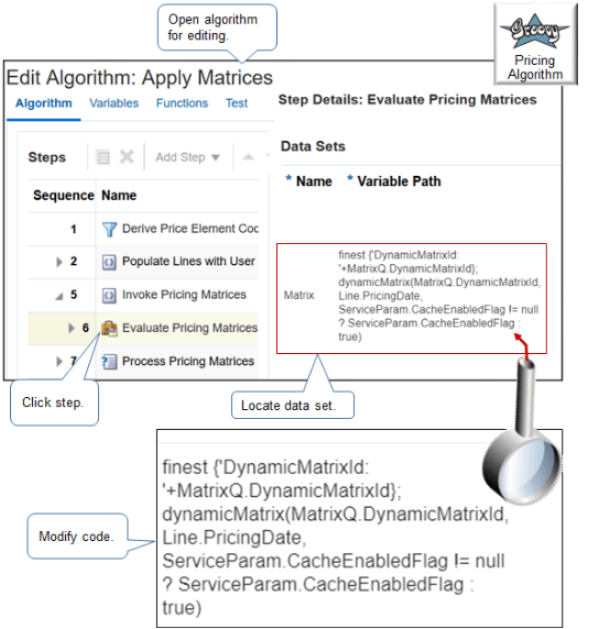

    For this example, search for, then open Apply Matrices for editing:
    Pricing runs the predefined step at run time to process the pricing matrix.
  3. On the Edit Algorithm page, click the step that contains Evaluate Pricing Matrices in the Name column.
  4. In the Step Details area, click the step that contains Matrix in the Name Column, then examine the code in the Variable Path column.
    finest {'DynamicMatrixId: '+MatrixQ.DynamicMatrixId}; dynamicMatrix(MatrixQ.DynamicMatrixId, Line.PricingDate, ServiceParam.CacheEnabledFlag != null ? ServiceParam.CacheEnabledFlag : true)
    Here's the format of the path to the Matrix data set.
    dynamicMatrix(MatrixId, effectivityDate, enableCache)
    where

    Most steps come with other predefined data sets, such as:
    • Charge
    • Line
    • Header
    • LineAttribute
    • ItemExtensibleAttribute
    • ServiceParam
    To reduce maintenance, use a predefined data set. If none of the predefined data sets meet your needs, then add a new one.
    If you use an item extensible attribute or extensible flexfield in a condition column, then you must add a data set. For example, here's a data set you could use to support an extensible flexfield that you add on the order header:
