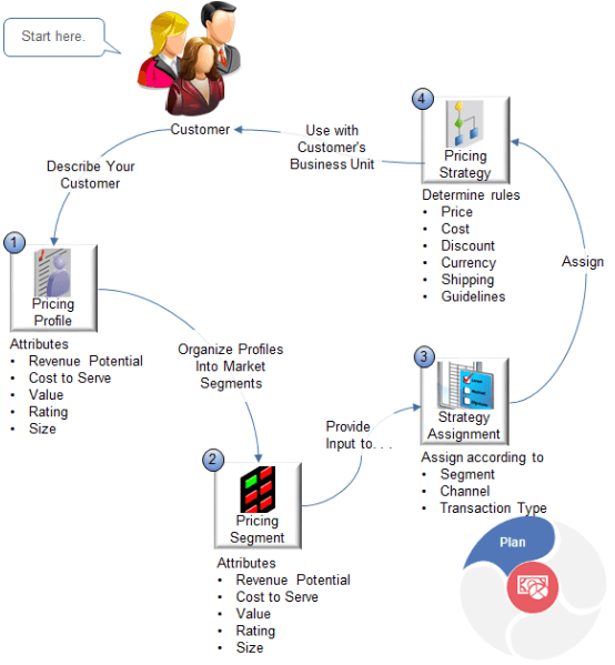

Plan Your Profiles, Segments, Assignments, and Strategies
Determine price according to the characteristics of each customer, rather than using one-size-fits-all pricing:
Set up entities in Pricing Administration to determine price according to the characteristics of each customer, rather than having to use one-size-fits-all pricing.
Note
Object
Description
1. Pricing Profile
Create a profile for each of your customers that describes buying characteristics according to customer attributes:
  • Revenue Potential
  • Cost to Serve
  • Value
  • Rating
  • Size
2. Pricing Segment
Group your customers into market segments that exhibit similar buying behavior according to market attributes:
  • Revenue Potential
  • Cost to Serve
  • Value
  • Rating
  • Size
You can also add your own attribute, such as Region.
3. Pricing Strategy Assignment
Assign your pricing strategy according to attributes:
  • Pricing Segment. The pricing segment you assigned to the customer.
  • Channel. Where you receive the sales order, such as direct sales or inside sales.
  • Transaction Type. The type of transaction, such as sales order, service contract, or subscription.
4. Pricing Strategy
Create a pricing strategy that determines how to price your item to achieve your objectives:
  • Set the Business Unit attribute of the pricing strategy to your customer's business unit. Pricing will use this strategy for each sales order that references the business unit.
  • Create pricing rules that specify price, cost, discounts, and currency conversion.
  • Create shipping rules that specify shipping charges.
  • Create guidelines to control modifications that your users can make to price, net price, and margin.

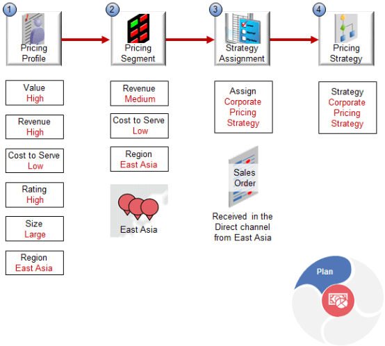

Assume you sell the wrist watch through a direct channel to customer Softgear, located in Seoul, South Korea:
For example, assume you sell it through a direct channel to customer Softgear, located in Seoul, South Korea.
Here's your set up:
  1. Create a pricing profile for Softgear:
    • You have a long-term, good working relationship with Softgear, so set Value to High.
    • Your research indicates that consumers in East Asia highly value the wrist watch and therefore have a high willingness to pay, so set Revenue Potential to High.
    • Consumers in this region are enthusiastic, early adopters of high-tech items and require little support, so set Cost to Serve to Low.
    • Rating is the perceived value of a customer to your business regarding their history, future outlook, relationship with your company, and so on, so set Rating to High.
    • Softgear is a large international company, so set Size to Large, and they're located in South Korea, so set Region to East Asia.
  2. Create a pricing segment that represents your East Asian market:
    • The East Asian market for high-tech items is highly competitive. You must price the wrist watch at lower, competitive rates, so set Revenue to Medium.
    • Consumers are enthusiastic early adopters, so set Cost to Serve to Low.
    • South Korea is in East Asia, so set Region to East Asia.
  3. Create a pricing strategy assignment that assigns the Corporate Pricing Strategy to direct sales orders that you receive from the East Asia segment.
  4. Use the predefined Corporate Pricing Strategy, which already specifies most of the pricing details that your East Asia segment requires. Modify it, as necessary.
At run time, Pricing will use the Corporate Pricing Strategy to price the wrist watch when you receive a direct sales order for the wrist watch from Softgear.

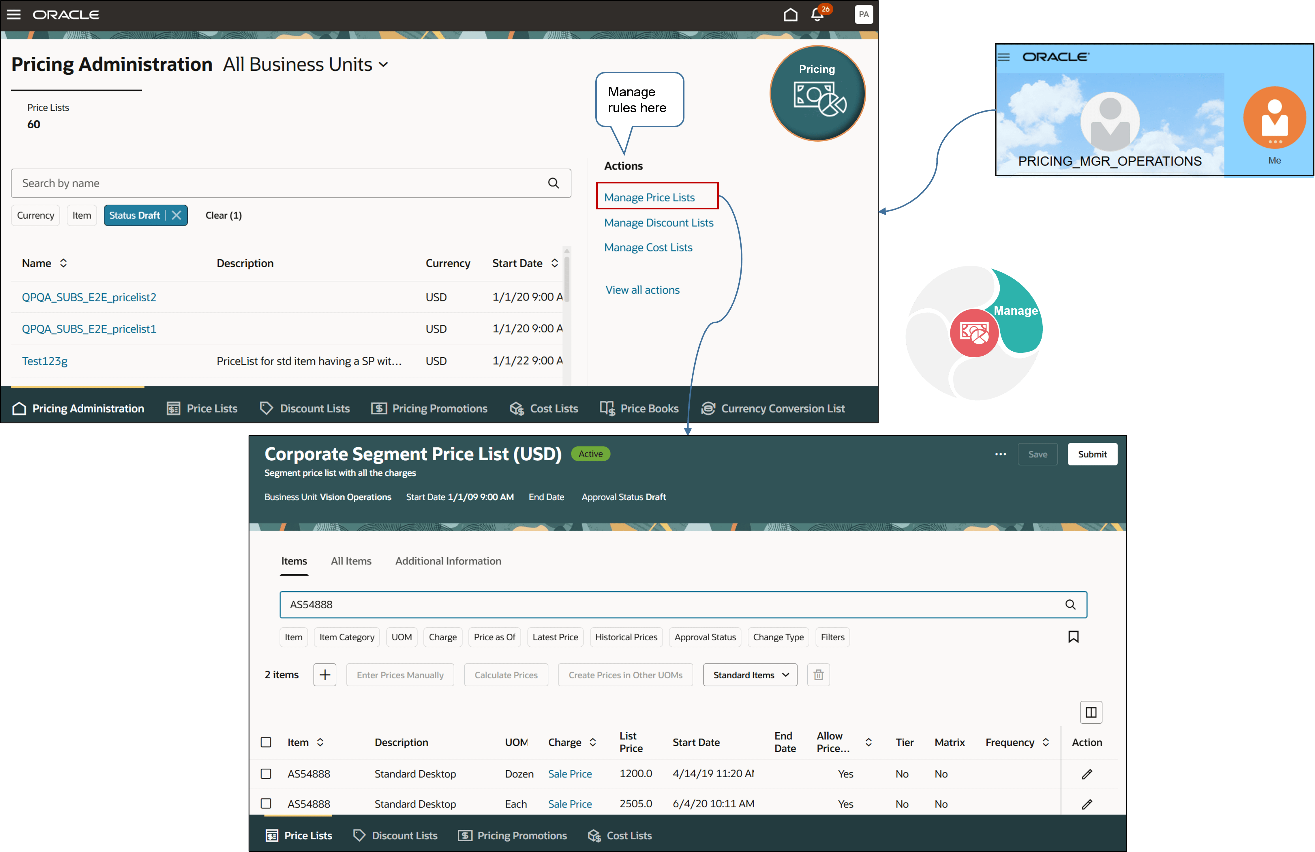

Manage
Use the Pricing Administration work area to manage your rules:
Use the Pricing Administration work area to manage all your rules.
Create rules that determine the price for your items:
  • Set up sales price, tiered price, discount, surcharge, freight, and adjustment according to attribute.
  • Price a nonconfigured item, configured item, coverage, service, or subscription.
  • Use a one-time charge or a recurring charge.
  • Mark up or mark down, by dollar amount or percent.
  • Apply separate charges for a single transaction, such as a $300 sales price charge for a cell phone, and another charge for the subscription fee for the cell phone.
  • Search across all your rules.

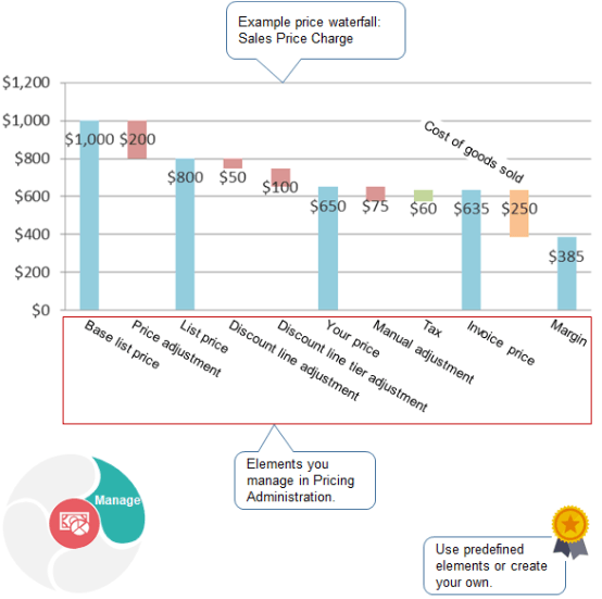

Manage Price Points on Price Waterfall
A price waterfall illustrates adjustments and discounts you make on an item, typically from the base list price to your margin.
Here's the Sales Price Charge price waterfall:
Sales Price Charge price waterfall.
Note
  • This example illustrates the Sale Price charge for an item on a sales order.
  • Include various types of charges that apply to your items and services. For example, installation charge, subscription, delivery fee, sale price, or restocking fee.
  • A price element is an object that a pricing algorithm uses to capture different types of prices, costs, adjustments, taxes, or profit margins that it requires to create a charge breakdown or pricing analytic.
    Base List Price, Net Price Plus Tax, and Margin are each an example of a price element.
  • Use the price elements that come predefined with Pricing to set up each price point in your waterfall, or create your own elements. For example:
    • Use the Base List Price element with a value of $1,000 to set the starting price point at $1,000.
    • Add the Price Adjustment element with a value of $200 to set the next price point, which is the List Price element at $800.
    • Continue adding whatever elements you need to the waterfall, such as discounts, tier adjustments, tax, margin, and so on.
  • Use a price element as the pricing basis to calculate a price adjustment.
  • Use and modify a predefined price definition, or create your own.
For details about tier adjustments, see Tier Pricing.

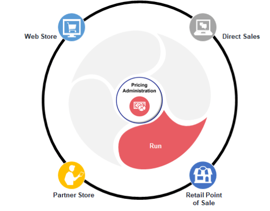

Centralize Your Pricing
Create and enforce pricing rules and policies across your entire enterprise:
Create and enforce pricing rules and policies across your entire enterprise.
Note
  • Deliver consistent and accurate prices across sales channels, such as web stores, direct sales, partner stores, retail points of sale, and more.
  • Use a flexible application and services to integrate pricing across systems and applications.
  • Use a variety of services, such as Price Sales Transaction, Calculate Order Totals, Validate Prices, and more.

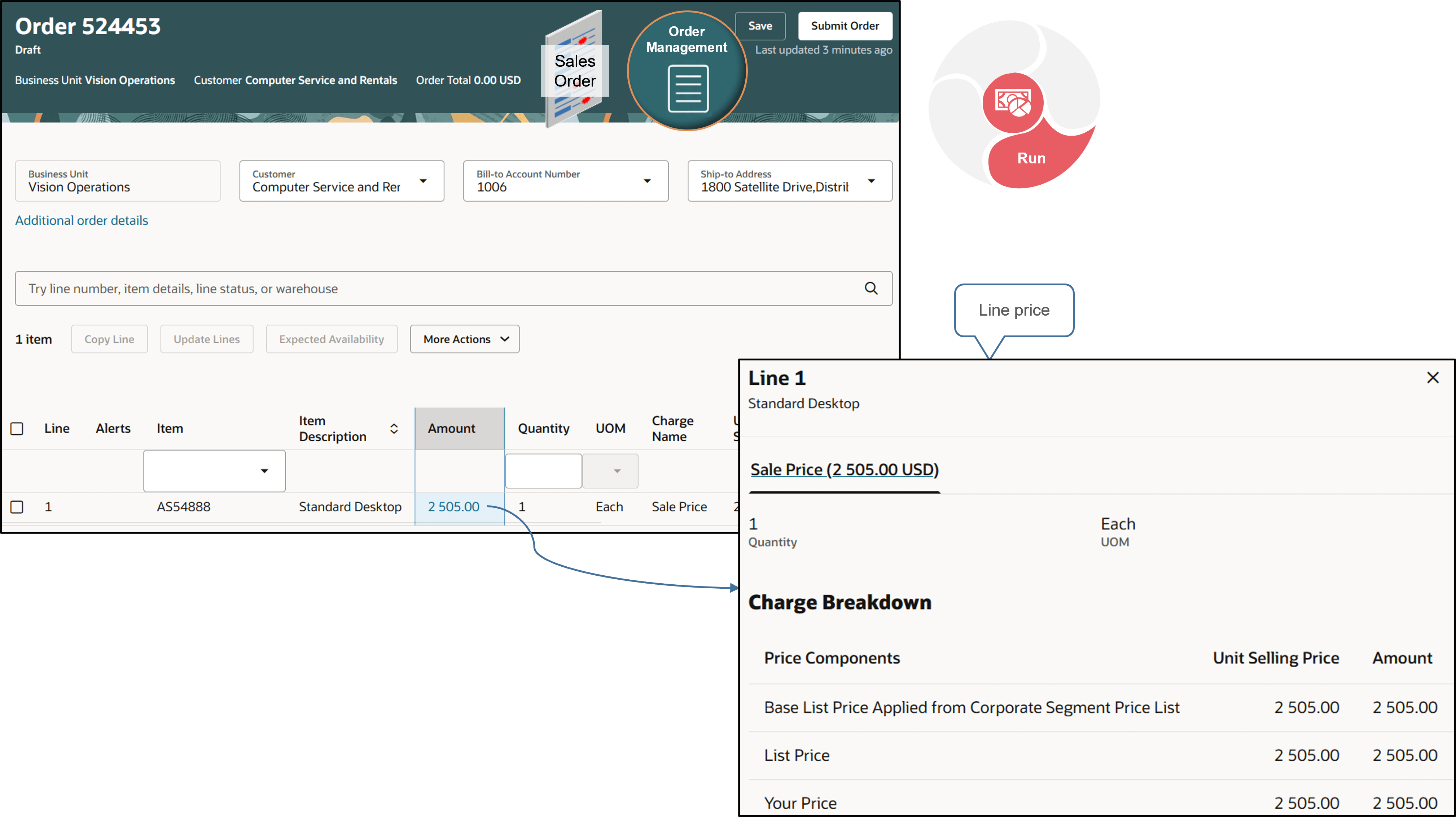

Administer runtime pricing for sales orders:
Administer runtime pricing for sales orders.
Note
  • Calculate list price, net price, shipping, and tax according to your pricing strategy.
  • Calculate one or more charges for each order line. For example, sales price plus installation fee.
  • Price nonconfigured items, configured items, subscriptions, or services.
  • Integrate with Oracle Financials for determine tax charges.
  • Display the charge breakdown and order totals in a dialog according to your requirements.
    For example, for the order line, specify how to calculate charges and specify which charges to display:
    • Base List Price Applied from Price List 1
    • List Price
    • Your Price
    • Exclusive Tax (Vat20 20%)
    • Net Price Plus Tax

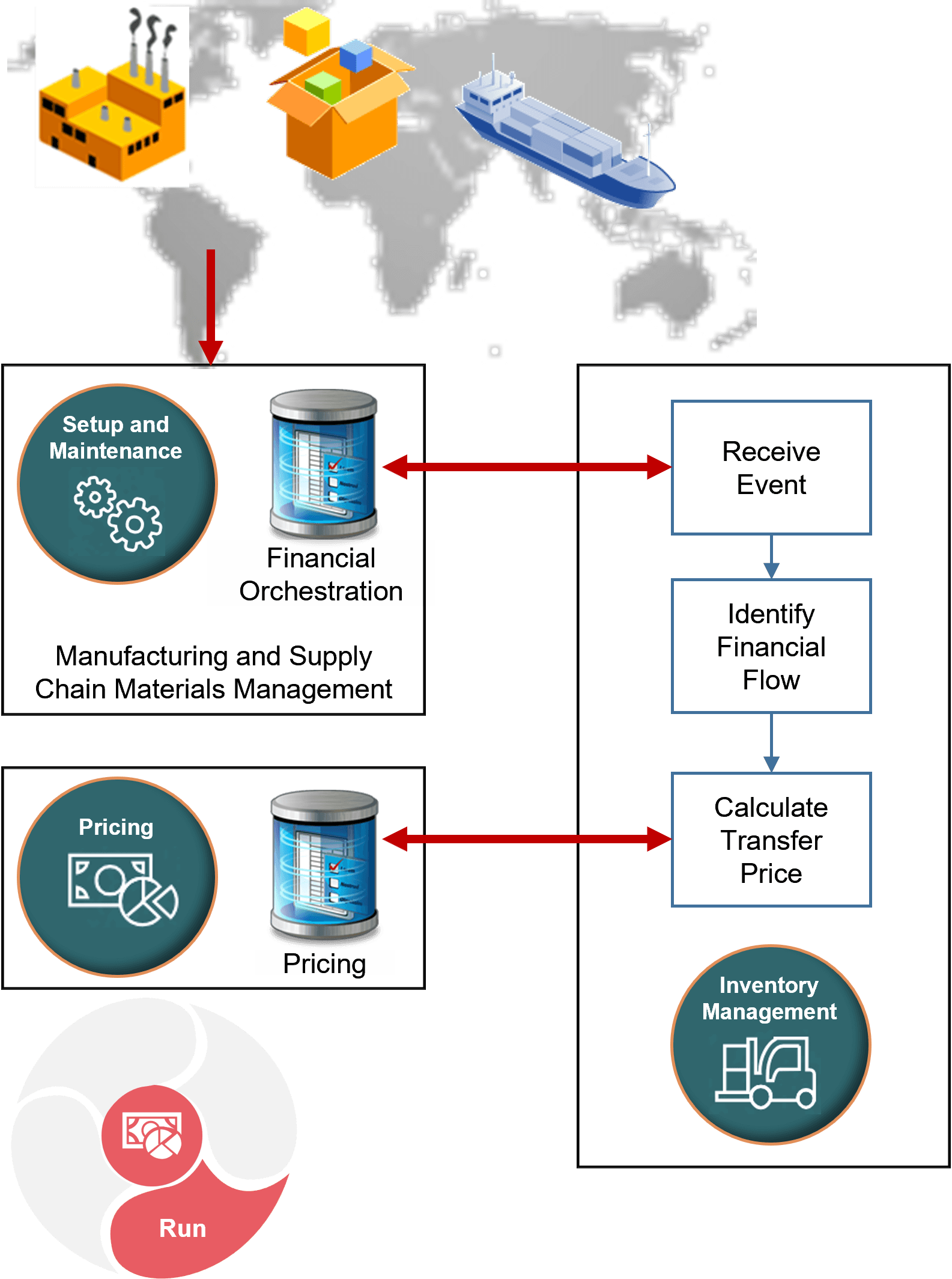

Administer Runtime Pricing for Oracle Inventory Management
Administer runtime pricing for transfer orders:
Administer runtime pricing for transfer orders.
Note
  • Use your set up from the Setup and Maintenance work area of the Manufacturing and Supply Chain Materials Management offering to manage financial orchestration data for material transactions that happen in your global supply network.
  • Use your set up from the Inventory Management work area to receive the event, identify the financial flow to use for the event, and calculate the transfer price.
  • Calculate pricing for transfer orders while orchestrating financials, then store it as pricing data in Pricing.
  • Create your pricing strategy according to a predefined matrix class specifically for financial orchestration.
  • Modify the predefined pricing algorithm that Pricing uses for financial orchestration.
  • Mark up or mark down price of the transfer order according to the price list, cost list, or source document price.
  • Create pricing rules for nonconfigured items or configured items.

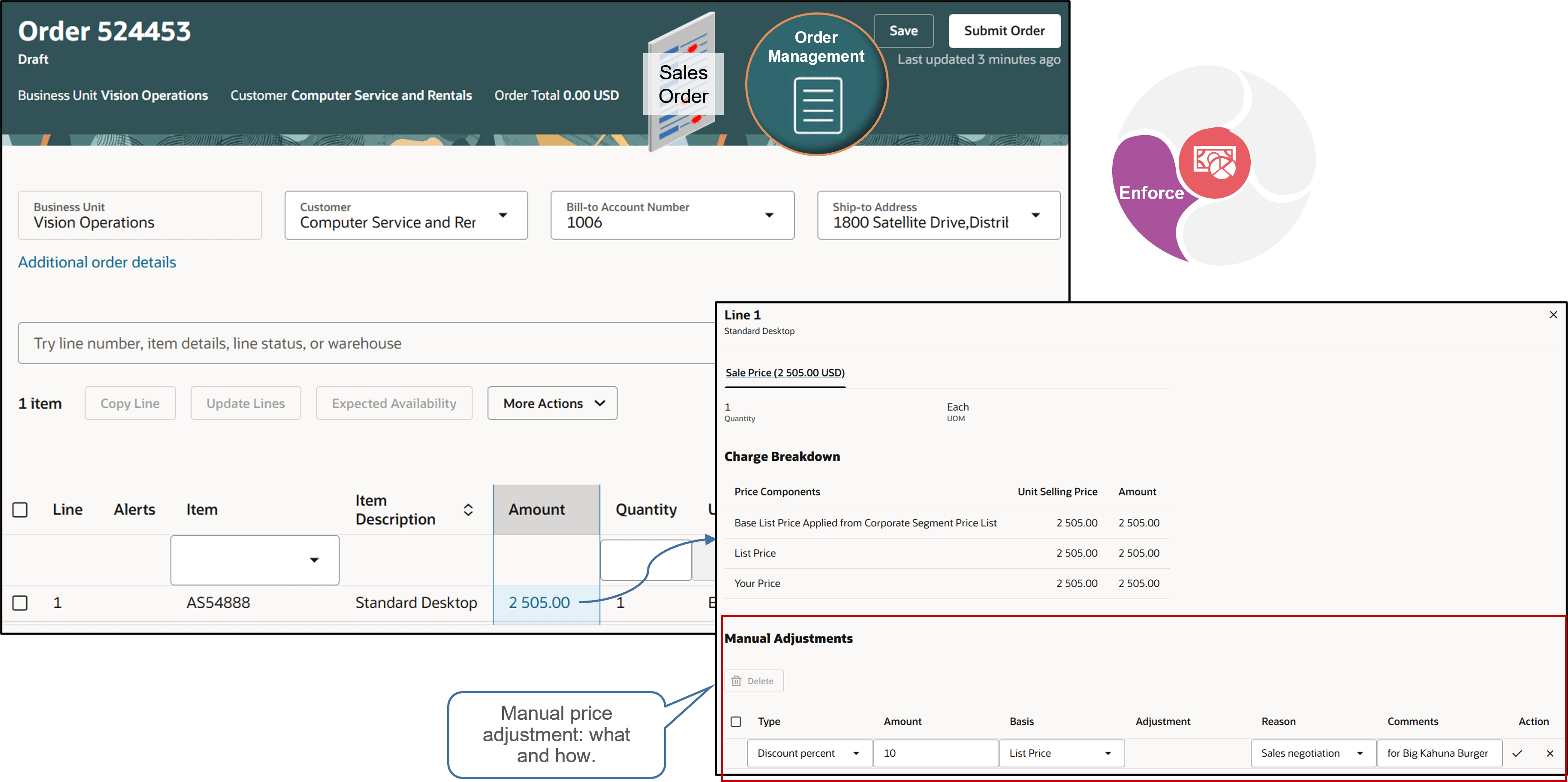

Enforce Controls on Manual Price Adjustments
Enforce controls on the manual price adjustments that your users can make on an order line:
Enforce controls on the manual price adjustments that your users can make in the dialog of an order line.
A manual price adjustment is an adjustment that the user manually sets on an order line, such as adding a discount for a sales campaign:
  • Administer the price list to enforce controls on each manual price adjustment.
  • Apply one or more adjustments on the net price.
  • Apply adjustment as a markup or markdown on each new price against a charge.
  • Apply adjustment as a percent or amount.
  • Control adjustments on order lines for buy lines or return lines.
  • Apply adjustments to each rolled up charge.

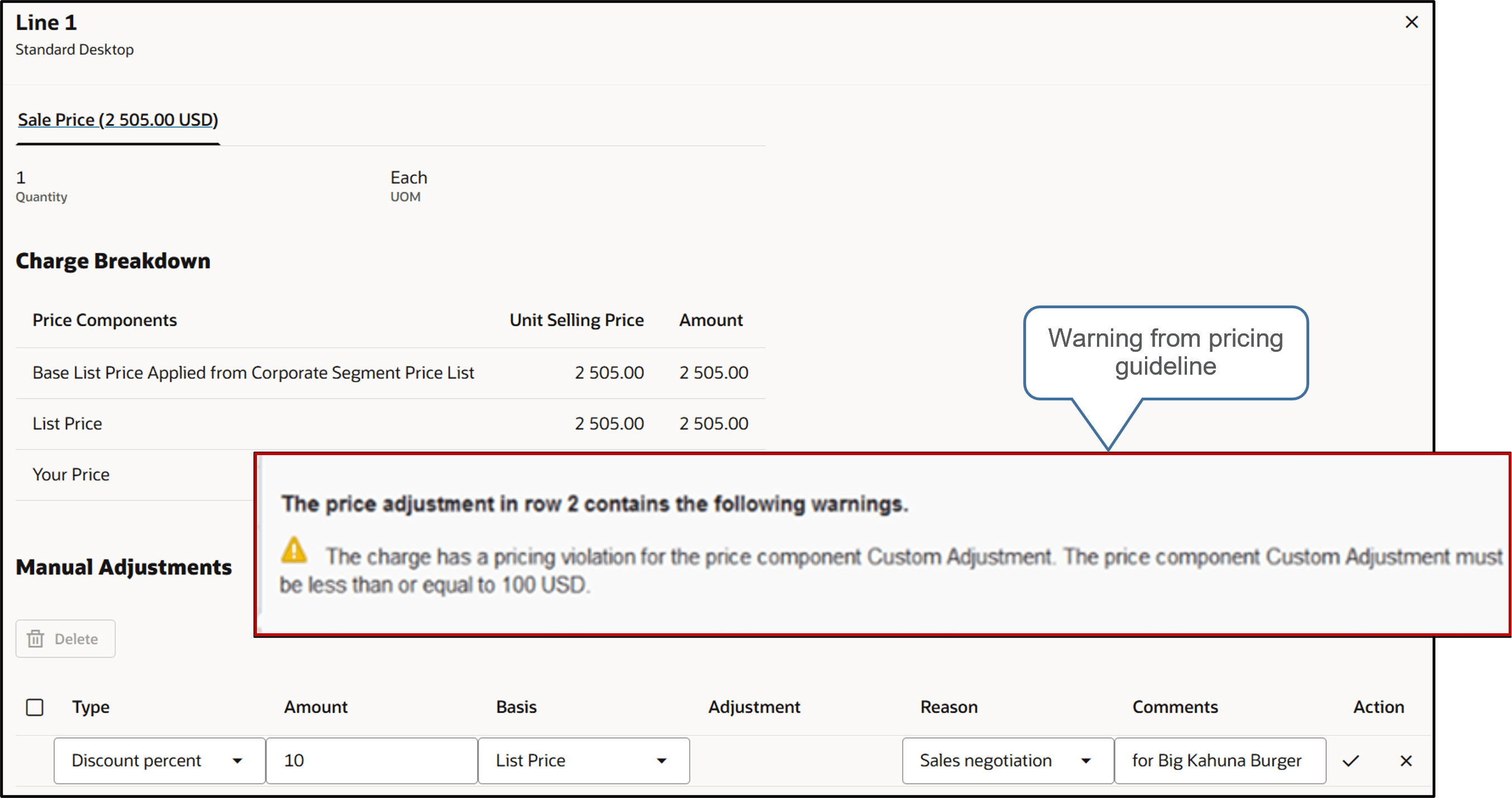

Use Guidelines to Enforce Pricing Policies
Use a pricing guideline to control changes your users make that affect price:
Use a pricing guideline to control changes your users make that affect price.
In this example, the Order Entry Specialist set the Discount Percent to 5 on the List Price. The adjustment results in a 125 USD discount, which exceeds the maximum of 100 that the guideline specifies. Here's the warning that this example displays.
The price adjustment in row 2 contains these warnings. The charge has a pricing violation for the price component Custom Adjustment. The price component Custom Adjustment must be less than or equal to 100 USD.
A pricing guideline is a rule you create that controls changes your users can make to price, net price, margin, and so on. You apply it on an item, user role, customer detail, or time period. Pricing evaluates each guideline when it validates the sales order:
  • Manage profitability, discount discipline, or compliance.
  • Make sure sales orders conform to the price and discount strategies that your corporate pricing policies require.
  • Prevent excessive discounts or markups.
  • Prevent unexpected reductions of your profit margin. For example, write a rule that makes sure margin is 20% or more.
  • Specify to display a warning or error when the modification exceeds the guideline.
