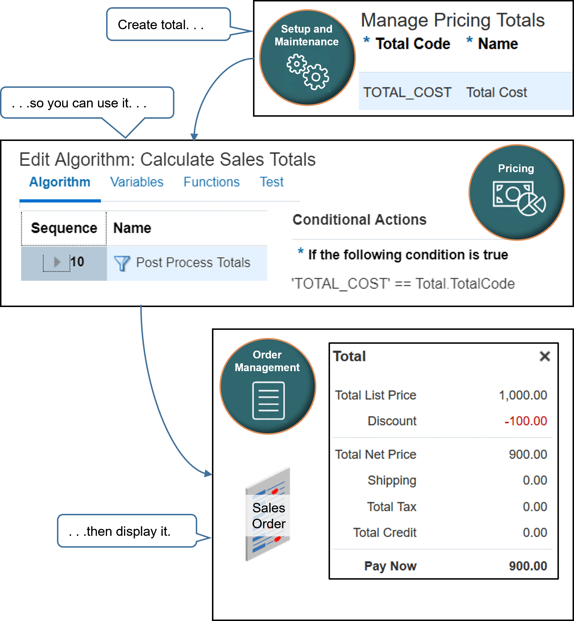

Set Up Your New Totals
  1. Sign into Oracle Order Management with administrative privileges.
  2. Go to Home > My Enterprise > Setup and Maintenance > Tasks > Search > Manage Pricing Totals.
  3. On the Manage Pricing Totals page, use Actions > Add Row to create your new totals:
    Total
    Name
    Description
    TOTAL_COST
    Total Cost
    Total cost for price and shipping charges on the order line.
    TOTAL_MARGIN
    Total Margin
    Total of the margin for price and shipping charges on the order line.
    Make sure you enable these options when you add the totals:
    • Transaction Enabled
    • Return Not Null
    Leave the Process Name attribute empty.
  4. Click Save.

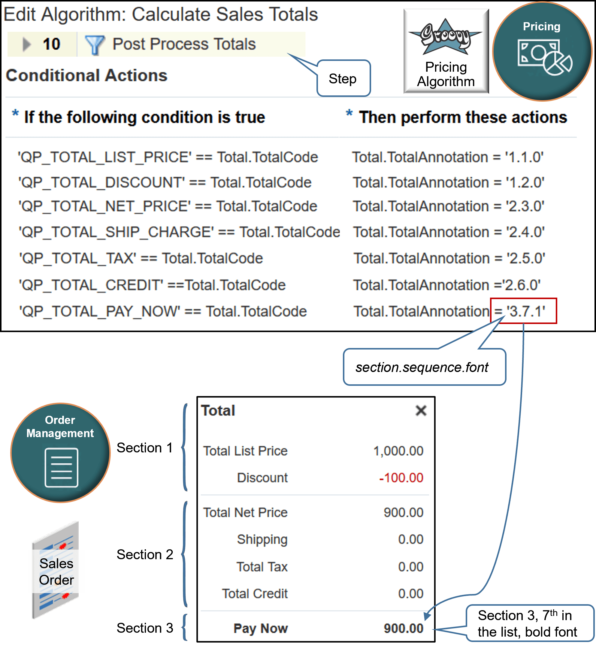

  6. In the Conditional Actions area, examine the TotalAnnotation property for each total:
    The annotation uses dot notation to specify how each total displays in the charge breakdown.
    section.sequence.font
    where
    • section specifies a section in the charge breakdown.
    • sequence specifies where to display the total in the top to bottom sequence of lines in the charge breakdown
    • font specifies the font style. Use 0 (zero) for font that isn't bold and 1 for bold.
    For example:
    If This Condition Is True
    Then Do This Action
    'QP_TOTAL_PAY_NOW' == Total.TotalCode
    Total.TotalAnnotation = '3.7.1'
    This condition states to place the Pay Now total in the third section, 7th in the sequence of totals, and to use bold font.
    The screen print doesn't include PrimaryFlag, for brevity. If you add a row, make sure you add PrimaryFlag under Total.TotalAnnotation. Set it to false for all rows except Pay Now. Set it true for Pay Now.
  7. In the Conditional Actions area, click Add Row, set the values, then click Save and Close:
    Then Do These Actions
    'TOTAL_COST' == Total.TotalCode
    Total.TotalAnnotation = '3.8.0'
    Total.PrimaryFlag =false
    'TOTAL_MARGIN' == Total.TotalCode
    Total.TotalAnnotation = '4.9.0'

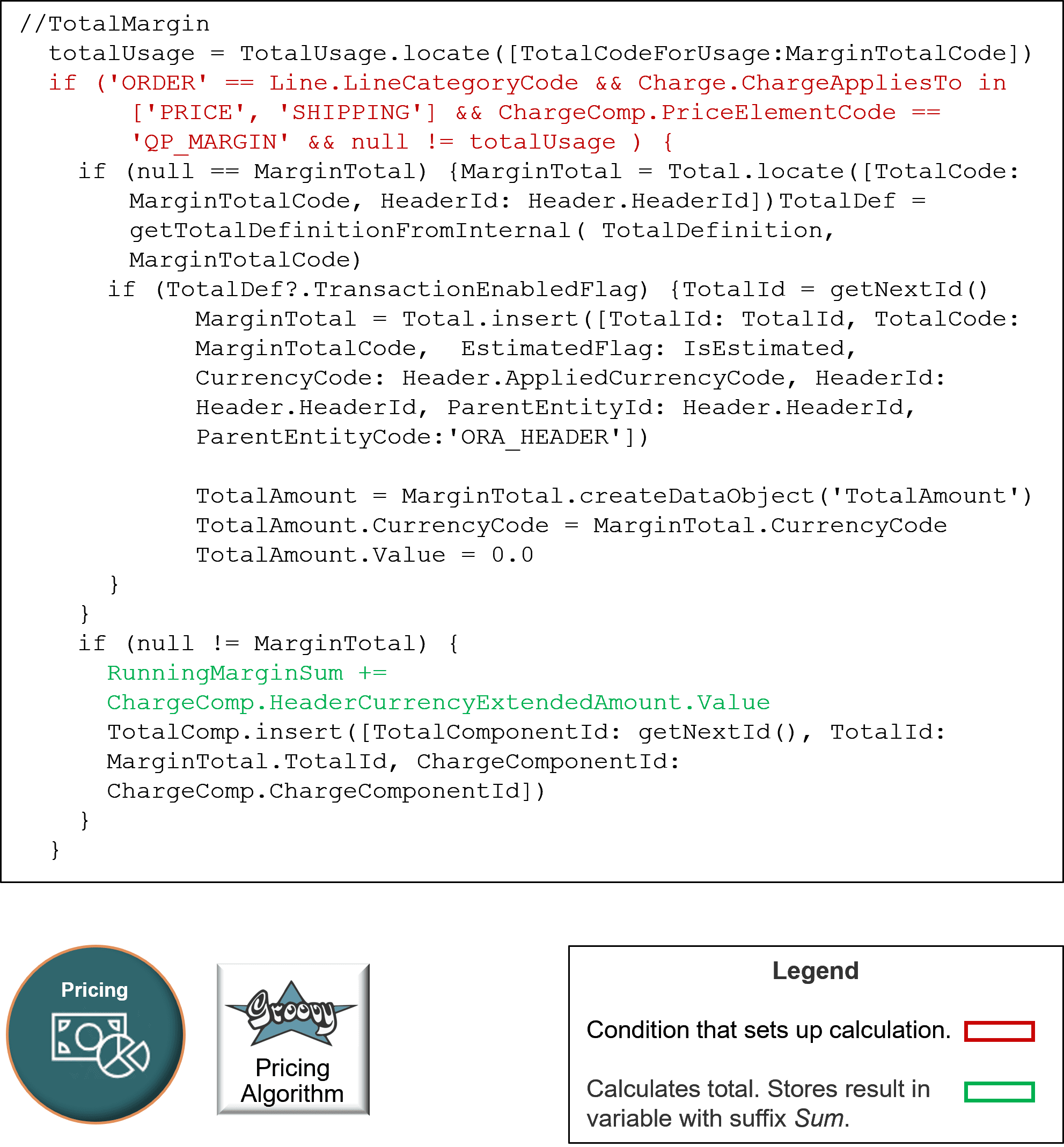

  4. Add code to calculate the total:
    • In the Steps area, click the Compute Total step.
    • Add code in the Group Each Row Actions area.
      //TotalMargin
      totalUsage = TotalUsage.locate([TotalCodeForUsage: MarginTotalCode])
      if ('ORDER' == Line.LineCategoryCode && Charge.ChargeAppliesTo in ['PRICE', 'SHIPPING'] && ChargeComp.PriceElementCode == 'QP_MARGIN' && null != totalUsage) {
          if (null == MarginTotal) {
              MarginTotal = Total.locate([TotalCode: MarginTotalCode, HeaderId: Header.HeaderId]) TotalDef = getTotalDefinitionFromInternal(TotalDefinition, MarginTotalCode)
              if (TotalDef ? .TransactionEnabledFlag) {
                  TotalId = getNextId()
                  MarginTotal = Total.insert([TotalId: TotalId, TotalCode: MarginTotalCode, EstimatedFlag: IsEstimated, CurrencyCode: Header.AppliedCurrencyCode, HeaderId: Header.HeaderId, ParentEntityId: Header.HeaderId, ParentEntityCode: 'ORA_HEADER'])
                  TotalAmount = MarginTotal.createDataObject('TotalAmount')
                  TotalAmount.CurrencyCode = MarginTotal.CurrencyCode
                  TotalAmount.Value = 0.0
          if (null != MarginTotal) {
              RunningMarginSum += ChargeComp.HeaderCurrencyExtendedAmount.Value
              TotalComp.insert([TotalComponentId: getNextId(), TotalId: MarginTotal.TotalId, ChargeComponentId: ChargeComp.ChargeComponentId])
      Here's an explanation:
    • Add code in the Group Last Row Actions area. This code locates the new Total and assigns the calculated Sum value.
      if (null == MarginTotal) MarginTotal = Total.locate([TotalCode: MarginTotalCode, HeaderId: Header.HeaderId])
      if (MarginTotal != null) {
          MarginTotal.TotalAmount.Value = RunningMarginSum
