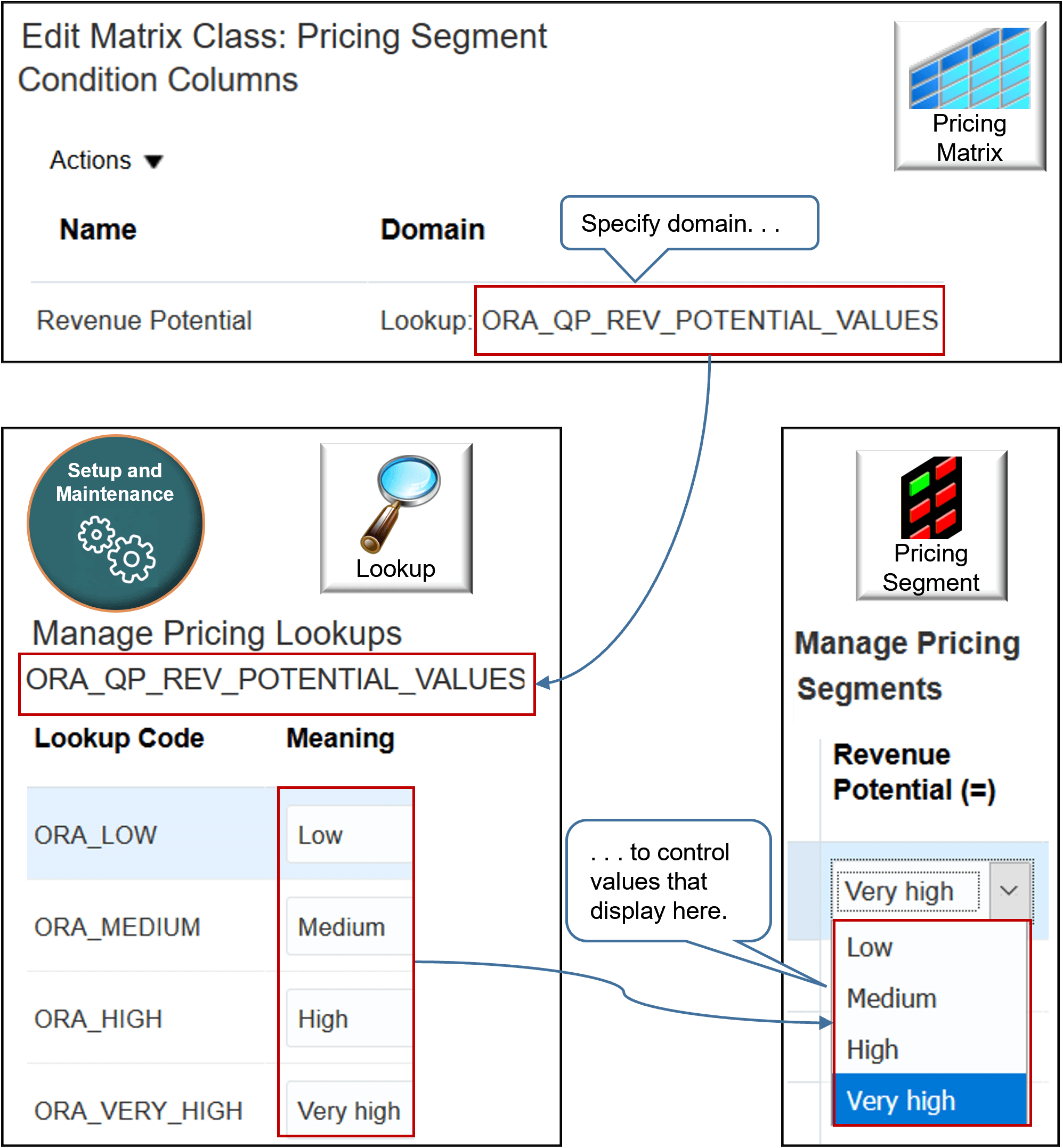

Use the Domain of the pricing matrix's class to specify where to get the values that the pricing matrix displays as choices for each attribute in the matrix.
Assume the Revenue Potential attribute of the Pricing Segment matrix class references the ORA_QP_REV_POTENTIAL_VALUES lookup:
the Revenue Potential attribute of the Pricing Segment matrix class references the ORA_QP_REV_POTENTIAL_VALUES lookup. Pricing gets the values that the lookup contains when you use the Manage Pricing Segments page, then displays them as choices in the Revenue Potential attribute of the segment.
Oracle Pricing gets values from the lookup when you use the Manage Pricing Segments page, then displays them as choices in the Revenue Potential attribute of the segment.

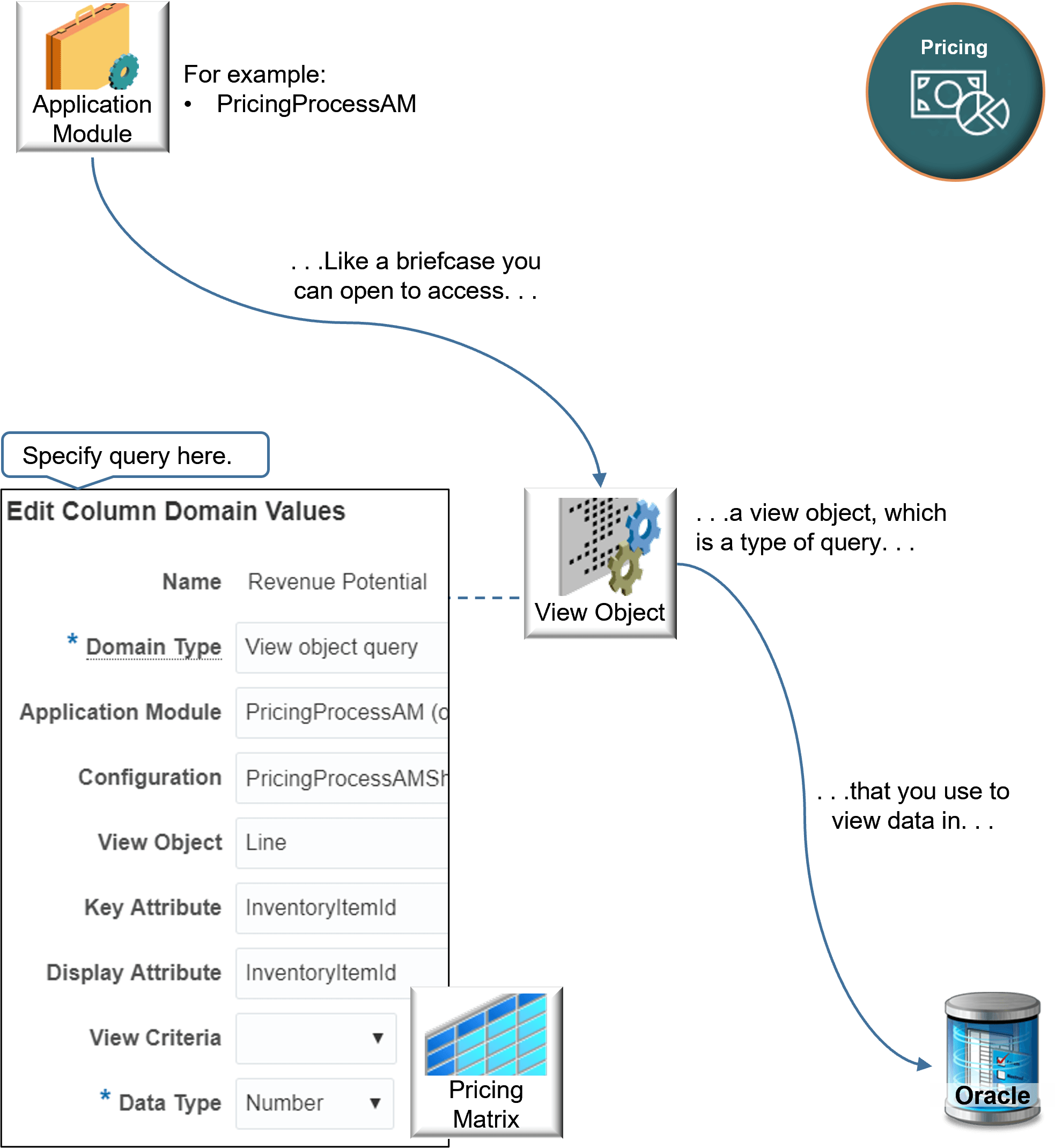

For example, assume you developed a new item with a very large revenue potential, the Heart Wrist Watch that monitors heart rhythms. You need to use it as input to Revenue Potential on your pricing matrix. If the order line contains the wrist watch, then you need to set Revenue Potential to Very High:
Notes
  • An application module is a like a briefcase that you can open to access the Oracle database. PricingProcessAM (Pricing Process Application Module) is an example of an application module.
  • Use the view object to query the Oracle database.
  • In the Condition Columns area of the pricing matrix, In the Domain column, click the pencil, then set the Domain Type to View Object Query.
  • Use the dialog to specify how to use view object to query the Oracle database.
  • Here are the settings that you use for this example:
    Attribute
    Value
    Domain Type
    View Object Query
    Application Module
    PricingProcessAM (oracle.apps.scm.doo.common.pricingIntegration.ApplicationModule.PricingProcessAM)
    Configuration
    PricingProcessAMShared
    View Object
    Line
    The order line contains the item, so select Line.
    Key Attribute
    InventoryItemId
    InventoryItemId identifies the item that the order line contains.
    Display Attribute
    InventoryItemId
    View Criteria
    Leave empty.
    Data Type
    Number
    InventoryItemId is a number data type.
    View Object Bind Variables
    Leave empty.
