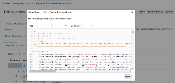

  5. Along the top of the Edit Algorithm page, Click View Source, then make sure the dialog that displays includes this message.
    The following script has passed syntax check
    For example:
    view source dialog for price sales transactions
