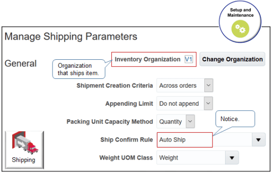

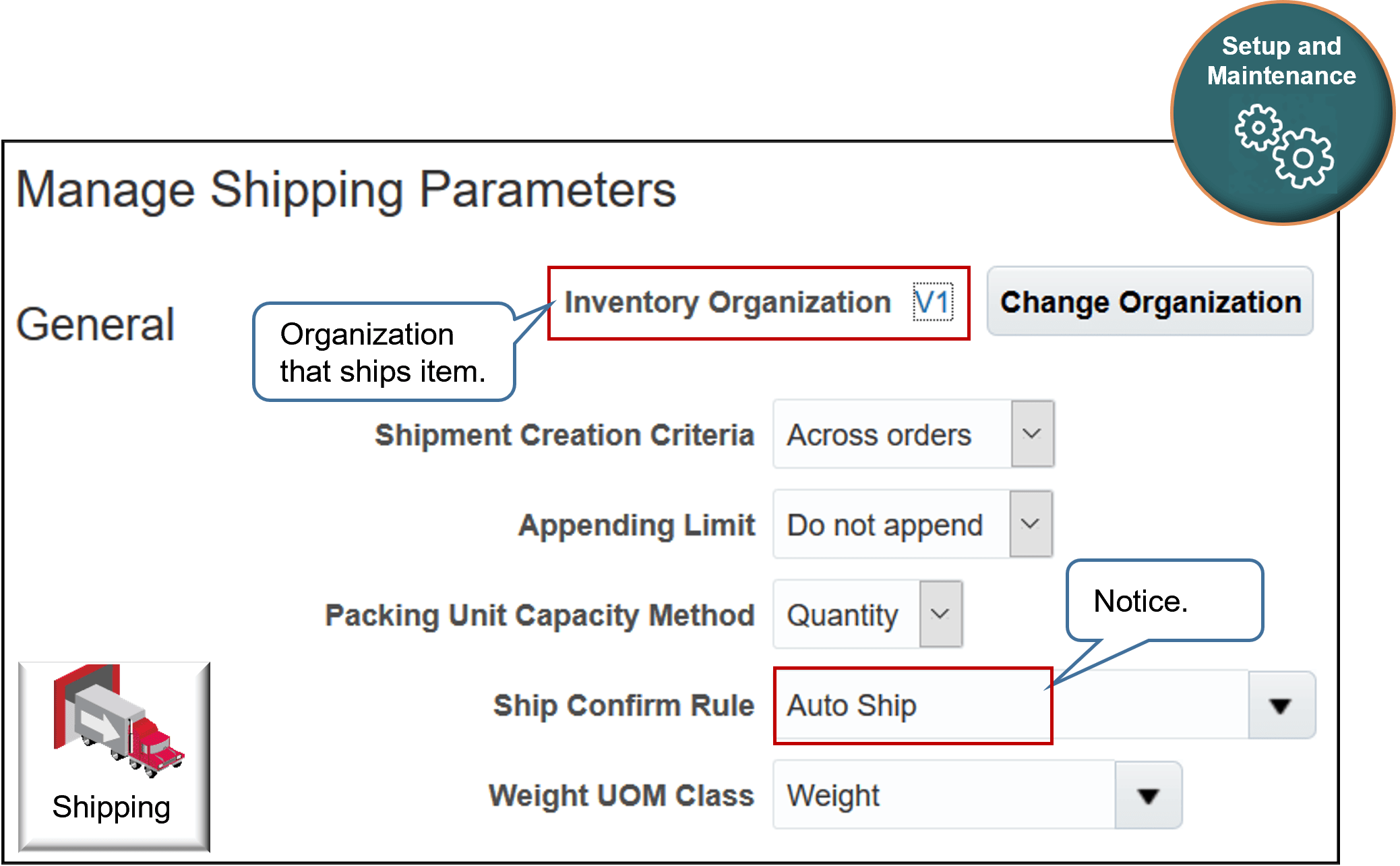

  1. Identify the ship confirm rule that your inventory organization uses:
    • Go to the Setup and Maintenance work area, then go to the Manage Shipping Parameters task.
    • Set organization to Vision Operations.
    • On the Manage Shipping Parameters page, notice the value in the Ship Confirm Rule attribute.
      For this example, assume the value is Auto Ship:
      assume the value is Auto Ship.

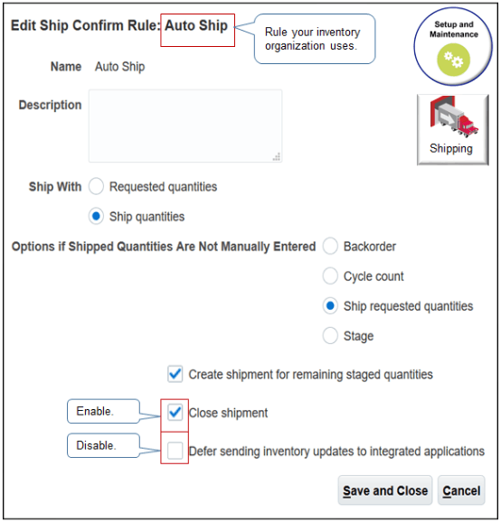

  2. Modify the ship confirm rule:
    • Go to the Setup and Maintenance work area, then go to the Manage Ship Confirm Rules task.
    • On the Manage Ship Confirm Rules page, search for Auto Ship, then open it for editing.
    • In the Edit Ship Confirm Rule dialog, set the values, then save your work.:
      Option
      Value
      Close Shipment
      Enabled
      Defer Sending Inventory Updates to Integrated Applications
      Disabled

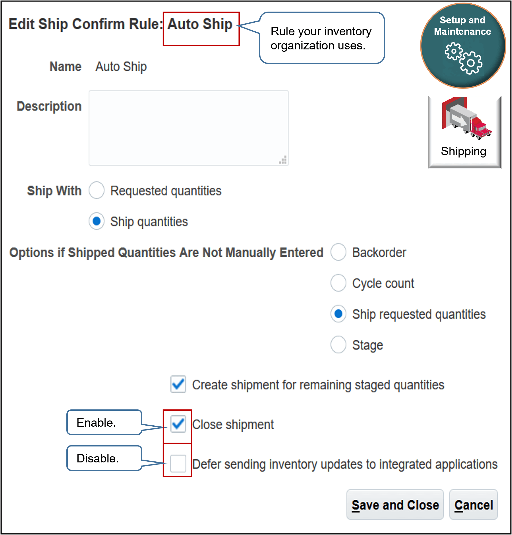

  5. On the Edit Shipment page, near the upper right corner, click Actions > Change Ship Confirm Options.
  6. In the dialog that displays, enable and disable the same options that you set for the ship confirm rule.
