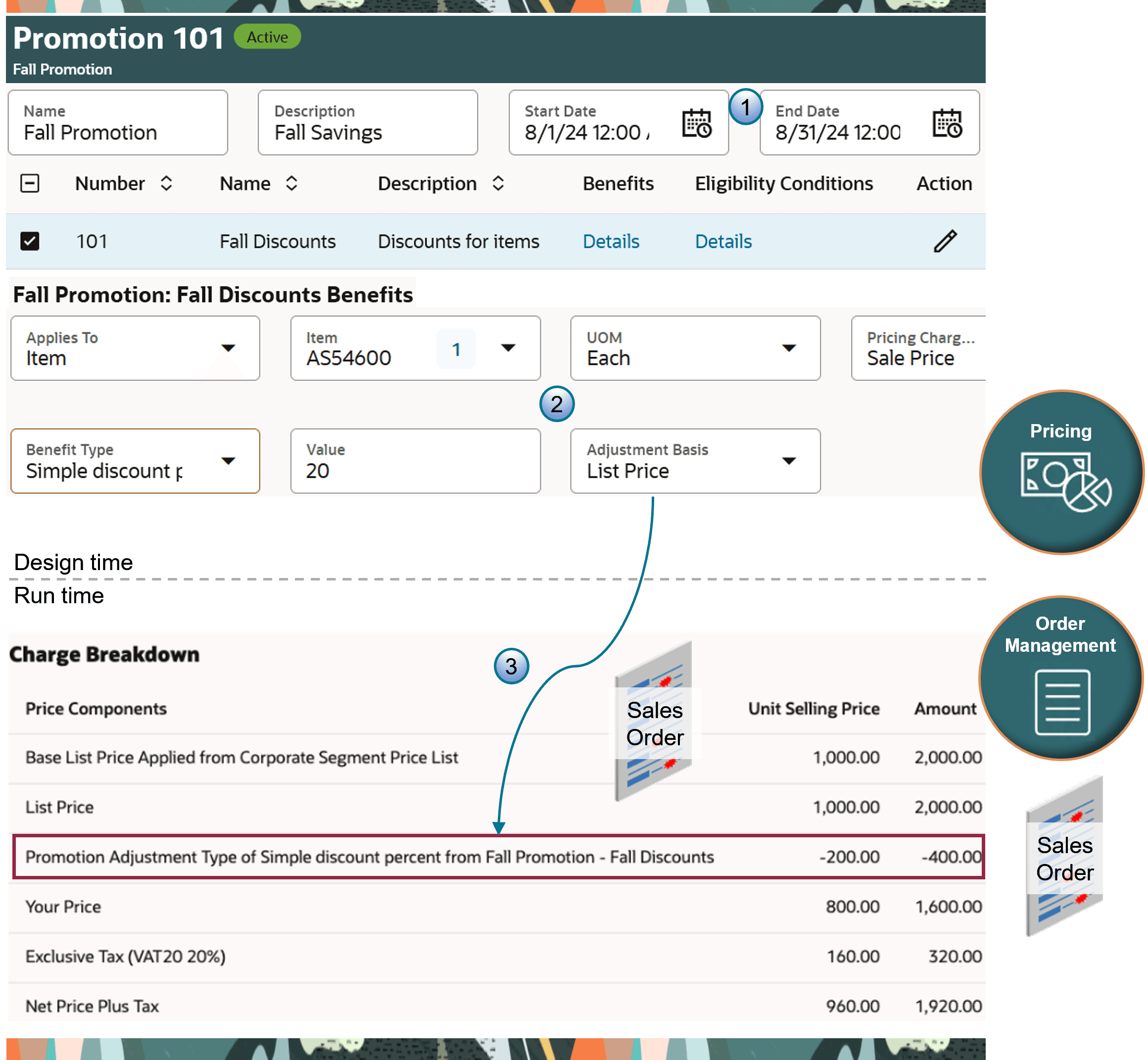

Create a Simple Promotion
Assume you sell supplies and equipment to students of all ages. You have a fall promotion that you want to run during the entire month of August:
Apply a 20% discount
off the list price of each AS54600 item that my customer buys on August 1, 2024
through August 31, 2024.
Here's your set up:
Try It:
- Go to the Pricing Administration work area, then click Pricing Promotions.
- On the Pricing Promotions page, click Create Promotion,
then set the values:
Attribute Value Number 101
Note
- You can enter any alphanumeric value.
- The value must be unique across promotions.
- If you don't provide a value, then Pricing will automatically assign one after you save your work.
- You can't change the number after you save.
- The same behavior applies for a promotion line's number.
Name Fall Promotion Description Fall Savings Start Date August 1, 2024
Use the promotion's start date and end date to determine when you want the promotion to be in effect.
End Date August 31, 2024 - Click Add Row to add a promotion line, set the values,
then click Apply:
Attribute Value Promotion Line Number 101 Promotion Line Name Fall Discounts Promotion Line Description Discounts for items -
A benefit is an incentive that provides a reason to motivate your customer to purchase an item. Click Add in the Benefits column, then set the values:
Attribute Value Applies To Item Item AS54600 UOM Each Pricing Charge Definition Sale Price
Use this attribute to identify the charge where you want to apply the promotion.
Assume you select Sale Price. If the item on the order line has a sale price charge, then Pricing will apply the promotion on that charge.
For this example, you select only Sale Price, so Pricing will apply the promotion only on the sale price.
Benefit Type Simple Discount Percent Value 20 Adjustment Basis List Price - Click Activate to make the promotion available so Pricing
can use it to price your sales order. Use this button to help manage your set
up. For example, you might need to add a number of lines and conditions before
you want Pricing to use this promotion.
You can't deactivate or delete a promotion. If you no longer want Pricing to use it, then set the End Date to a date that has already occurred.
If the sales order meets the condition, then Pricing will apply the rule at run time on the sales order in Order Management. The charge breakdown on the order line will include the promotion name, the promotion line's name, the type of adjustment, and the adjustment amount:
Promotion Adjustment Type of Simple
Discount Percent from Fall Promotion – Fall Discounts

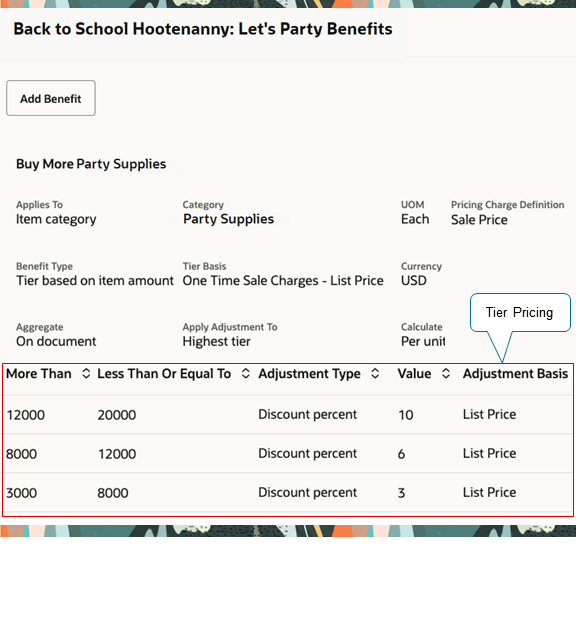

Tier Your Adjustments
You can add a tiered discount according to the list price and the category that the item is in:
If the total amount of one time charges for all party supplies on the sales order is more than:
- $12,000 but less than $20,000, then apply a 10% discount off the list price.
- $8,000 but less than $12,000, then apply a 6% discount off the list price.
- $3,000 but less than $8,000, then apply a 3% discount off the list price.
Tell Pricing how to calculate the rule:

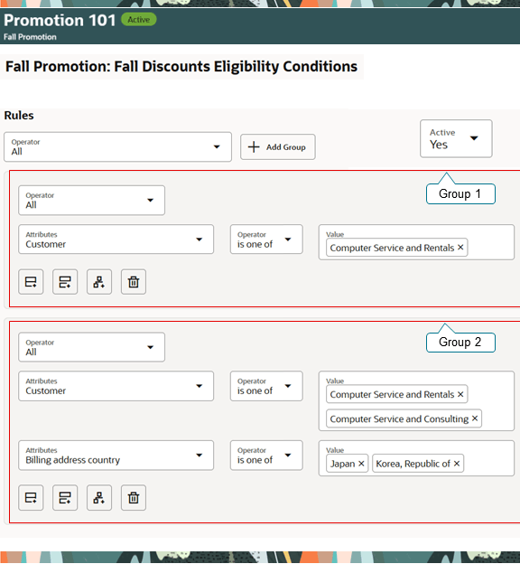

Consider this example:
Adding a group adds OR logic to your eligibility conditions. The Rules section in this example has two groups:
| Group | Rule |
| 1 | If the Customer attribute contains Computer Service and Rentals, then apply the promotion. |
| 2 | Or if the Customer attribute contains Computer Service and Rentals, or if it contains Computer Service and Consulting, and if the billing address is in Japan or Korea, then apply the promotion. |

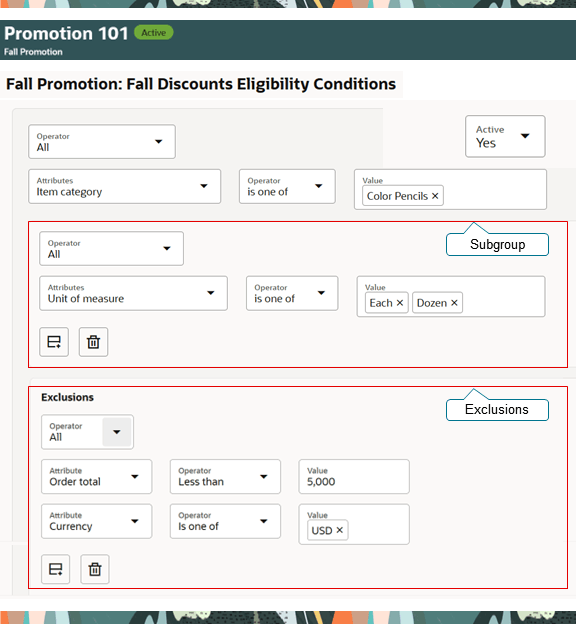

Use subgroups and exclusions to focus your promotion even more. A subgroup works like adding an AND operator to the group, while an exclusion works like adding a NOT operator to the group. Consider this example:
The category specifies Color Pencils as the group, an order line attribute specifies the subgroup, and we also have an exclusion. The example applies this rule:
| Condition | Rule |
| Group | If the item is in the Color Pencils category. . . |
| Subgroup | . . . And if the order line's Unit of Measure attribute contains Each or it contains Dozen. . . |
| Exclusion | . . . And if the total amount on the sales order isn't less than 5,000 and the currency is USD, then apply the promotion. |

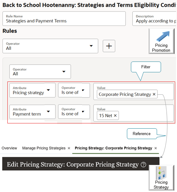

Automatically match a promotion to your pricing strategy and payment term.
Create an eligibility rule that uses a pricing strategy or payment term to determine whether the order is eligible for a pricing promotion. Use the pricing strategy to automatically match the promotion to your pricing objective. As an alternative, add a payment term to your eligibility rule so you can reward each customer who agrees to the term that meets your strategy.
Try it:
- Create your promotion and promotion line, then add a benefit.
- Add an eligibility rule to the benefit and use it to specify which sales orders are eligible for promotion.
For example, filter eligibility where the pricing strategy is Corporate Pricing Strategy and the payment term is 15 NET:
