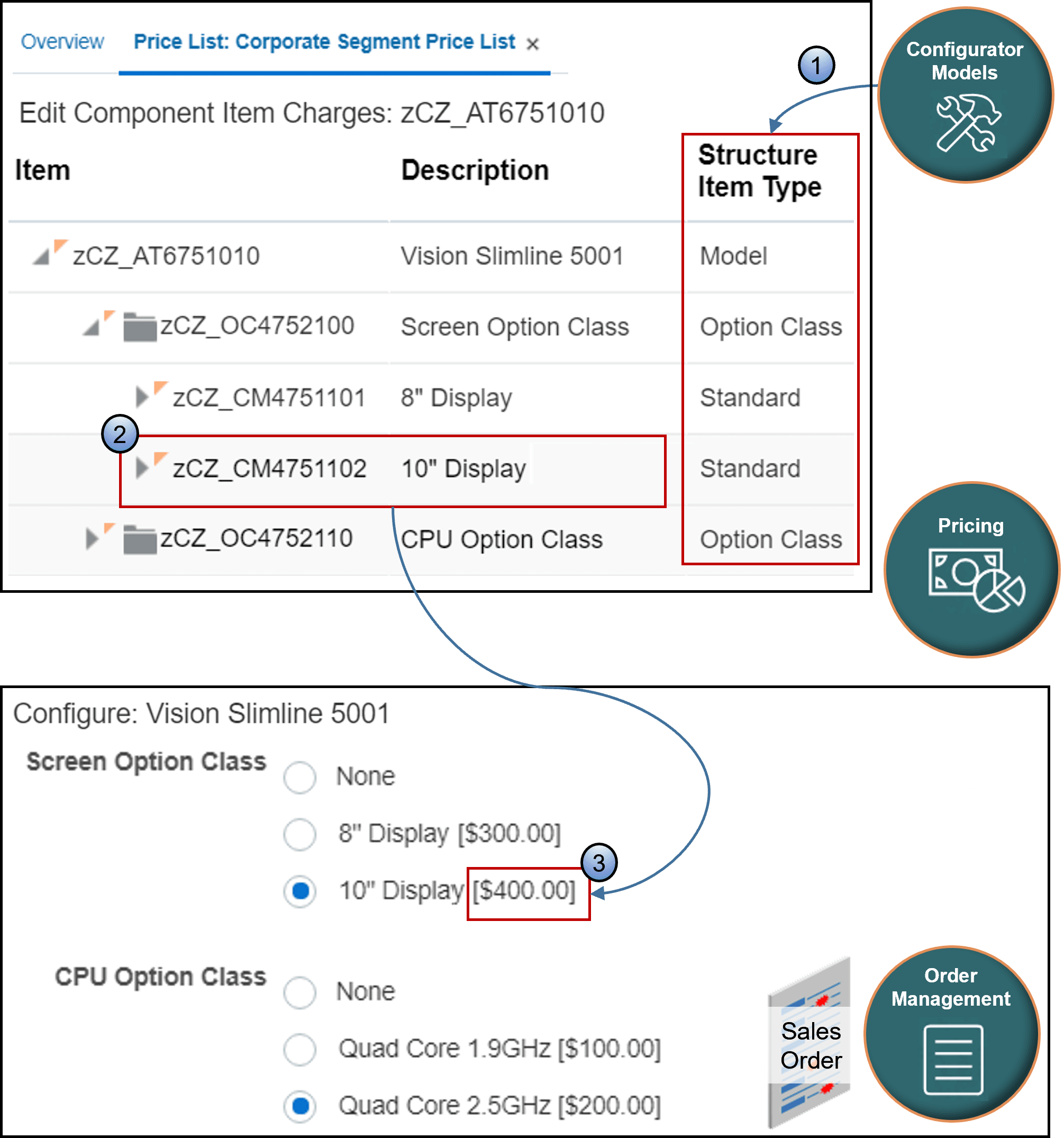

Set Up Pricing for Configuration Models
Set up pricing for a configuration model in a price list or discount list.
Here's an example:
You use the:
  1. Configurator Models work area to set up the model for the zCZ_AT6751010 Vision Slimline 5001 item, including the hierarchy, option classes, and configurable options for each class.
  2. Pricing Administration work area to you add the item to the Corporate Segment Price List, then use the Edit Component Item Charges page to create a charge for each option. For example, you create a $400 Base Price charge for the 10" display.
  3. Order Management work area to search for the zCZ_AT6751010 on the order line, click the structure icon, and then select the options. The page displays the charge that you created for each option, such as $400 for the 10" display.

  6. On the Edit Component Item Charges page, in the Item Structure Details area, expand the list, then notice the hierarchy displays for the parent zCZ_AT6751010 Vision Slimline 5001 and its child option classes.
  7. Create the charge for the parent model.
    Click the row that contains Vision Slimline 5001 in the Description column, click Create Charge, then set the values:

  8. Create charges for the Screen Option Class:
    • Expand zCZ_OC4752100, the Screen Option Class, then notice the configurable options that display:
      Item
      Description
      zCZ_CM4751101
      8" Display
      zCZ_CM4751102
      10" Display
      You create a charge only on the configurable option, not the option class.
    • Click the row that contains 8" Display in the Description column, click Create Charge, then set the values:

    • In the Item Structure Details list, in the 8" Display row, notice the Charge column displays a check mark.
      The check mark indicates you created a charge for the item.

  11. Verify your set up:
    • Sign out of Oracle Pricing, then sign into Oracle Applications with the privileges that you need to manage sales orders.
    • Go to the Order Management work area.
      Create a sales order, search for the zCZ_AT6751010 Vision Slimline 5001 item on the order line, click the structure icon, then verify that the page displays the charges that you set up for each configurable option.
