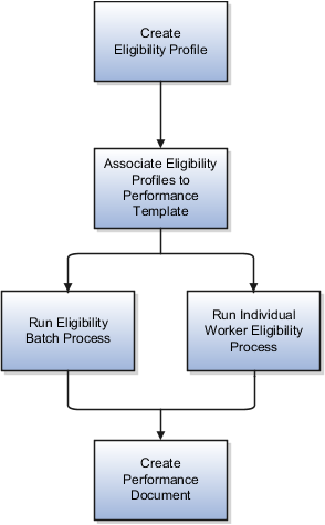

This figure shows the steps required to set up and use eligibility profiles for performance documents.
Creating Eligibility Profiles
You create eligibility profiles to match the business requirements for your performance evaluation business process. For example, you can create eligibility profiles to evaluate workers in a specific department, job, location, or other criteria. You can also combine criteria. For example, you can create a performance document to evaluate every person in the Sales department who's a manager level 3 and located in California. You can either create one eligibility profile with those three criteria, or create three separate profiles with each criterion. You create eligibility profiles using the Eligibility Profiles task in the Setup Maintenance work area.
When creating an eligibility profile for performance documents, you can select any profile usage. However, because eligibility for a performance document is determined by assignment, you must select Specific assignment as the assignment to use. Specific assignment is automatically selected if you first select Performance as the profile usage. Then, when the eligibility process is run, it evaluates every assignment for a worker to determine which, if any, performance documents the worker is eligible to use for each assignment.
Associating Eligibility Profiles with Performance Templates
You select eligibility profiles to associate with performance templates at the template level and for performance document periods. When you select eligibility profiles, the performance documents made from the template are available only to the workers who meet the criteria.
You can associate eligibility profiles for any profile usage to a performance template. However, only those with the assignment set to Specific assignment are available to associate with performance templates.
Eligibility profiles can either be required, or not required, and can be used in combination so that workers must match some or all criteria.
Running the Eligibility Process
To determine which workers are eligible for performance documents that use eligibility profiles, you must run the eligibility process. You can run a batch process to analyze a large worker population to determine who's eligible for performance documents based on the parameters you enter. To run the batch process, use the Eligibility Batch Process task in the Setup Maintenance work area.
