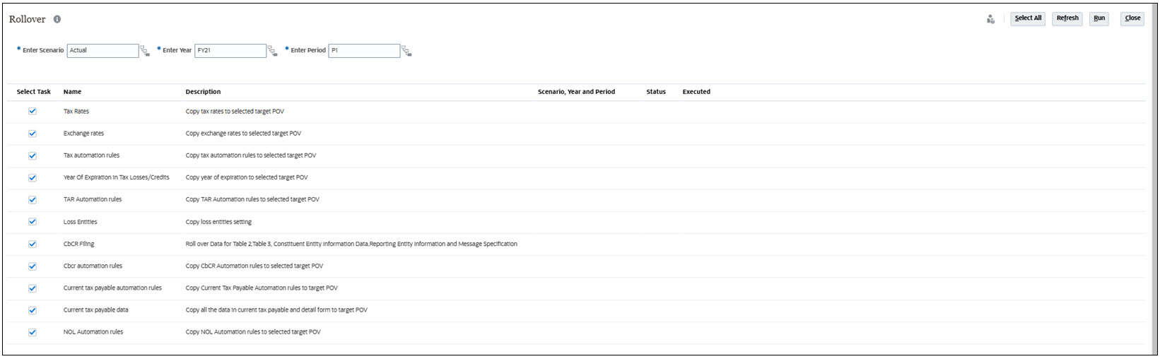

  1. From the Home page, select Application, then Configuration, and then select Rollover.Select the Rollover form on Configuration
  2. On the Rollover screen, select the Target point of of view where configurations will be copied to.
    • Scenario --Select a scenario from the list of scenarios.
    • Year --Select a year from the list.
    • Period --Select a base period from the list of periods. The Target period is the selected period in the POV and the Source is the period prior to it. For example, for FY21 P1, the prior period is FY20 P12.
    Select the POV for the rollover process
  3. Click to select the type of rollover you want to perform:
    • Tax Rates-- Copy tax rates to the selected target POV
    • Exchange Rates-- Copy exchange rates to the selected target POV

    You can click Select All to select all rollover types at one time.
  4. Optional: Review the details for the previous rollover:
    • Scenario, Year and Period - If this is the first time the rollover is being run, this column is blank.
    • Status of the rollover.
    • Date the rollover was executed.
  5. Click Run to perform the selected rollovers. When the rollover is complete, the Status and Executed date and time are displayed.
