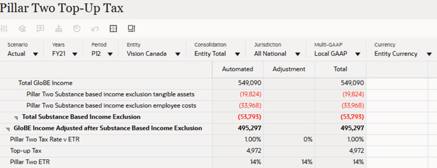

Pillar Two Top-Up Tax
  • Formula for "Pillar Tow Tax rate v ETR" now considers the "TRCS_TopupTaxAllocation" member.
  • The calculation for "TRCS_PillarTwoETRPercent" is expressed as a percentage, rounded to four decimal places, in alignment with paragraph 3 of Article 5.1.1 of the OECD Consolidated Commentary to the Global Anti-Base Erosion Model Rules.
  • The calculation for "TRCS_TotalGloBEIncomeAsAdjusted" meets the requirements for updated calculation "TRCS_PillarTwoETRPercent".
  • Aggregation to the parent "TRCS_TopupTax" reflects changes made to both "TRCS_TopupTaxAllocation" and "TRCS_TotalGloBEIncomeAsAdjusted" calculations to meet requirements with section 5. of the OECD Model Rules (Pillar Two).
