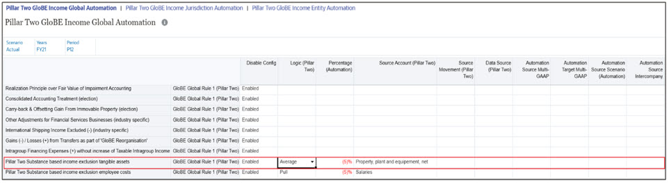

      • Average: For Substance Based Income (SBIE) accounts, an additional pillar two logic "Average" is available in Pillar Two GloBE Income Automation. It calculates the average of the current year and the prior year ending period (P12) values.
        For example, if there is a value of Tangible Assets for Prior year (that is, FY23 / P12) = 3000 and for current year (that is, FY24 / P12) = 5000, then SBIE average = (3000+5000) /2 = 4000.
        Based on "Percentage (Automation)" carve-out available for such accounts, that is, after average was calculated, the relevant amount should be multiplied with the percent entered in "Percentage (Automation)", carve-out, that is, after calculating the average value (4000 * - 5% = -200)
        The example below shows a SBIE tangible assets account with Average logic. Average Logic
      The Average logic is available in all Pillar Two automation forms such as GloBE Income/Covered Tax/Other Accounts and Safe Harbors automation forms.
