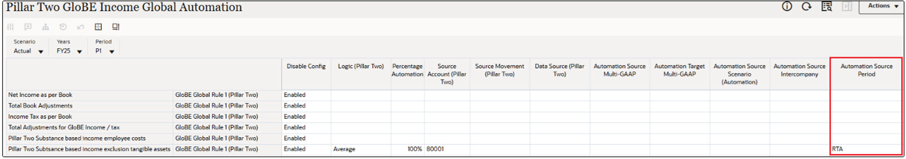

      The example below shows a SBIE tangible assets account with Average logic.
      Average Logic

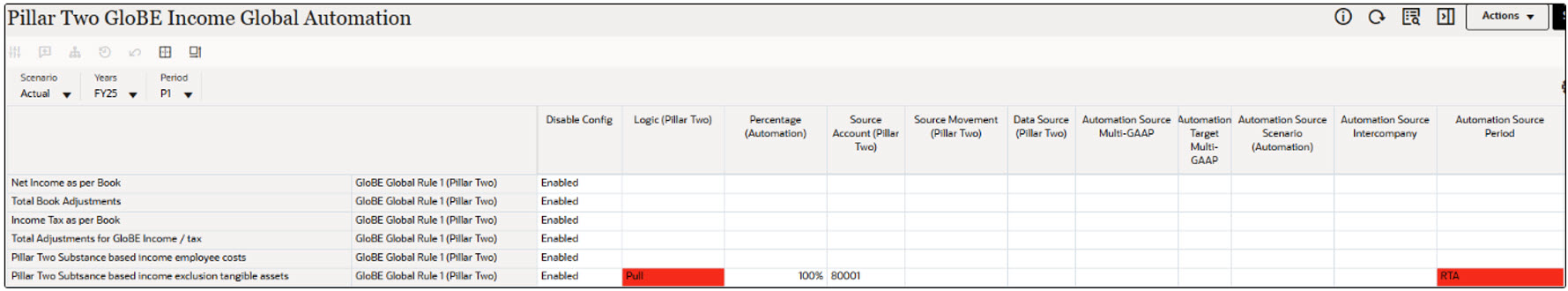

      If you have configured Automation Source Period, you can select the source period for Average logic calculations instead of defaulting to P12 of the prior year.
      Note that the column Automation Source Period is added in all the Pillar Two GloBE Automation forms and is applicable for Average rules only.
      Automation Source Period Column Added
      Use Case Calculation Example
      Consider the following values of Tangible Assets:
      • (Prior Year) FY24, P12 = 3000
      • (Prior Year) FY24, RTA = 4000
      • (Current Year) FY25, P1 = 2000
      SBIE average when RTA is selected as automation source period :- ((FY24, RTA) + (FY25, P1))/2 = (4000+2000)/2 = 3000
      SBIE average when automation source period is left blank (P12 is used) :- ((FY24, P12) + (FY25, P1))/2 = (3000+2000)/2 = 2500
      Form save fails if you use Automation Source Period for Pull logic.
      Failed Form Save
