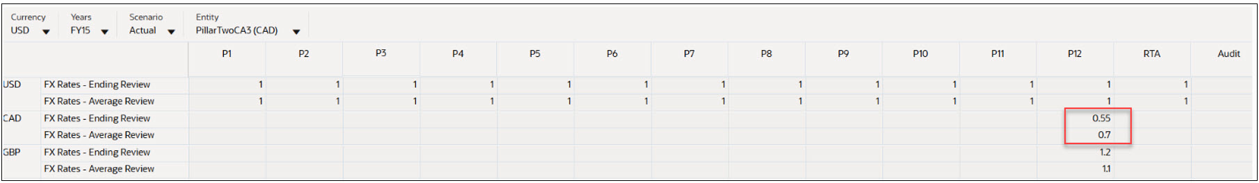

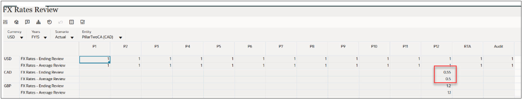

  • FX Rates PillarTwoCA
    PillarTwoCA FX rates are 0.55 (Ending Rate) and 0.5 (Average Rate).
  • FX Rates PillarTwoCA3
    PillarTwoCA3 FX rates are 0.55 (Ending Rate) and 0.7 (Average Rate).
    PillarTwoCA3 has a FX rate of .7 (overridden) instead of .5.

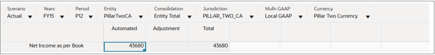

  • Child Entity PillarTwoCA PillarTwo Currency

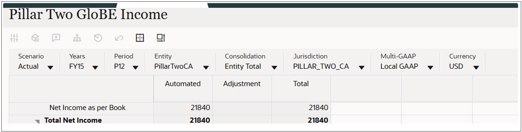

    Child 1 entity PillarTwoCA PillarTwo entity currency is 43,680.
  • Child Entity PillarTwoCA USD Reporting
    Translated (USD) value is 21840 (43,680*.5=21840)

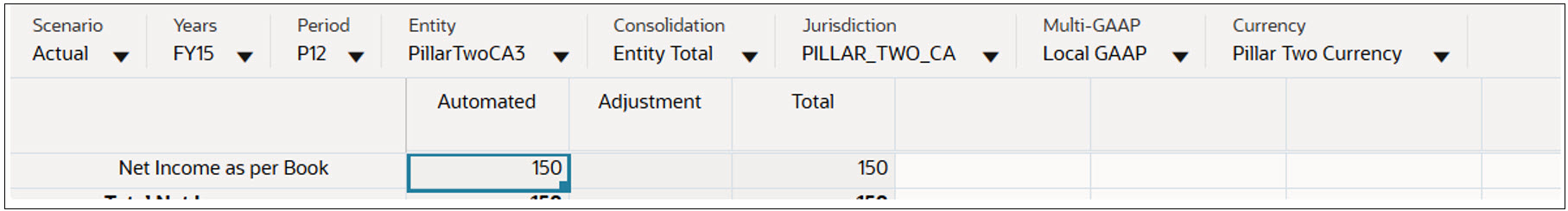

  • Child Entity PillarTwoCA3 Pillar Two Currency
    Entity PillarTwoCA3 PillarTwo currency is 150.

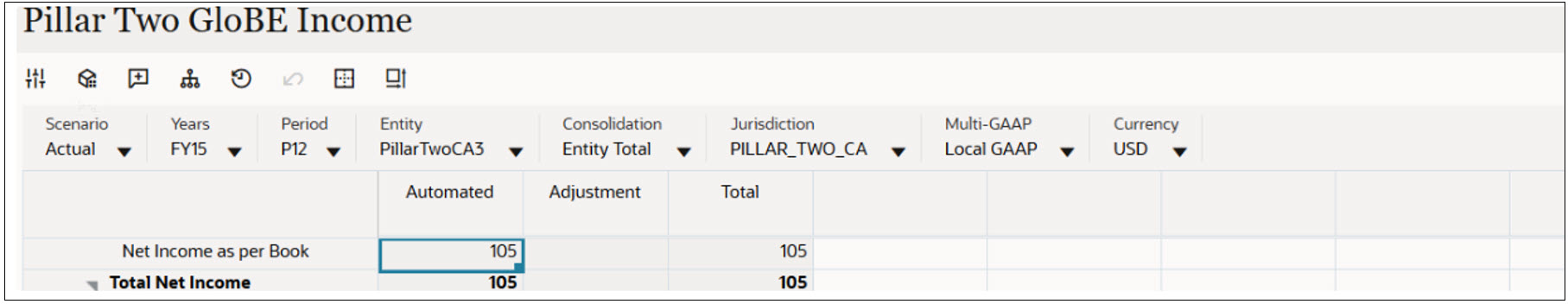

  • Child Entity PillarTwoCA3 USD Reporting
    Translated (USD) value is 105 (150*.5=105).

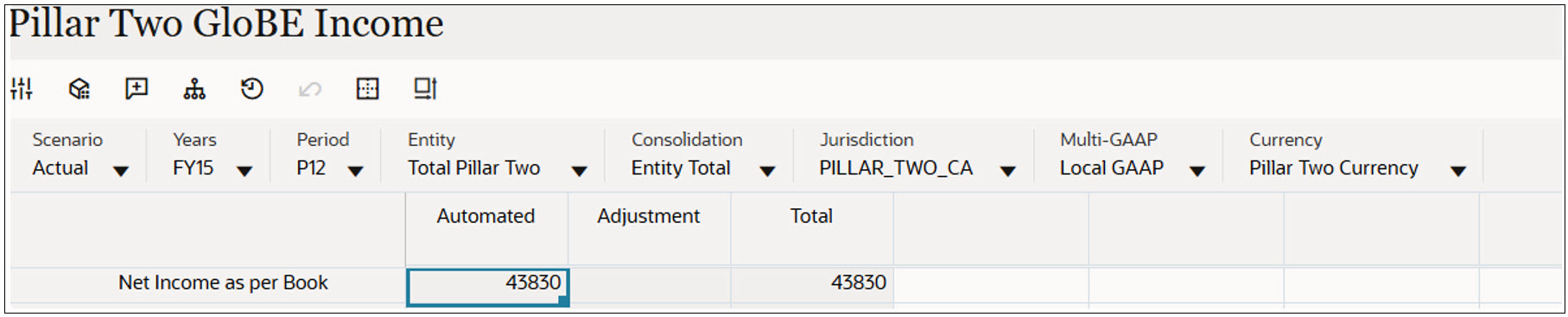

  • Parent Entity Total Pillar Two Currency
    Parent Entity Total Pillar Two Pillar Two Currency
    Total Pillar Two currency is 43830.

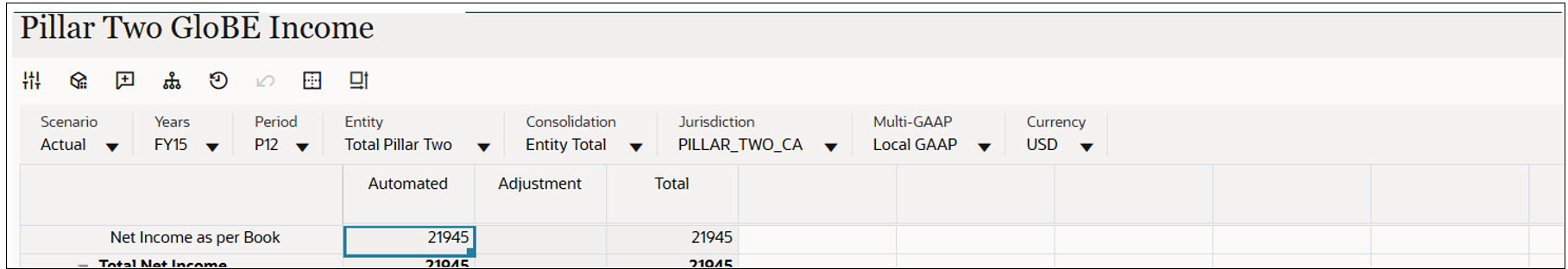

  • Parent Entity Total Pillar Two USD Reporting
    Child contributions translated to USD:
    • PillarTwoCA → USD = 21840
    • PillarTwoCA3 → USD = 105
    Parent USD = Sum of the children->contribution→USD =21840 + 105 = 21945
    This ensures parent totals reflect child-level rate differences even when parent translation is not directly derived from entity-level translation.
